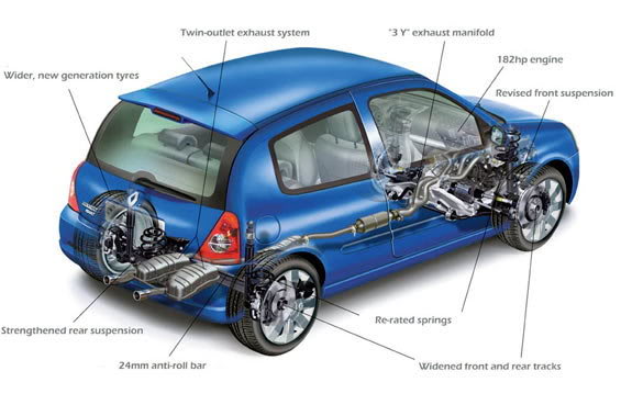

172/182 Anti Roll Bar
The 182 has a bigger anti roll bar (24mm)
What size is the 172FF ones ?
And what would an anti roll bar of a bigger diameter do ?
Would it Stiffen up the handling a bit?
  172
-172 has a 22mm one
-stiffens the back end meaning less understeer
-back end becomes more nervous, on a standard 172 could mean lots of oversteer

I think there's more to it than a slightly thicker ARB why the 182 handles better than the 172 imo . I think the wider track and wider , better ( exaltos ) tyres have a fair bit to play in why it handles better .
Ah ok, would the extra 5mm on the hubs and wider tyres honestly make a diff ?
