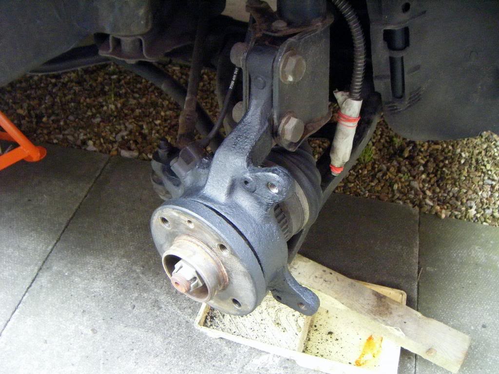

Am I getting this right? When you turn right, the right wheel is scrubbing on the bit of the arch between engine bay and wheel so in the pic of the front right arch below, it would be rubbing around the top-left side of the pic.
If that's the case, I would have though spacers would help. Can you see scrubbing on the front tyres anywhere?
