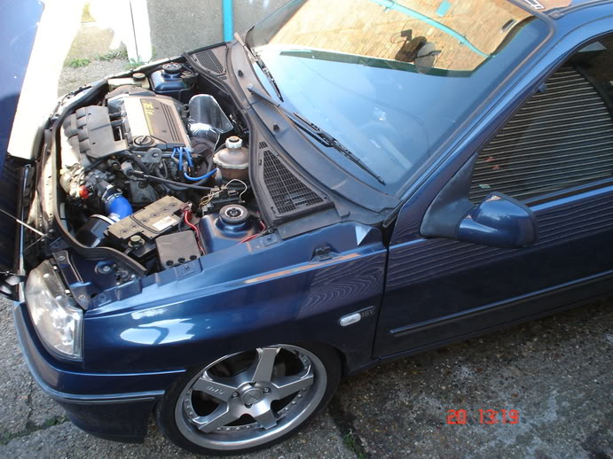

i've got some spare cash from the sale of my focus.
body work and everything else is mint on my clio.
so £4700 on performance.
whats the best plan of action ? :eek:

have a word with nick hill( hillpower ) just got mine back and im very impressed. could do the above conversion for u but u will need more ££££ if u wanted tb with that. will b best to 2.0l it and work on that.<f7r
  1996 Valver
Spend some £ on suspention/brakes chassie and cooling, get that propper mint then see what your left with, If enough if left id go wiv 'Jay s' and have the williams lump put in with cam's+ chip, that would make it mint

if your just puttin abit in2 it then 4get TB's and drop an F7R with cams uprated ECU and a remap , that will sort u out!
yup as the majority say, 2.0 bottom end and head, then get cams and remap (not a shitty off the shelf chip though!!!). bottom end and fitting should cost you about £700-800 for the engine and labour, with a head gasket and bolt set change, then as for cams, well, that depends on how much you want to spend... don't get Kents though, I recommend BenR AWT cams personally... you certainly wont have a problem with 90% of the MK2's and no standard clio will touch you

200/ton is easy achieved from a 2.0! decent coilovers, wilwoods, some nice wheels, and you'll be laughing!
great fun!
or you could spend the money on a 172 and be bored in a week ;) or you could buy something else for the money but it wouldnt be as good fun as a 200/ton valver IMO!
wouldn't bother with head work and TB's on the 1.8... no point, may as well do all that to the 2.0 as it's a much better base for the conversion

fully restored f7r by nick hill is around £3k inc the eng, think 'tom 20v' has 1in his.
as for ins, i can,t tell the diff between 1.8 and 2.0l just by looking can u;)
single step modification, 2ltr with a mild camshaft change and some port work = more than you will need for a good while.
