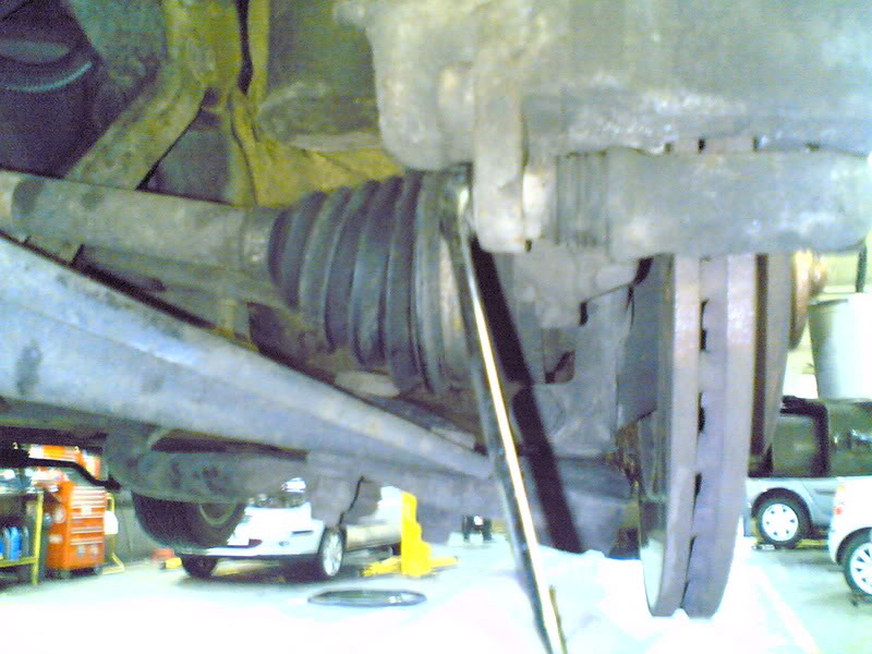

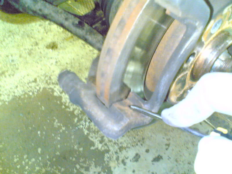

Gavs thread here, the 3rd picture, thats the ball joint, Renault only sell you the arm now, so I'd goto GSF and just get the ball joint, really easy.
http://www.cliosport.net/forum/showthread.php?t=166376
Its on a MK1 but the principles the same.
Simplified...
Soak the lot in penetrating fluid day before
Jacked/axle stands - safety
Wheel off
2 Bottom bolts out (Hold the BJ on the arm - see pic 3)
Nut off the bolt through the BJ - pull/tap the bolt through
Get the balljoint out the hub, get a BJ splitter if necessary
[Haines] Refitting is the reversal of removal [/Haines] :lolup:

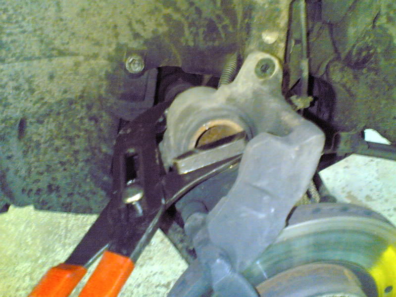

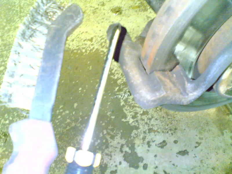

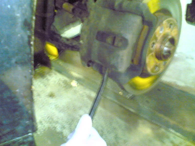

Quick Pads/Pads & Discs Guide - Non-RS Models
Okay this is a quick one for the pads and discs - do a side at a time so you can refer back if you have to.
Wheels off
Remove 13mm Bolt on bottom of caliper
Lift caliper up, slide off carrier
push back piston (keep eye on level under bonnet)
Remove old pads & shims as necessary
Remove 2 X 18mms in the carrier (Bit that holds the pads)
Remove carrier, clean up with wire brush
Beat the 2 X T30/40s holding the discs on with a knockometer, they can be a bit tricky
Remove 2 X T30/40s holding discs on
Remove both discs, again, use the hammer, gently not to damage the hub
New discs on, you should get new T30/40s
Bolt the carrier back on after you've given them a clean up, make sure 18mms are tight!
New shims in the carriers
Copper grease the pads where they sit in the shims
Refit & lower the caliper
Re-tighten the 13mm bolts both sides
Pump the brake pedal out
Refit wheels, torque wheels when on the floor
Bed in new pads & discs as nececarry go easy on them for a while
Disclaimer - I wont giveout compensation if you die because you followed this guide. Please see your local Renault dealer for advice... rarararar
