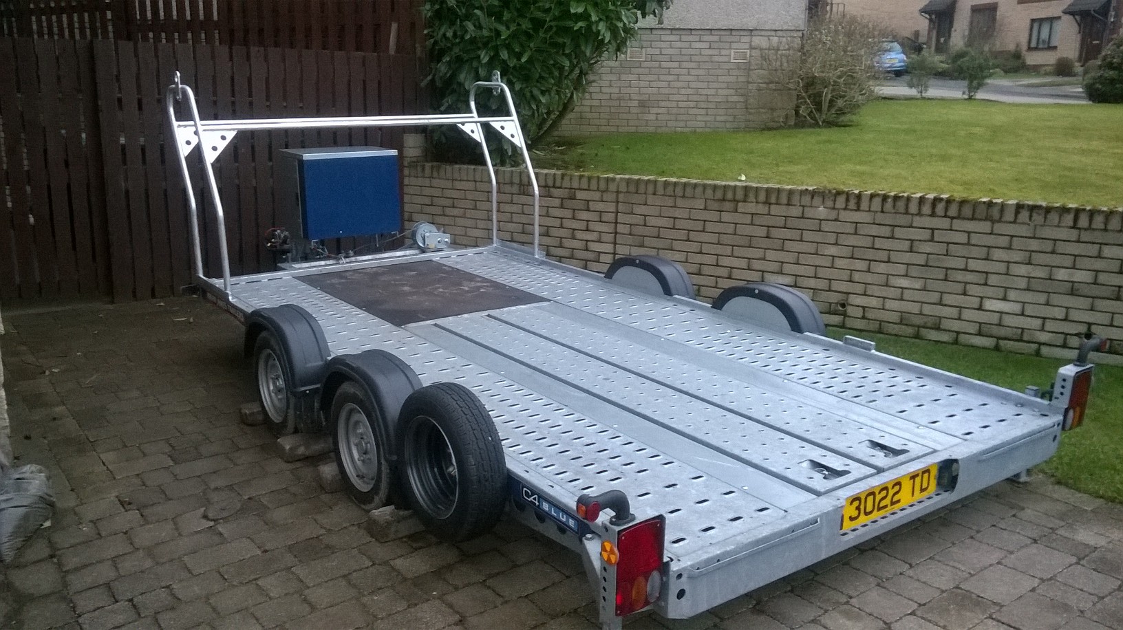

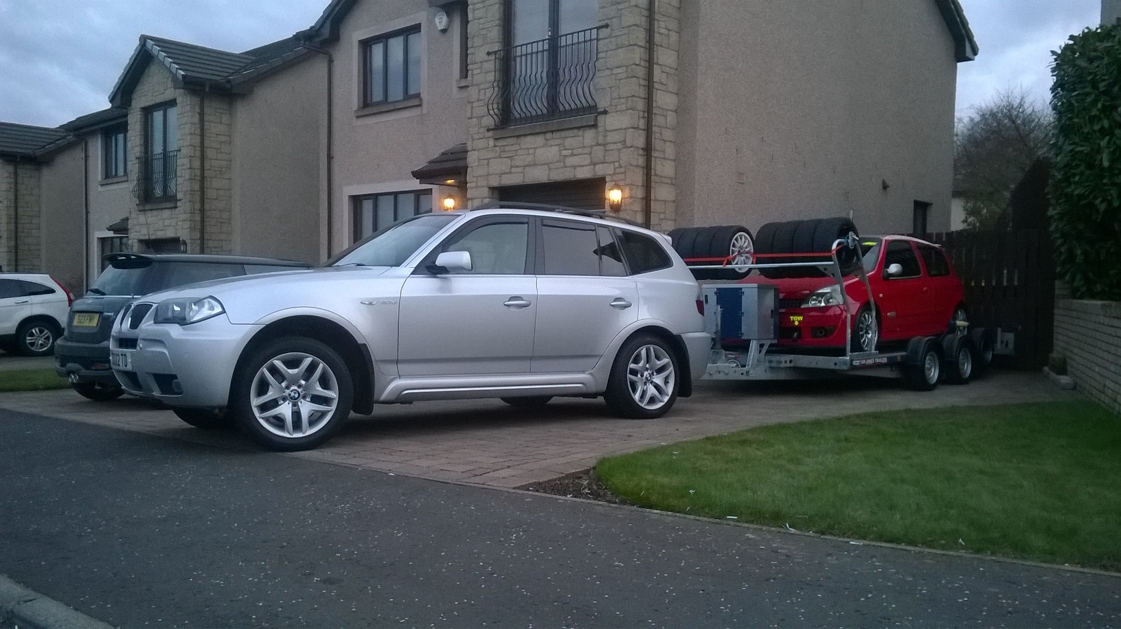

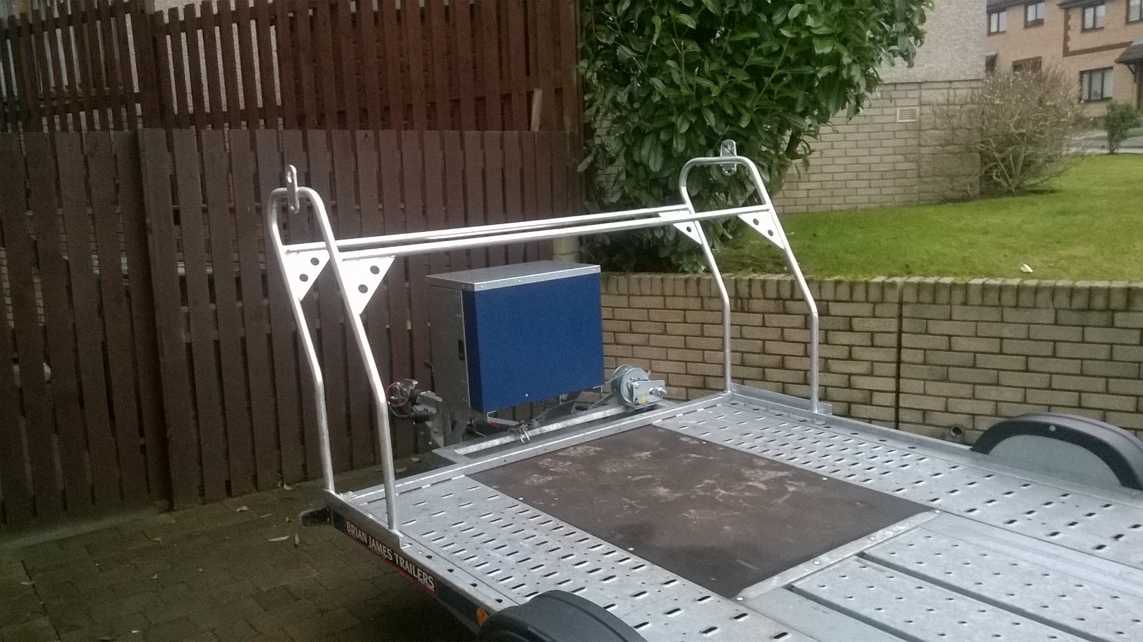

:relieved: I think I remember someone telling me this was a cheap hobby!!!...................... no more car mods just now since @Andy93 beat me to it, so decided to upgrade the trailer to free up space in the tow car! bit of a boring post, but its this months progress none the less!

@cpaterson76 would you consider renting that trailer of yours if needed :up:
Hi mate, due to bad experiences in the past I wouldn't, don't mean to offend in anyway, but if its things that need moved etc. I could do reasonable rates on tow car, driver and trailer..........

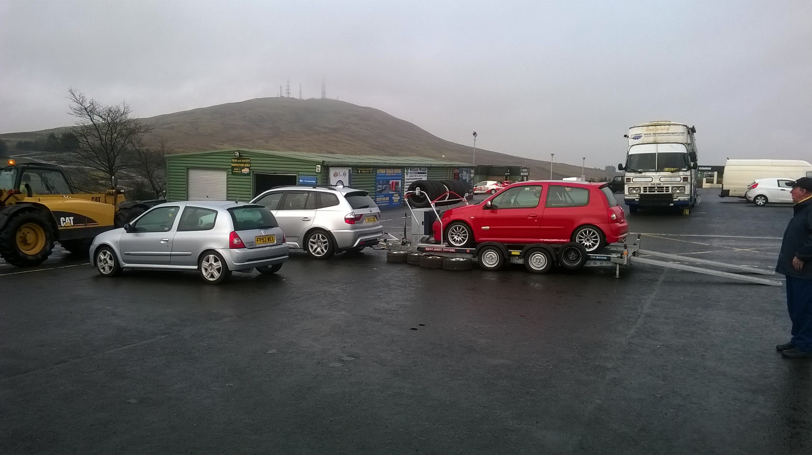

3rd April and the first track day of the year..... everything loaded up last night, weathers been great all day, there's a hope that the sun may stay for Friday, but the weather forecast thinks not!
Get to Knockhill reasonably early, the rain stopped as we arrived but that was as good as its got for the morning. Heavens opened and spirits were dampened a little, but a few laps in and despite the weather the smiles were on everyone's faces!! A lot of friendly banter going and as the paddock filled it was good to catch up with a few familiar faces!

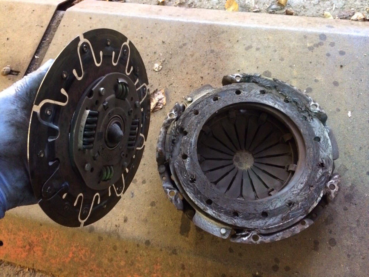

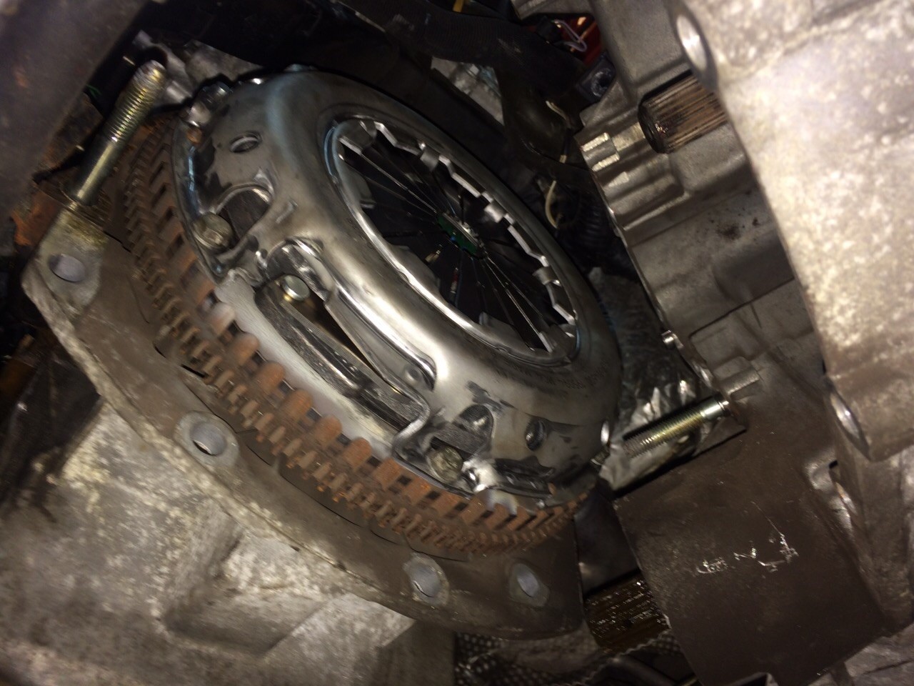

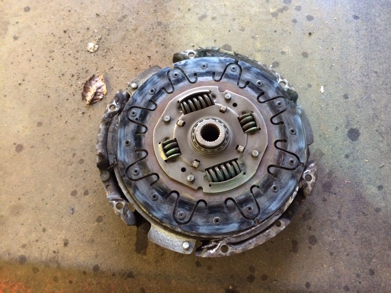

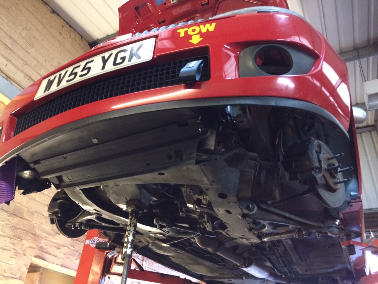

Now the keen eyed of you shall notice the theme in the photo's above, red Clio on a trailer and that theme continued by 11:00am!!!!! An hour in and my first track day of the year jinx hit again, last year lead 3 goes cutting it short after 16 laps, this year the f@ck*ng clutch goes after 20!! Never mind, at least my cousin was there with his new track toy , the silver 172 above, and even in standard form, in the wet, we had massive fun all day! Apologies there aren't any more photos of the day, but i didn't feel the need to take a 3rd picture of the Clio sitting on the trailer lol! Big thanks to @Fraser.J. for his suggestion of stripping and fitting a new clutch in the paddock, but as the rain was pouring at that point, and i was somewhat p*ssed off, I wasn't really in the mood for it.

Anyway time to start pulling the car to bits now and start repairing / modifying again! i'll update more as it happens:confused:

Cheers Craig, was good meeting you! The evening went well, got the times down to nearly 1:07 before I had to call it a night after the brakes were sparking pretty bad in most corners. Shame your clutch went so early in the day. Fraser had the right idea though lol, if only it had been nicer weather.

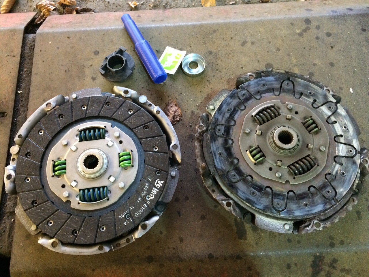

Tonight's update kinda falls into that boring but possibly satisfying category................ the Trophy moves again! but you still feel a little robbed at spending cash for something you cant see! clutch fitted and all feels great, especially with the box oil changed as well............ :smile: Spent a little time deliberating over the best clutch for the job and ended up going with the Valeo standard one, maybe the wrong choice with the thoughts of engine upgrades looming, but at least I'll know how long I'm going to get out of a standard one!

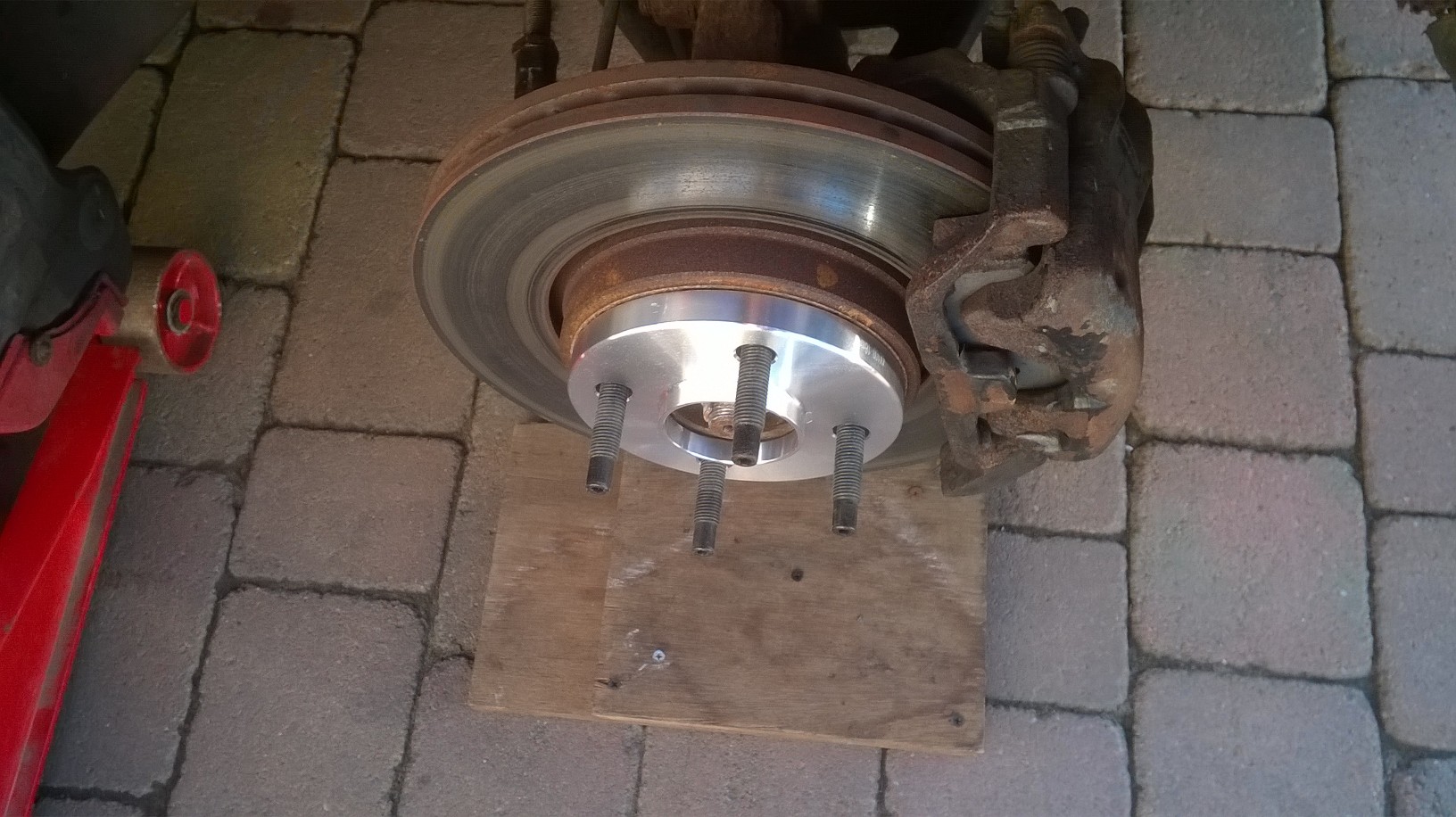

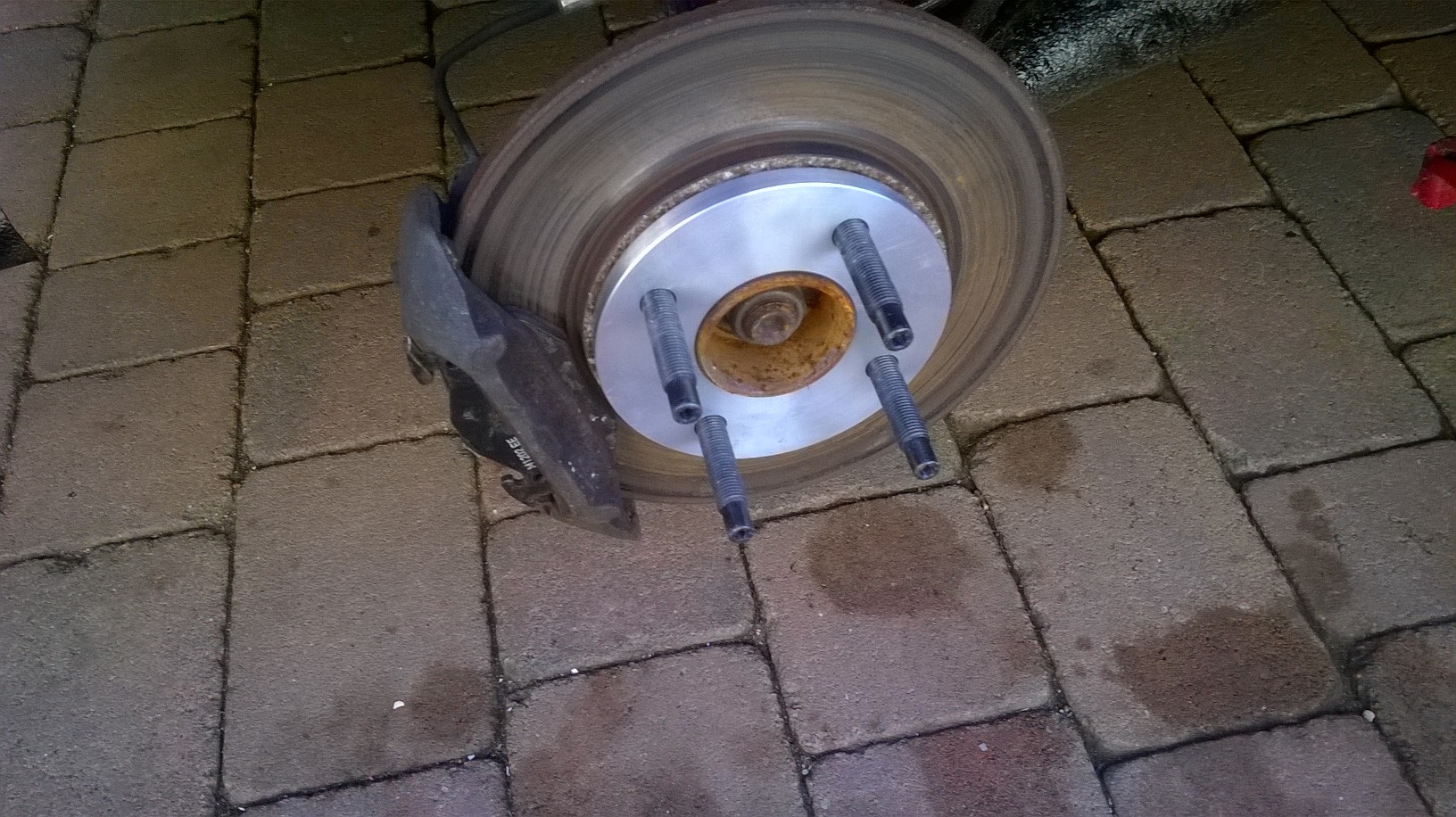

Tonight's update! a few more bits arrived today............... 16mm spacers from JJC & 10mm spacers from MAD. I have 3 sets of TD pro race 1.2's, 2 of them ET 35 and one set ET 43, so trying to balance things out ok. With the camber shims on the rear the 35mm fill the arches ok with no rubbing, so I'll use the 10mm on the front to widen the track a little............. when the ET 43's go on, 10mm spacer on the rear and 16mm on the front, seem to fill the arches well and no rubbing on the rear on the road, but Sunday shall tell on track!
Quite happy with the JJC ones, 60.1 bore and centre lip / spiggot for the wheels to sit on and enlarged holes to fit over the bulb on the stud kit (where it meets the disc), the MAD ones came with the same centre bore but the stud holes were slightly undersized, they fitted over the stud no problem, but when against the disc they couldn't fit over the bulb and the wheels wouldn't tighten, or did but continually as u pulled it over the problem............!! 10 min's and an enlarge of the holes later and problem solved, but not ideal!!
hopefully some benefit to be had on track anyway.......? ran out of light for taking photo's of the wheels on the car, so ill post some at the weekend if I remember :fearscream:
