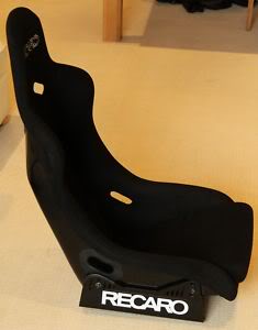

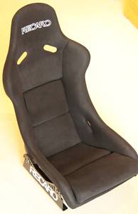

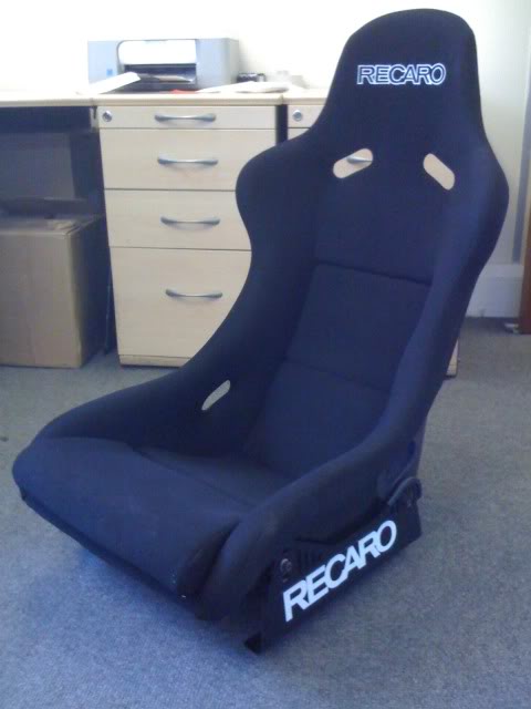

I've won another Recaro seat on eBay today (possibly from a CS member having looked at their other items)
It's not a Pole Position but isn't too bad a match for a passenger seat

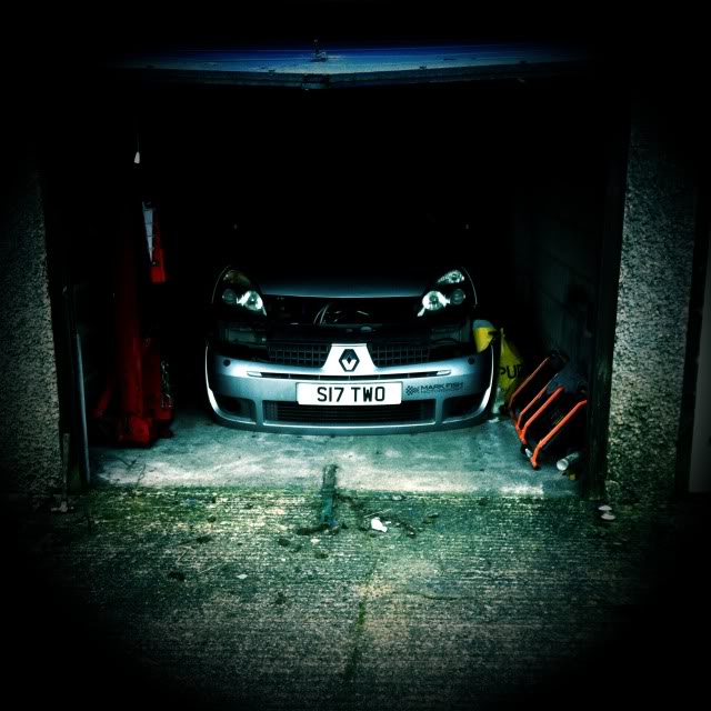

Just before christmas i found a garage to rent and moved the car, so that i could start getting it up and running again.in the new year. For the engine rebuild i'm relying on my brother's help as i wouldn't know where to start on my own.
This weekend is the first chance either of us have had to get going on it, this is how it's been left for the last few months

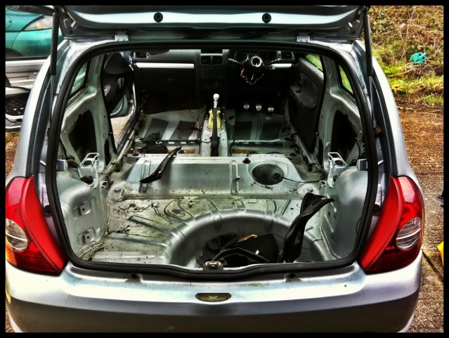

Before i moved it to the garage it had been sat in my brother's mate's yard with all the removed parts chucked in the back for nearly 18 months. So the first job yesterday was to chuck everything out, it's a real mess inside.

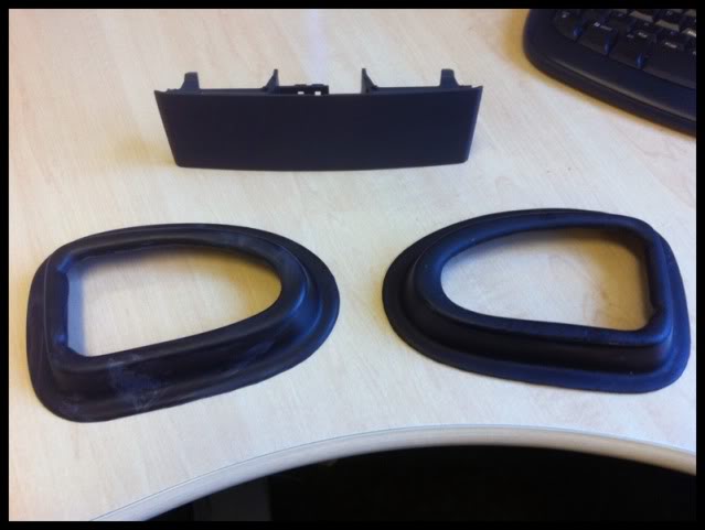

So the first job was to remove the driver's seat, carpets, door cards and steering wheel. That's all that happened on the inside this weekend. I'll be ordering a few bits i need tomorrow and hopefully i'll get the carbon doorcards in and the rest of the tar removed this week.

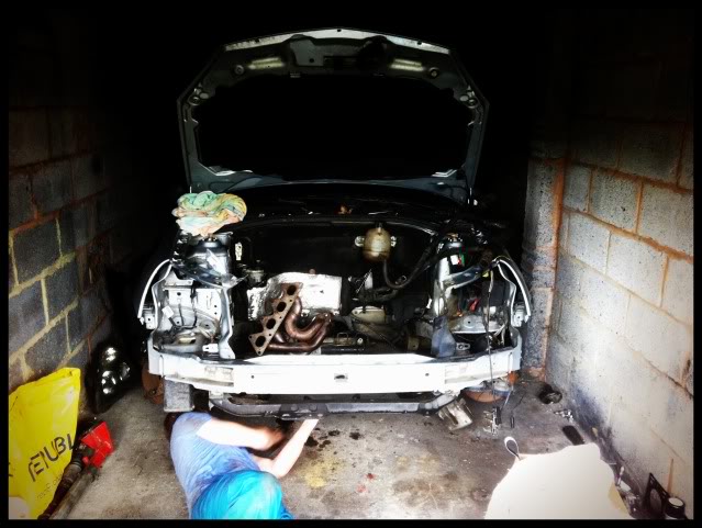

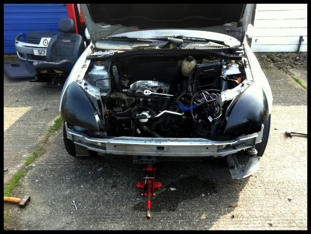

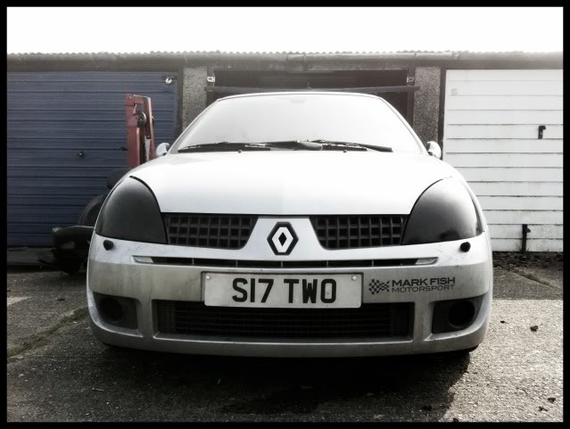

Then today my brother was around so we got the front locking wheel nuts off (brother's mate has lost the key !) and started removing some bits from the engine bay. Got quite a bit done so the next job for the two of us will be to get the engine out.

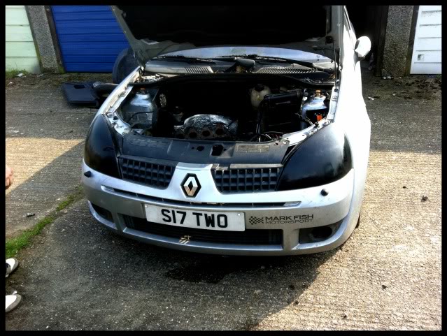

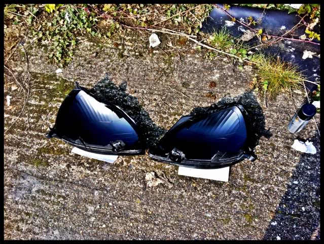

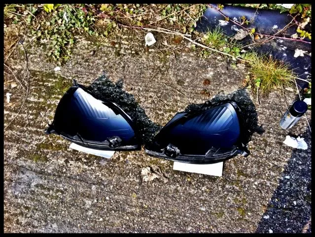

While the wheel nuts were being removed i used chrispy's hammer method on a spare set of headlights to make up some light covers. I then gave them a few coats of satin black paint on the inside.
They came out okay, just need to give the outside of the lense a good polish. I still need to cut out a hole for the cold air feed but i gave them a quick trial on the car.

Love the look of this mate and how its progressed over the years, its good to see that its getting some love again lol :p
Love the headlight blanks, ive been thinking of doing these myself but is it much hassle to get the light units in and out all the time cos id only use them for when on track?
And with the rear tow strap, ive put it through rear bumper trim on my 182, just masked it up and drilled through the strip and the bumper foam etc and fitted it behind there :)

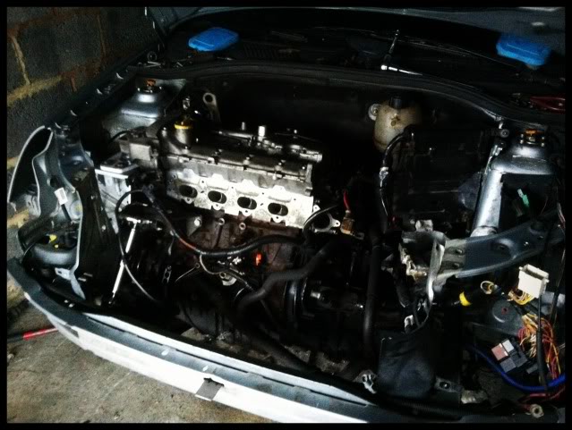

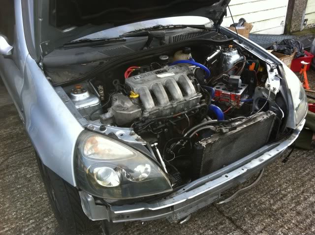

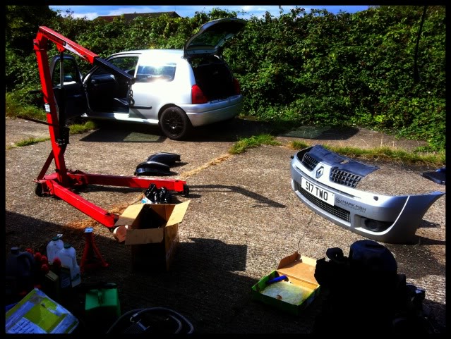

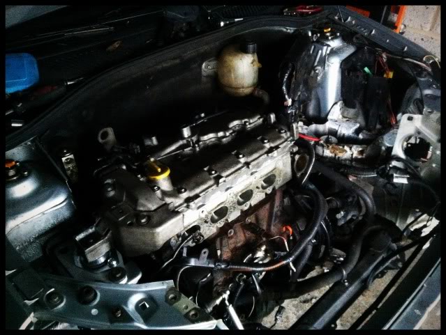

Not made too much progress on this recently, apart from getting the engine out. I've collected all the bits ready to rebuild the bottom end but after getting it apart i've decided it'll be easier (and quicker) to just get another engine and put my head and inlets onto it.
I think i've found a low mileage engine a couple or hours away so hopefully i might have it by the weekend and possibly get it running.

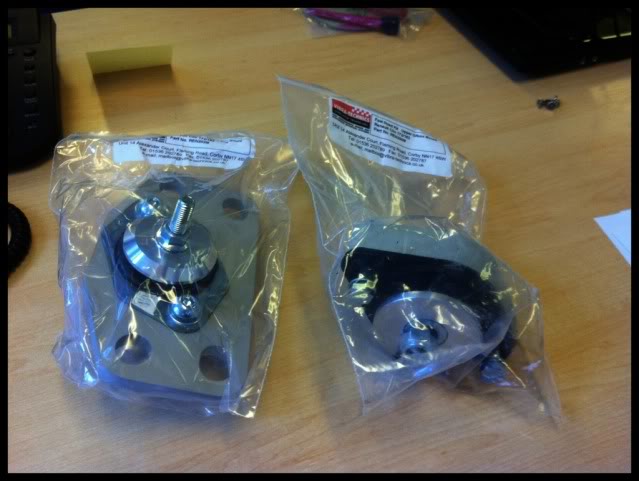

My K-Tec engine mounts turned up today

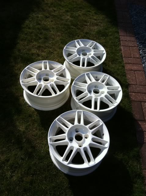

These 15" Speedlines arrived today though
They were advertised as just "Speedline Competition wheels" but from looking them up they seem to be Chrono's. They been freshly refurbed in Honda Championship White, i just need to get some decent track tyres to stick on them now

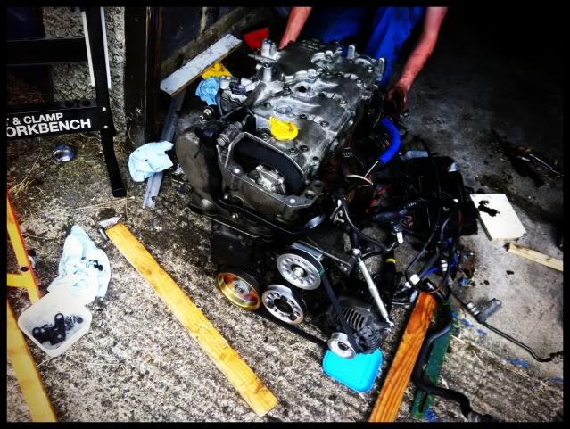

Spent all day yesterday at the garage and made quite a bit of progress
We managed to get the head off the new engine, fitted my head onto it, got the cambelt on and put on most of the PAS removal kit
Going to be a couple of weeks before we can both get back up there again now though

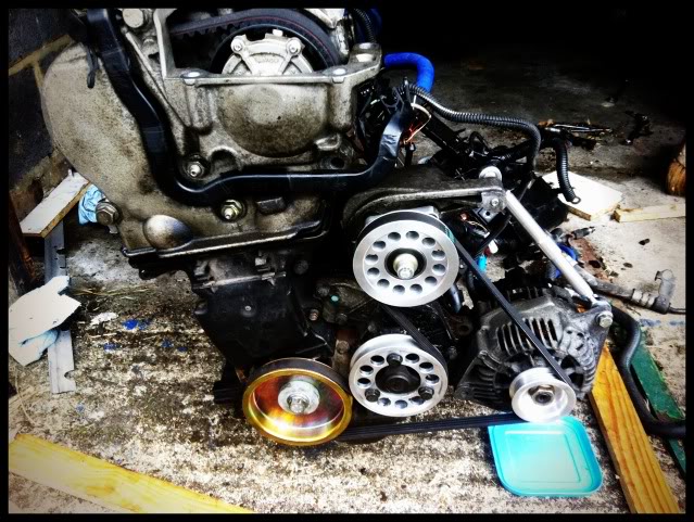

Been very slow progress but never the less some progress has been made. Today we went up to the garage and got a few jobs done so we're almost ready to put the engine back in.
Jobs done :
  • PMS AC and PAS kit fitted
  • New clutch fitted
  • Gearbox fitted
  • DCi steering rack fitted
  • Loom re-attached to engine and gearbox
And a couple of pics
Hopefully we can get back up there this week and get the engine back in and running

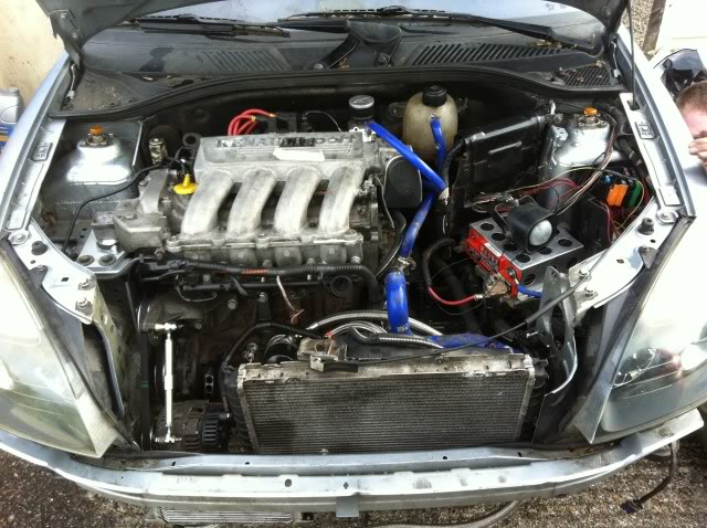

Been up at the garage the last couple of weekends made a fair bit of progress
Managed to get the driveshafts, brakes, wheels, inlets, catch tank, radistor, oil cooler and headlights fitted. So we can get it in and out of the garage easily now, next job is to get the Odyssey battery charged up so next time we're there we can get it running.

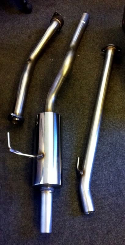

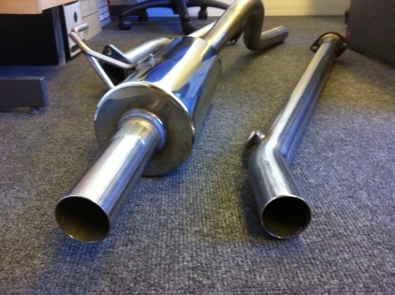

Tried fitting the Milltek exhaust but it wasn't happening, looks like it's for a Ph1 so i need to try to get hold of an exhaust before next weekend now

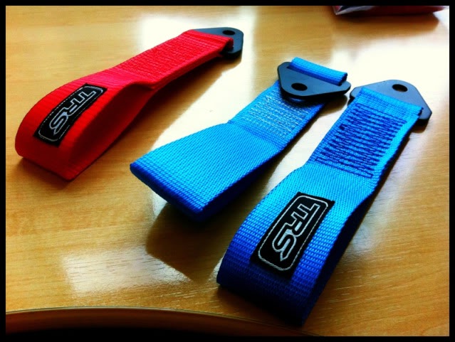

Not a major update, just a list of new bits i've picked up over the last couple of months
  • Alternator (mines on it's way out)
  • TRS 4 Point harnesses
  • Sparco seat runner kit
  • Safety Devices rear cage

I really like the look to those group N systems.
What does or sound like, and how loud are they fella?
Not really had it running yet since i put it on, i'll make a quick vid when i get a chance
It might just be me but it doesn't seem to fit very well, i need to get my brother to take a look now he's back.
I'm wondering if there's two versions of it though, one for Ph1 and one for Ph2 (the decat only has one lambda hole)
Did you get the exhaust from K-Tec?
Yes i did
