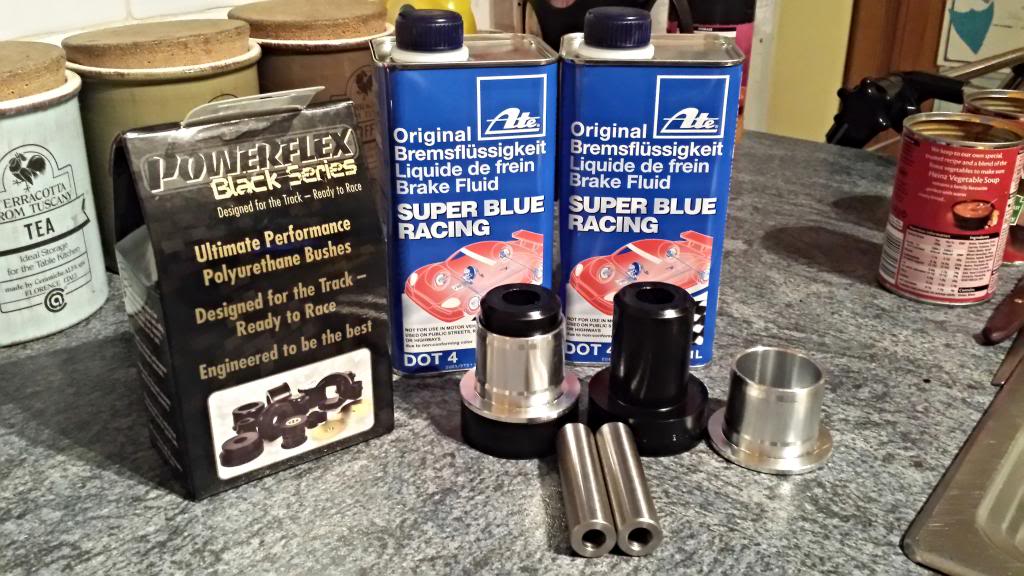

I also went to ECP as my beam bushes where in stock and i grabbed some break fluid while i was there.

http://www.powerflex.co.uk/black-series/product-details/Rear+Beam+Mounting+Bush/11064.html
Powerflex price them as each bush, god knows why. I got mine from Euro car parts but i had to wait about 2 weeks, price wise they cost me £50.96 + vat for the pair. ECP part number is 973740265

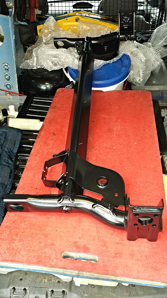

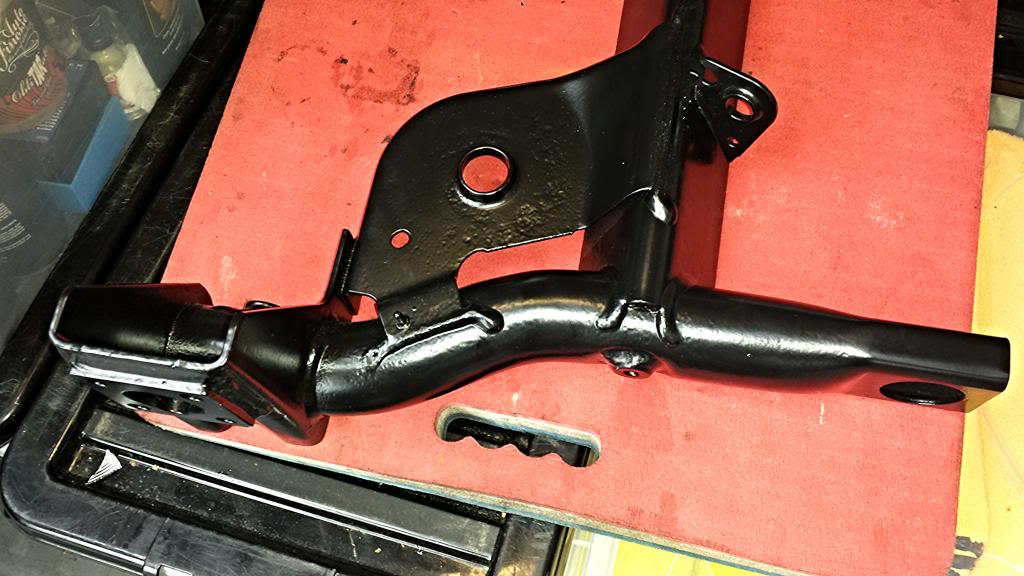

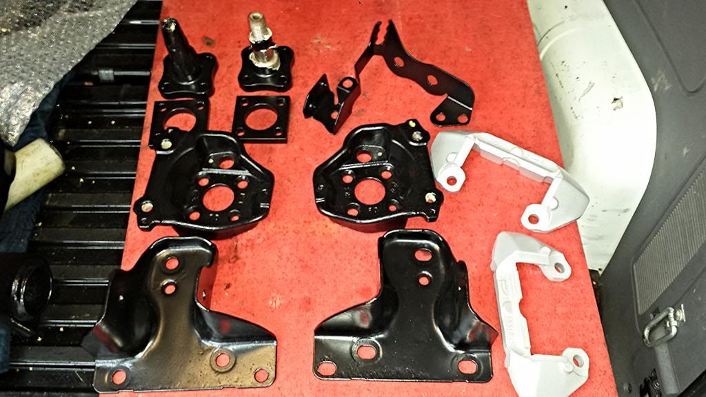

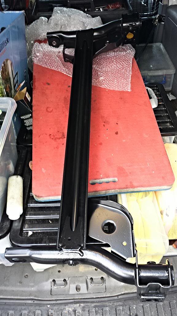

So a little up date, i got a call from the powder coaters on friday afteernoon saying that my bits where ready for collection.
Saturday morning i collected the bits and set about fitting my Powerflex beam bushes.
The pile of bits that i sent away.

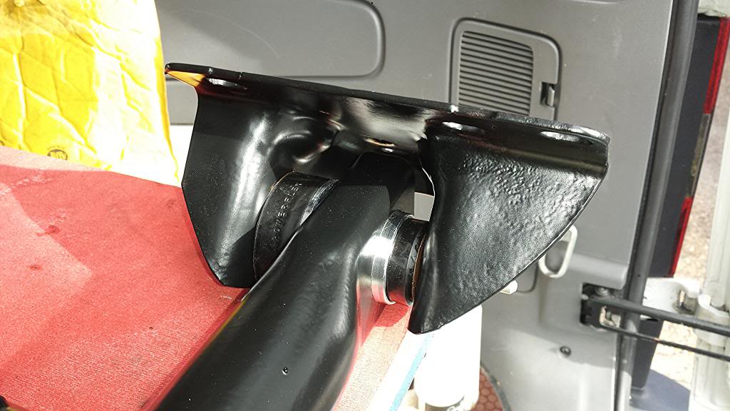

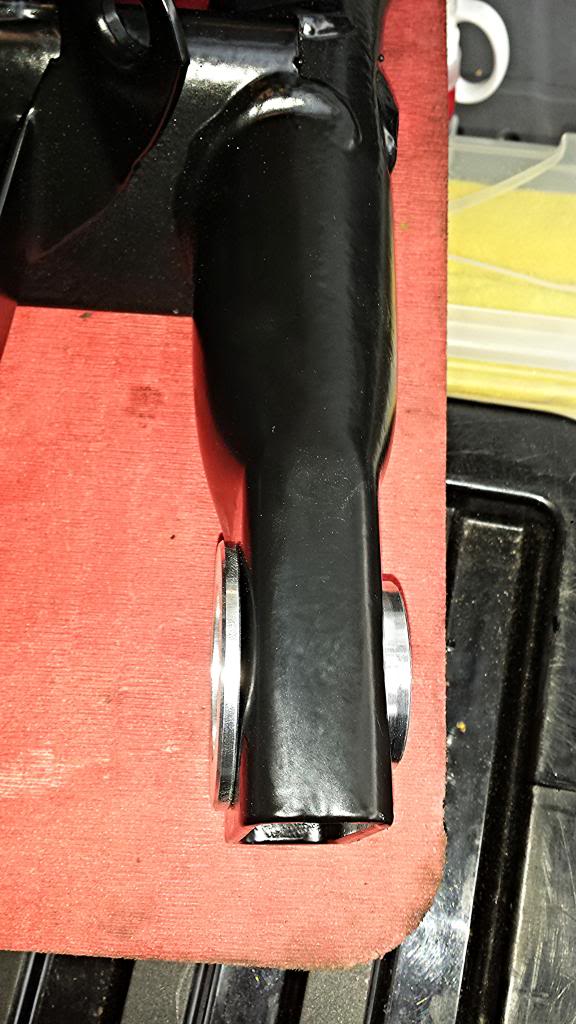

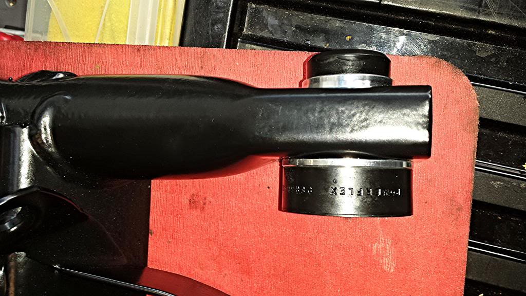

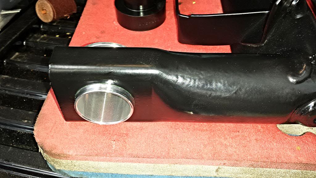

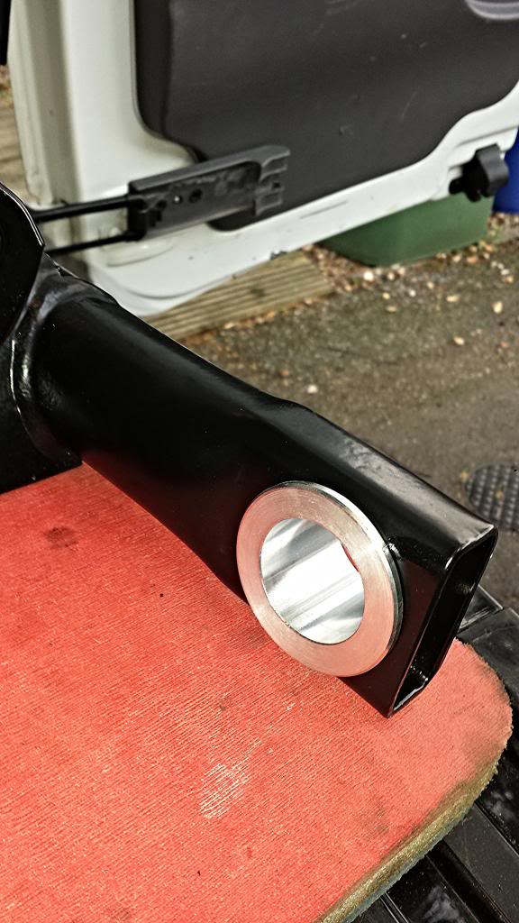

Fitted the bushes but 1st the alloy sleeve has to be pressed into the beam, i cleaned out the powder coating and put some Loctite around the sleeve to hold it into position.

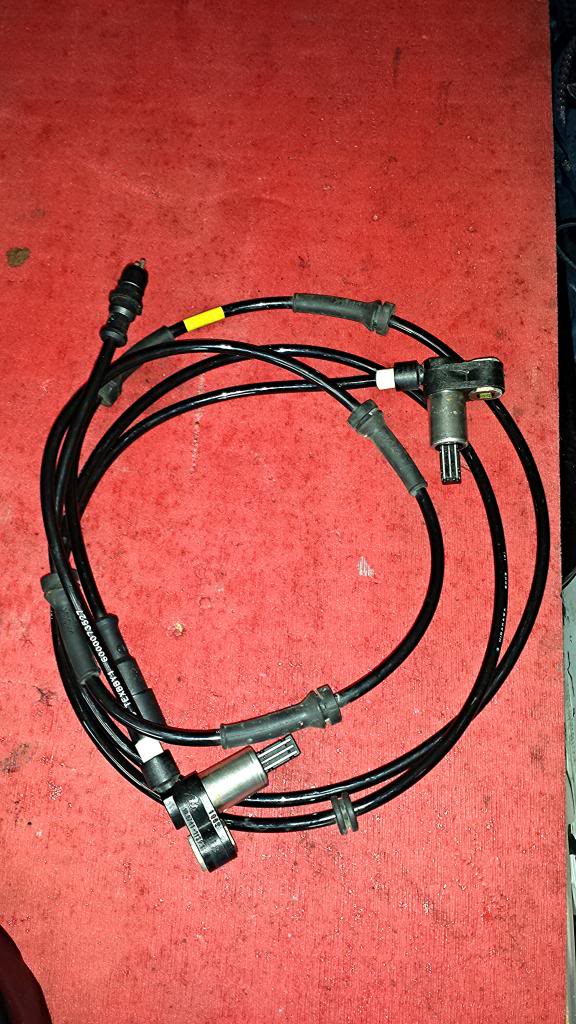

Also i couldnt remove the rear ABS sensors without breaking them so a new pair where bought, OUCH. :(

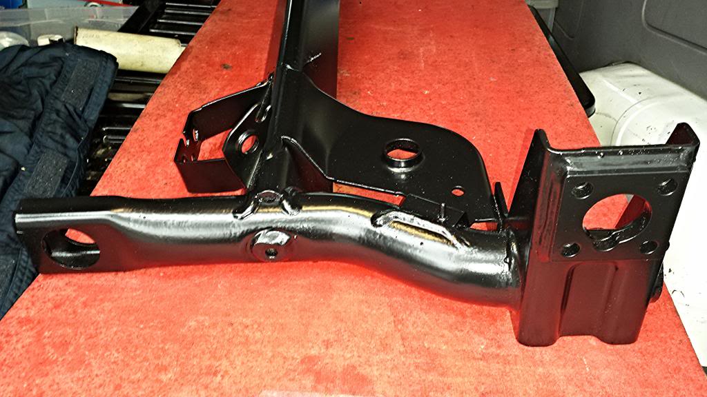

The underside.

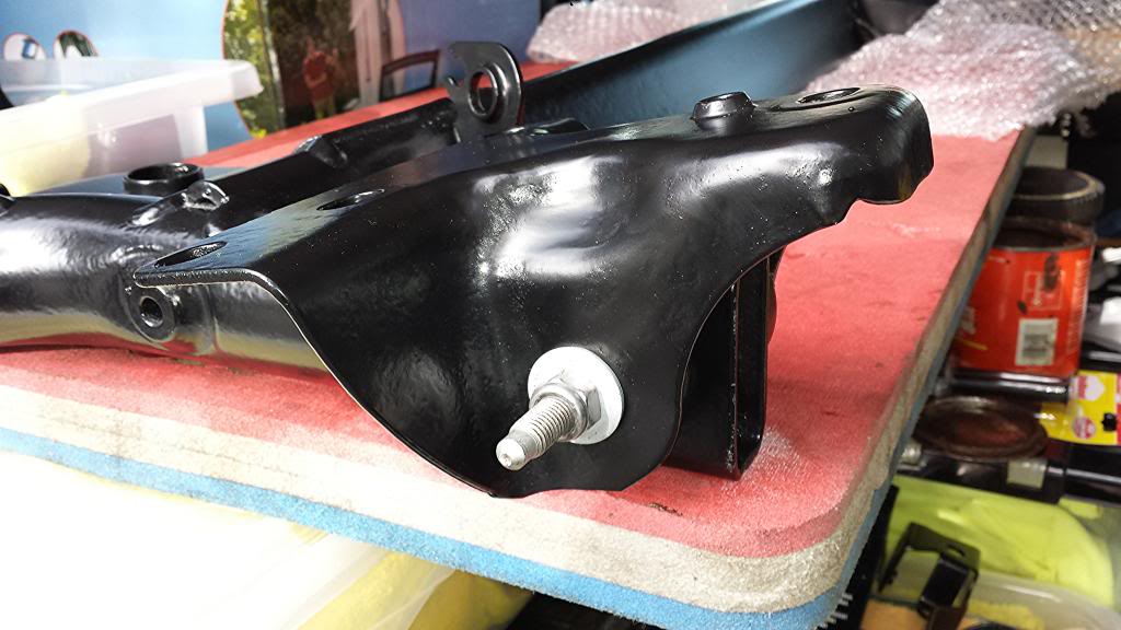

Im over the moon with there work although they had to bits for almost 5 weeks, i will try and get the beam fitted back up tomo and fitted to the car.

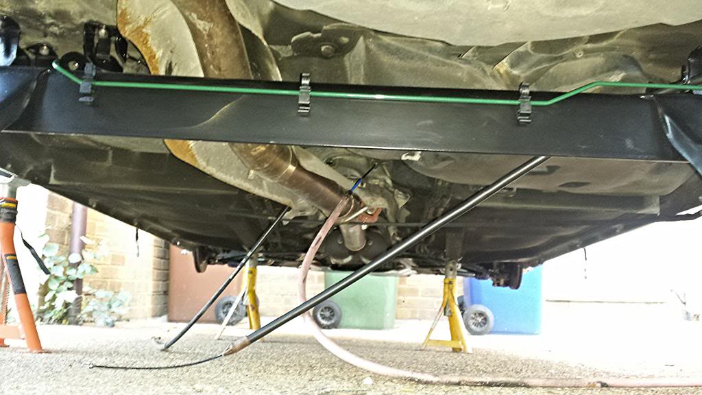

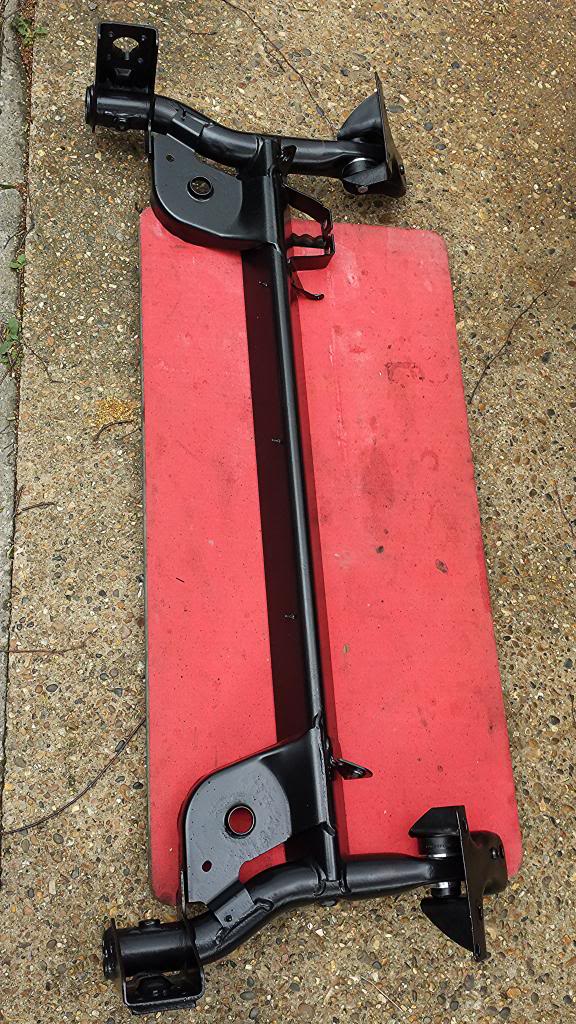

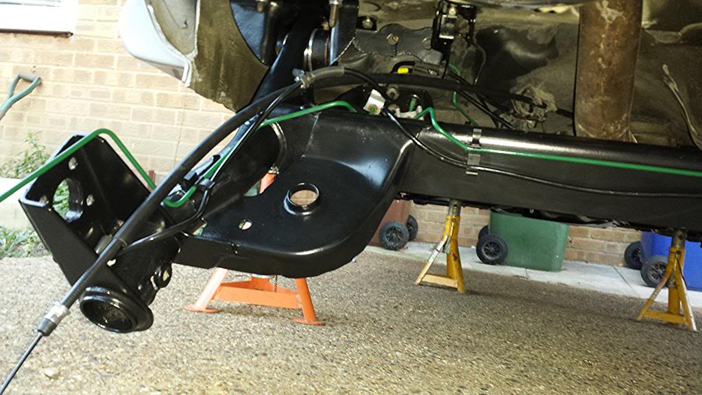

Just a couple of pictures from yesterday, beam is now fitted to the car but theres still a few bits that need to be bolted on.
Ready to be fitted to the car.

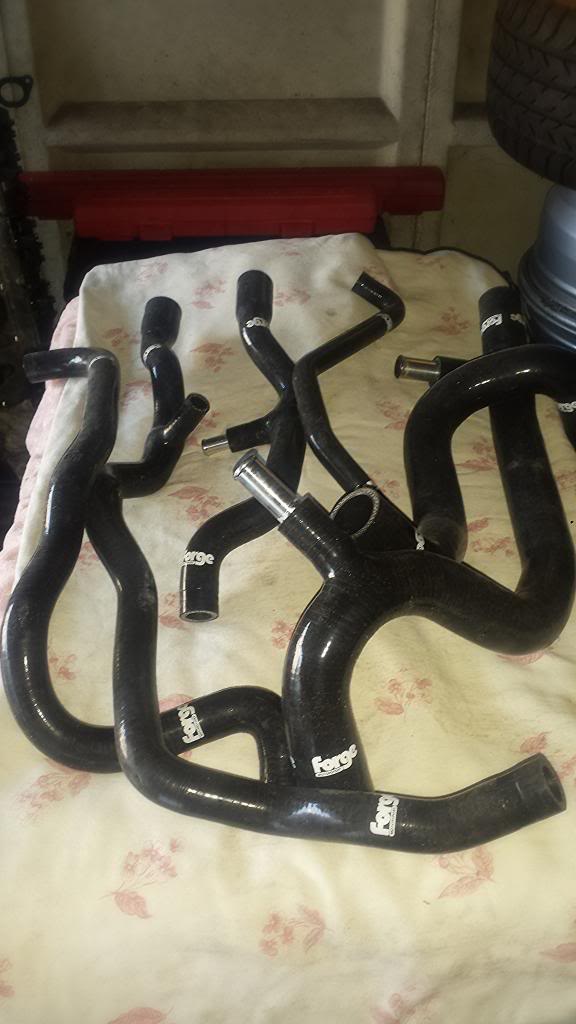

These Forge hoses came up for sale on here and as they had only covered 300 miles i bought them. I dont need then just yet but i will fit them when i do the cams/head work.

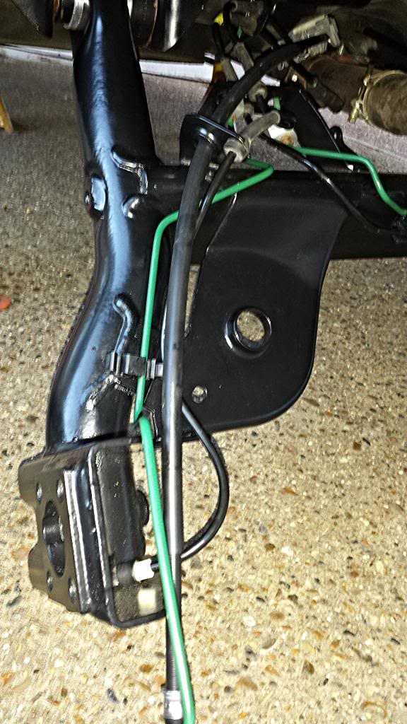

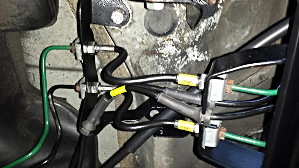

Managed to get the beam fitted today, cleaned up the brake pipes, fitted the new hand brake cables and ABS sensors along with the pipe clips.

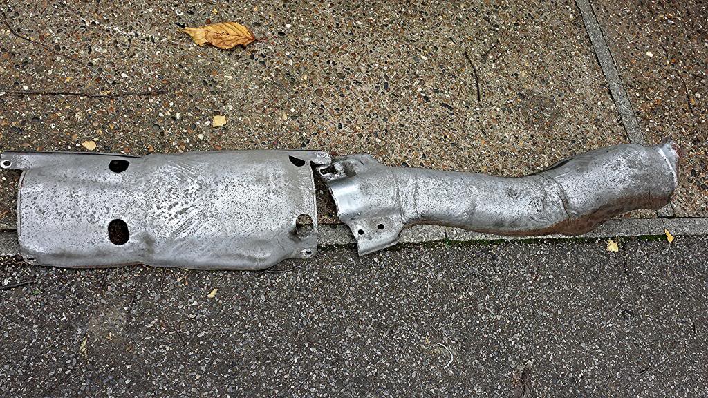

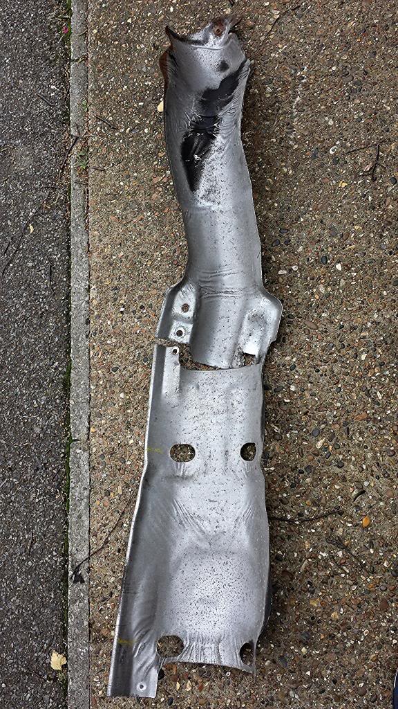

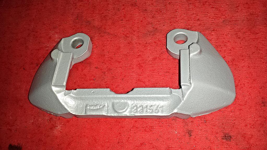

I also removed all 3 steel exhaust heat shields as these where going rusty, these will be going off to the powdercoaters to be blasted and coated in sliver.

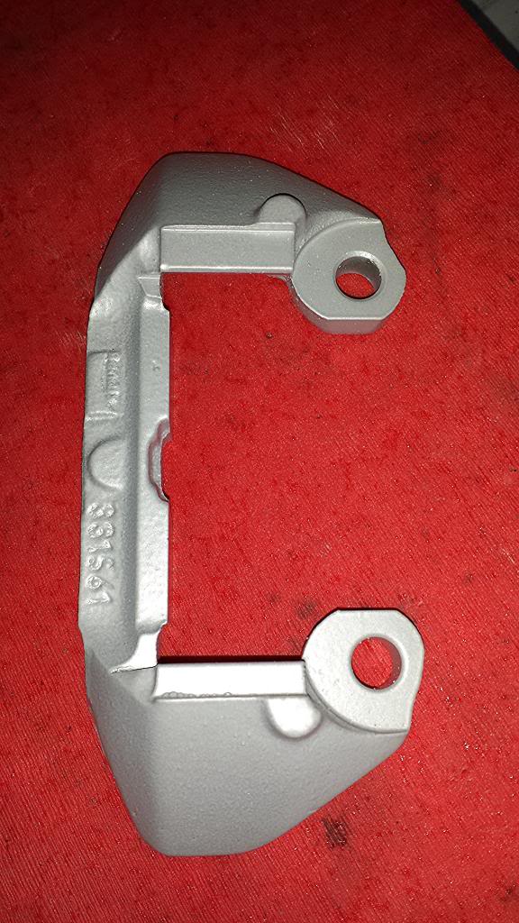

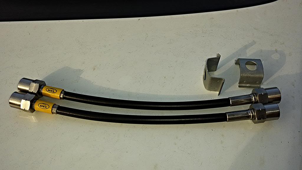

Today i droped off my heat shields to the powder coaters.
Going to be done in sliver.
Also got the rear Hel brake lines fitted.
