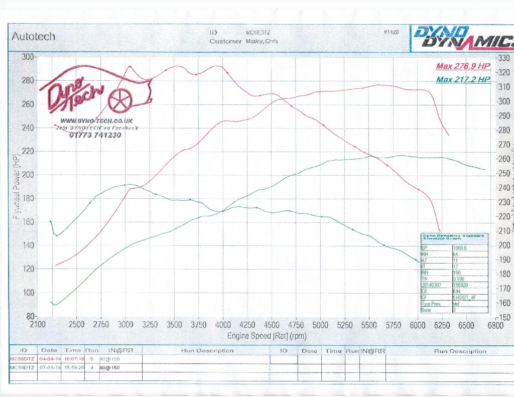

heres the the graph from yesterday, I've clearly got something weird going on, look at the torque between 3 & 4k it drops off twice. I suspect the std boost controller is struggling to cope, I've also got a slight boost leak near the map sensor.
  182 Cup & DCi 172
Have you checked the boost solenoid is ok? From my experience the standard ones are quite woeful, IPD make a lovely upgraded one which is a direct fit. Fitted one to mine with no further problems.

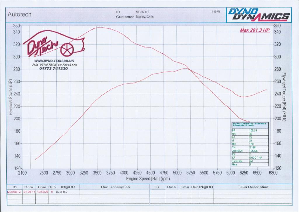

Quick update. It's been back on the rollers at Dyno Tech. The only changes since my last run are a fixed boost leak and a new recirc dump valve. It made 281 bhp and just under 350lb-ft. Graph below. Not sure what went wrong but the power dropped off drmatically at about 5.1k whereas last run it was closer to 6.1k. Either they backed off early or the ECU decided enough was enough. I certainly don't feel the drop on the road.
My torque spikes have now gone (probably down to the boost leak I had) and if it had revved properly I suspect it would have been closer to 290bhp at it's peak.

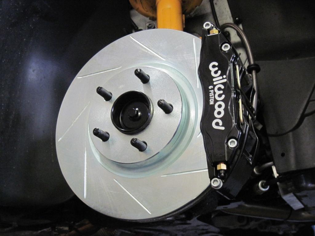

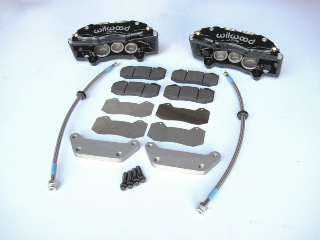

There's allsorts of other bits I want to do too, upgraded boost pipes, boost controller, but before all that the brakes need sorting! I can bolt on Focus ST calipers, and the 320mm discs, but i'm toying with a kit Elevate have just released. It's using 6 pot wilwoods, and the original 300mm dics. $850 (about £500) which is not much more than it would cost me to get a good set of Focus calipers!

Power drops off quick after 5250 RPM ?
Was this done this week as I had my car on the rollers on Saturday in 23 deg heat and it did the same thing to you in dropping off more than last time so this may be down to the hot weather ???
This is the kit
and how it would look

Yes it was done on Saturday. It could be temperature related as it was sat on the dyno for a good few minute (running) whilst they messed about with configuration etc. They didn't turn the fan on until just befor ethe runs.
I'm not sure what else could be causing it to be honest as I certainly can't feel a 40bhp drop after 5k revs!
Is it not the DP and cats that restrict the flow, over the OEM exhaust? I would suggest swapping those out to a larger bore version before changing the exhaust to something loud and non-sleeper-esque.
