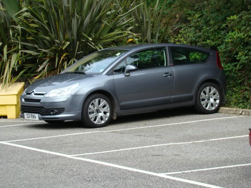

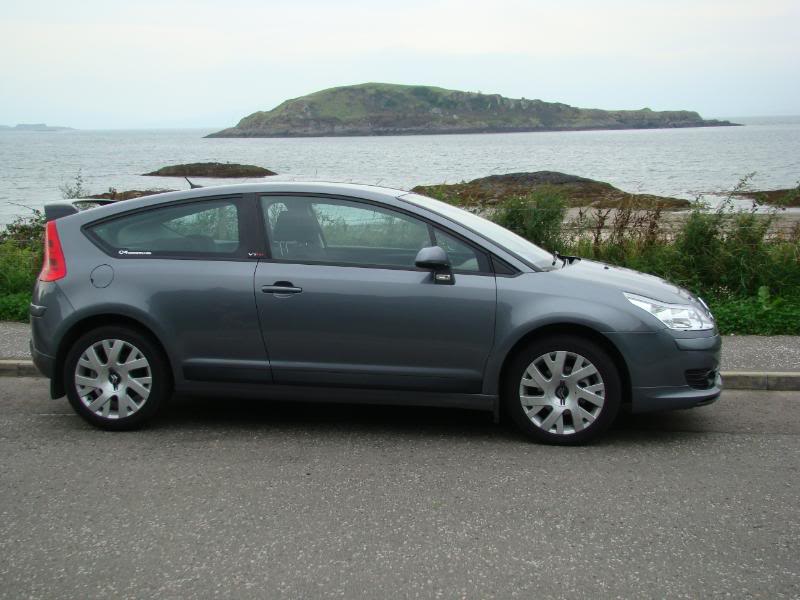

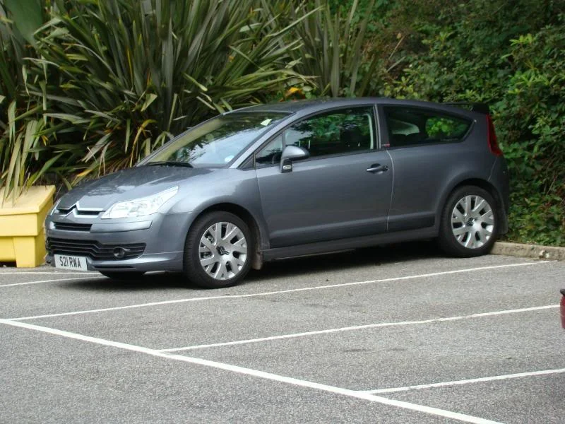

I suppose this thread is useless without pics so here they are.
As it was, higher than a ned on giro day.

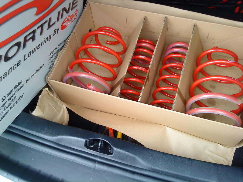

the springs i went for are eibach sportlines, they dont make them for the C4, but after research i found that the oem springs for the 1.6hdi 307 and c4 are one and the same. And then checked with eibach and the parts for the c4 and 307 proline kit were again one and the same i took a punt that the sportlines would fit, and you know what they do like a glove!! well like a spring but you know what i mean.
they took 3 weeks to arrive as eibach had to make them, was suprized at the size of them, well the massive diameter of the fronts and the tiny diameter of the rears.

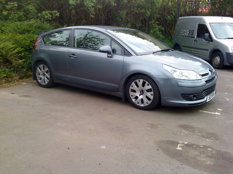

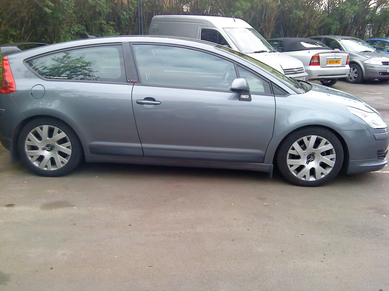

they say they have a drop of 45mm front 35mm rear. but when fitted i swear its more than that, and once bedded in they will be a little lower come FCS.
here is how it sits an hour or so after being fitted.
the pics dont do it justice, in person it looks a lot lower, and getting in and out is a bit alien at the minute. the handling is immediately alot better, through the corners its noticeably flatter, but the ride is possibly better than the OEM springs. i know this will change as they bed in but so far I'm very impressed. I just cant wait for my wheels, marcus says i should get them next week so just waiting on the call to say they are ready.
