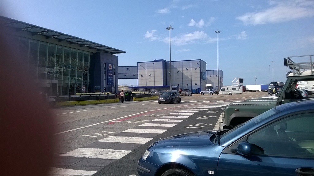

At dover
Leaving the UK
Arriving at Calais

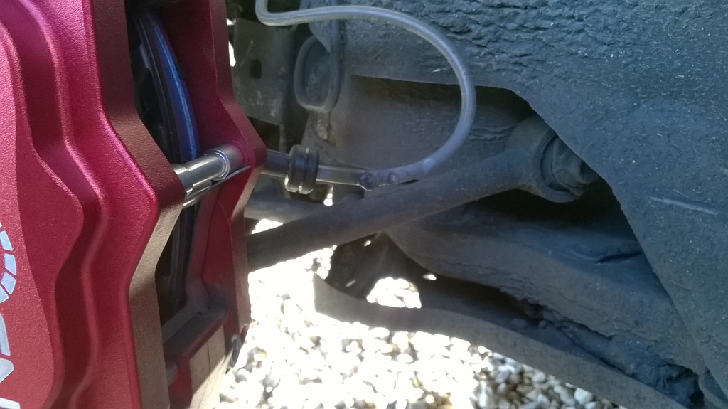

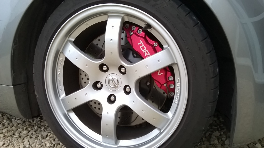

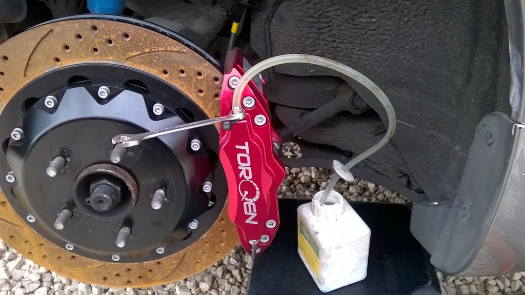

We got back and I set about seeing what had happened to the brakes .
When the rear brakes have been installed the pipe was fitted in the wrong place and was rubbing on the wheel and split the rear .
All my fault for making a very stupid mistake but there you go .

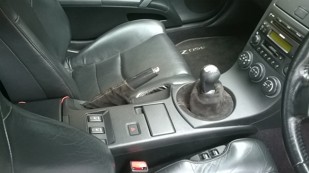

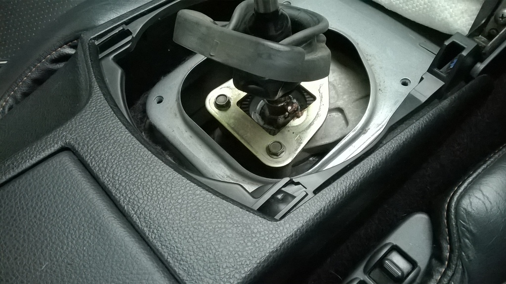

Got another little job done at the weekend .

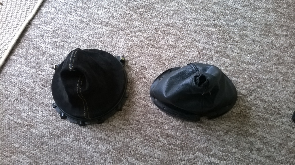

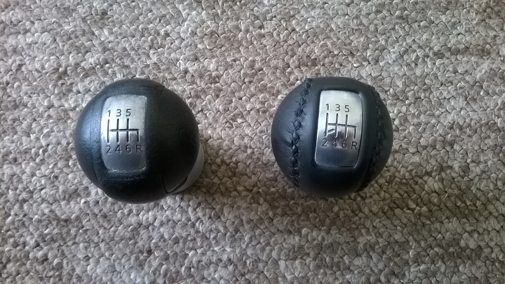

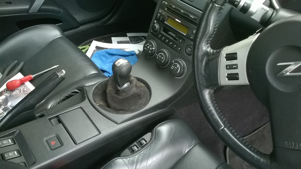

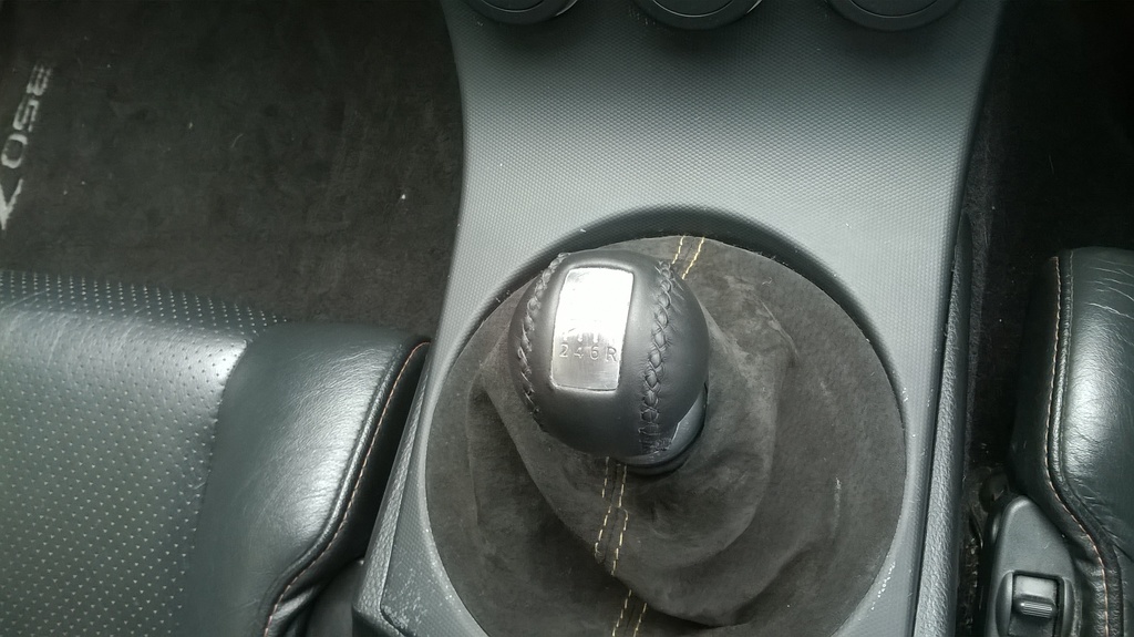

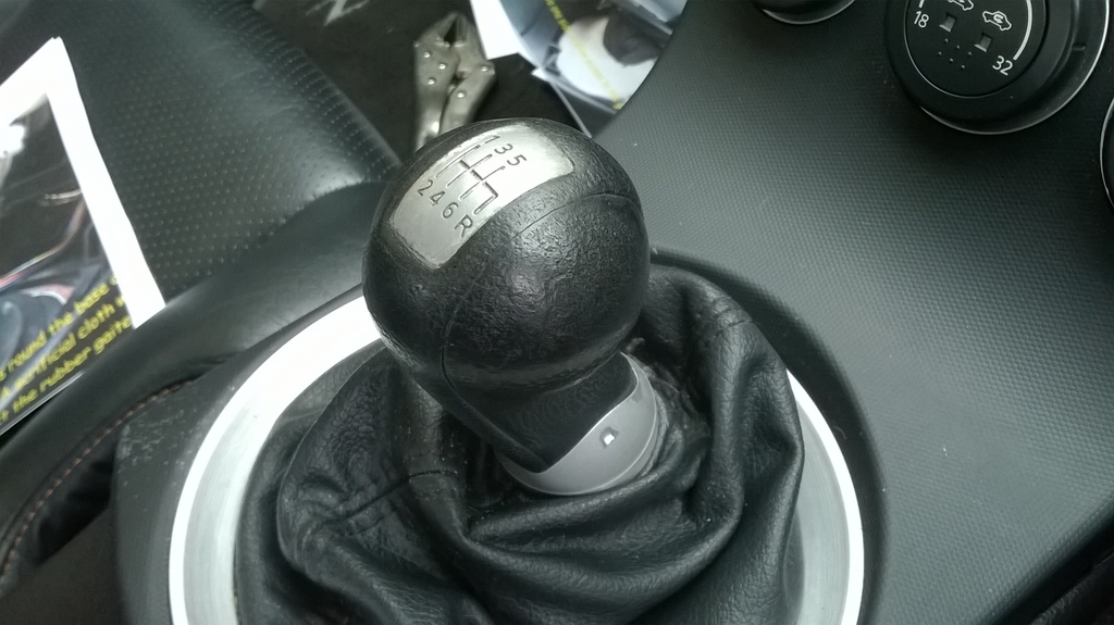

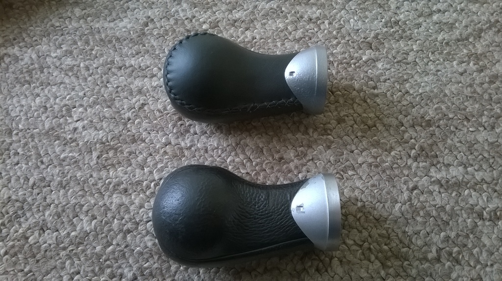

First was to change the old tired gear knob .
Old knob
I got a re trimmed gear know of a member from Hide 'N' Seat .
Old and the new
Also I re aligned the shifter throw and re greased the cup and ball on the gear linkage .
Then fitted a new alcantara gear surround and handbrake surround .
Old vs new .
All done and put back together . I went for the orange stitch to match the seat stitching .

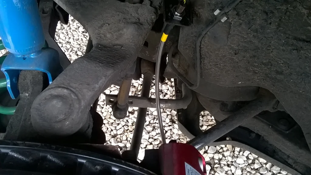

So after my nightmare and killing my car before the ring trip I fitted my replacement rear lines .
Installed correctly this time .
And bleed all of the air out ( there was a lot )

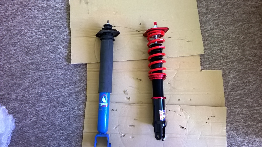

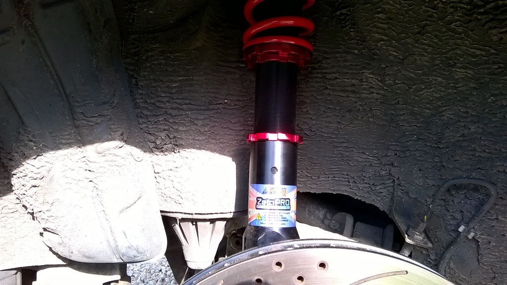

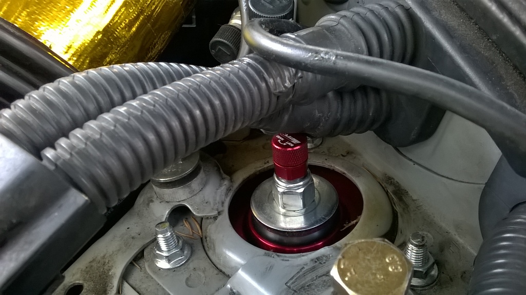

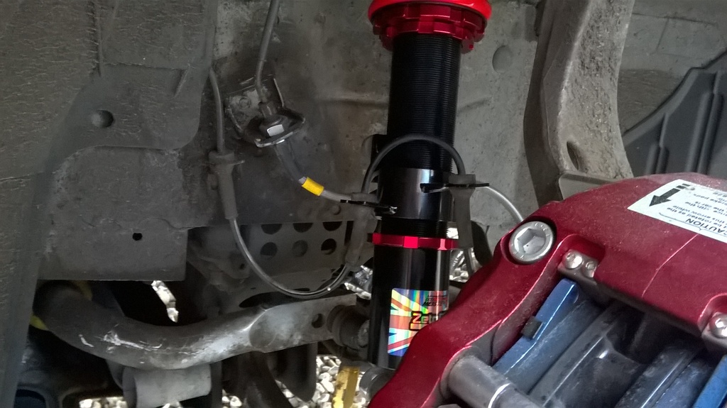

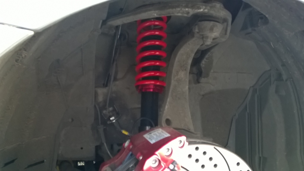

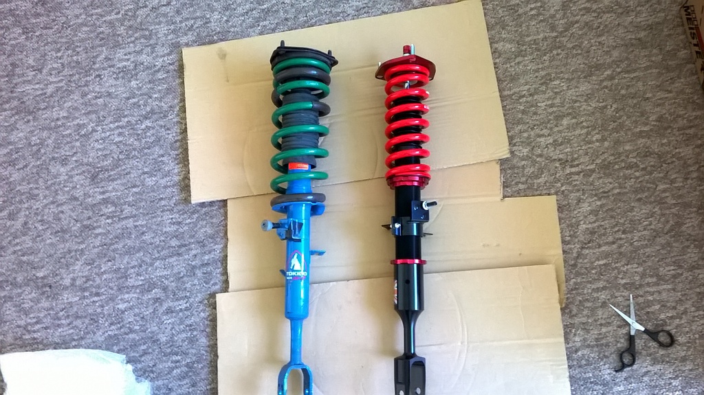

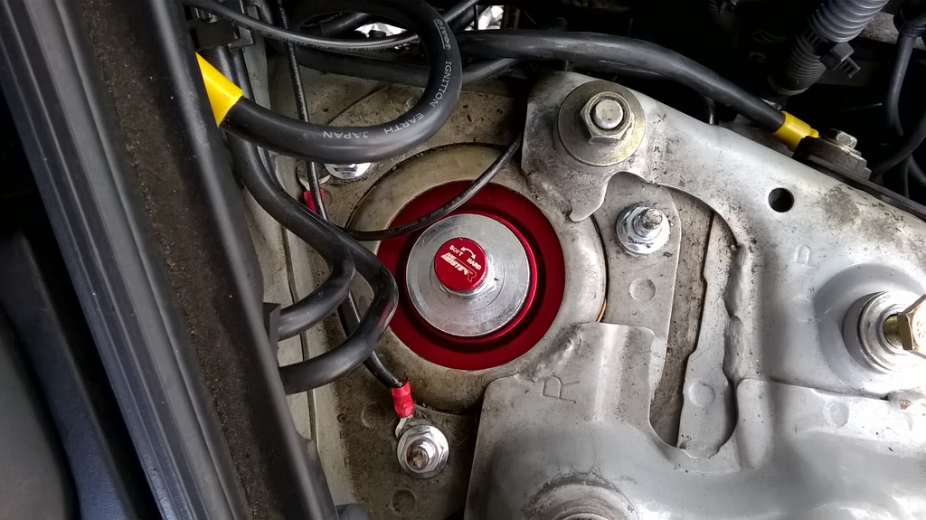

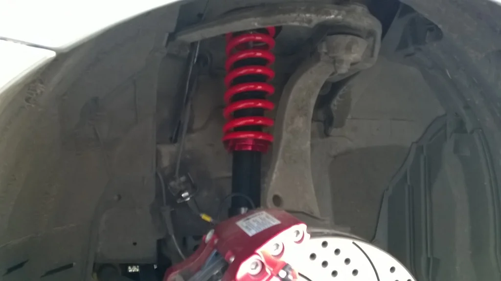

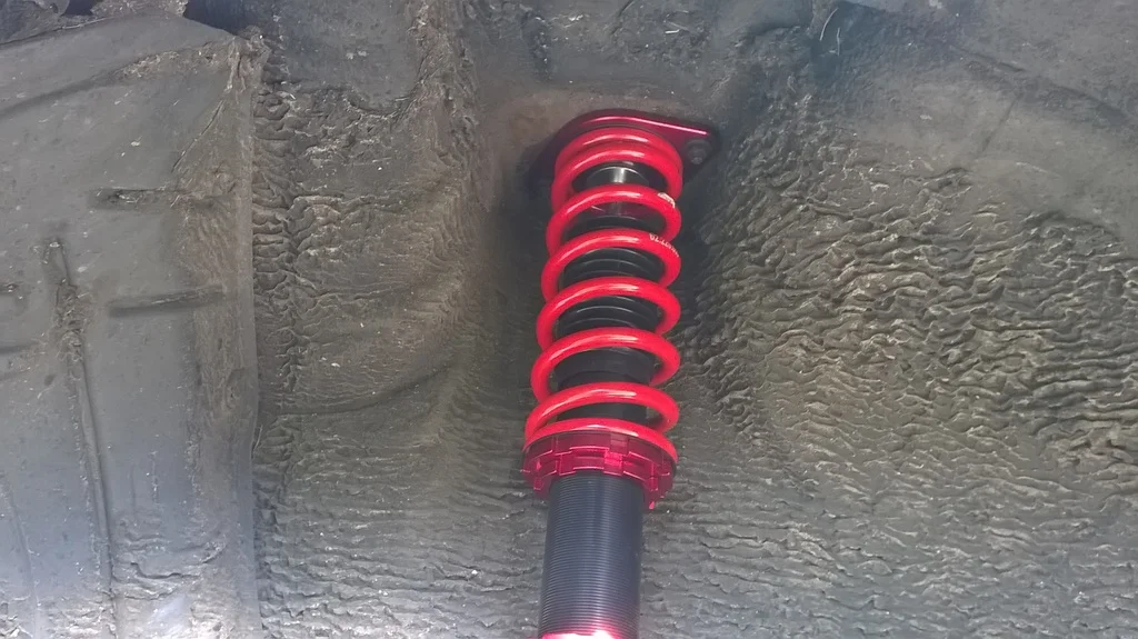

Another update as I got round to fitting my Meister-R Zeta-R coilovers .
Front old vs new
Installed Front
Front adjuster
Rear old vs new
Installed Rear

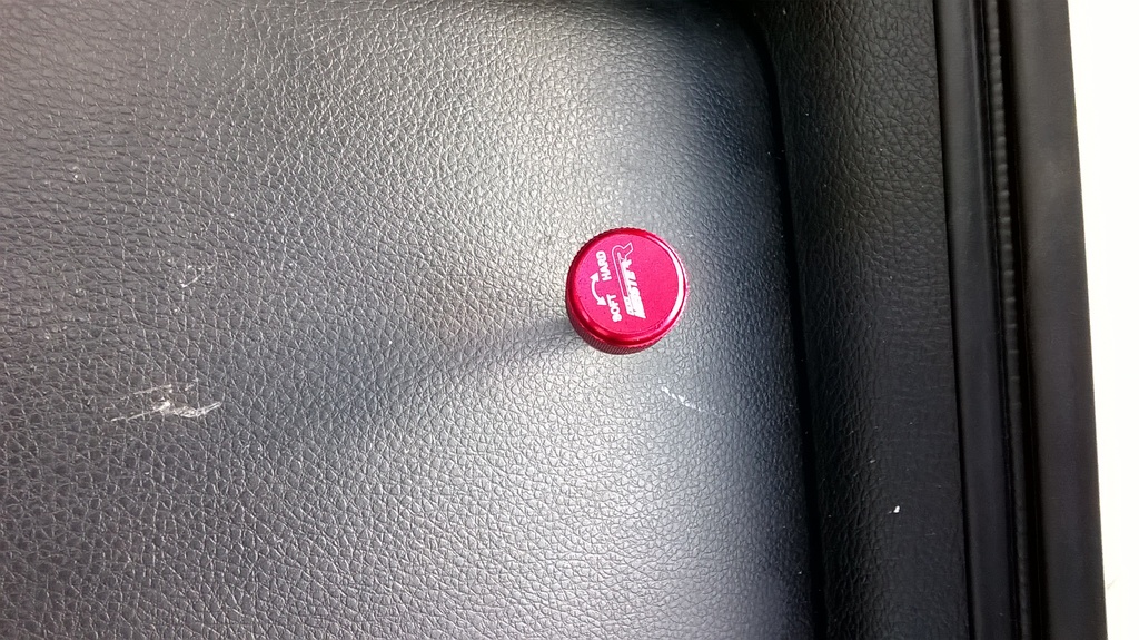

Rear adjuster that needed some drilling of the rear brace .
Have only driven it a few miles but the handling is night and day on full soft to the set up that was on it .
Ride is 3-5 % more stiff on full soft vs the old set up so nice and compliant on full soft .

Does he have the Zita R or Zita S .
The S is more for road use but the R is hi performance and true coilover front and rear as the 350z has inboard springs at the rear .
Alan
More good updates.
A friend has those on his mx5, great coilovers.
Philip.
  VRS 245
Pretty sure he has the R.
He does quite a few drift and track days around the country.

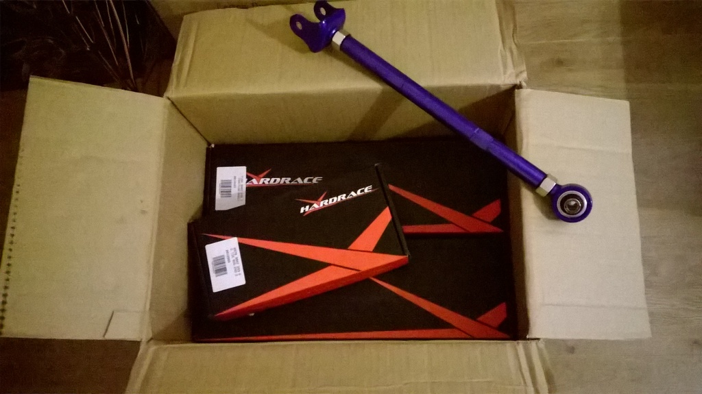

Update time .

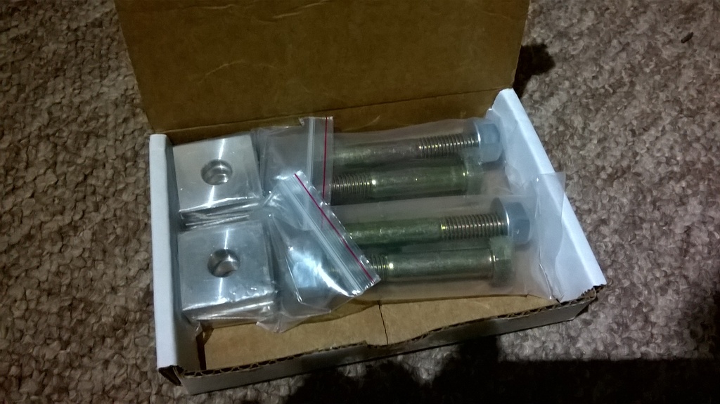

Got the below that will be going on in 4 wees time to finish off the car for this year .
Rear poly camber arms
Rear poly tow arms
Rear Poly coilover link arms
Tall front track rod ends
White line rear Poly diff bush kit
Moterdyne ART pipes ( fancy de cat pipes )
ECU re tune
Full tracking set up for fast road
And last but not least ATB Quaife diff

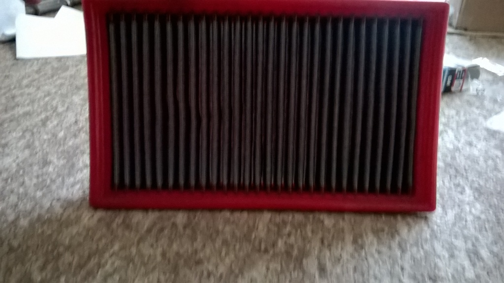

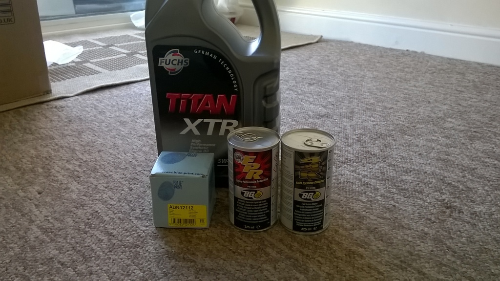

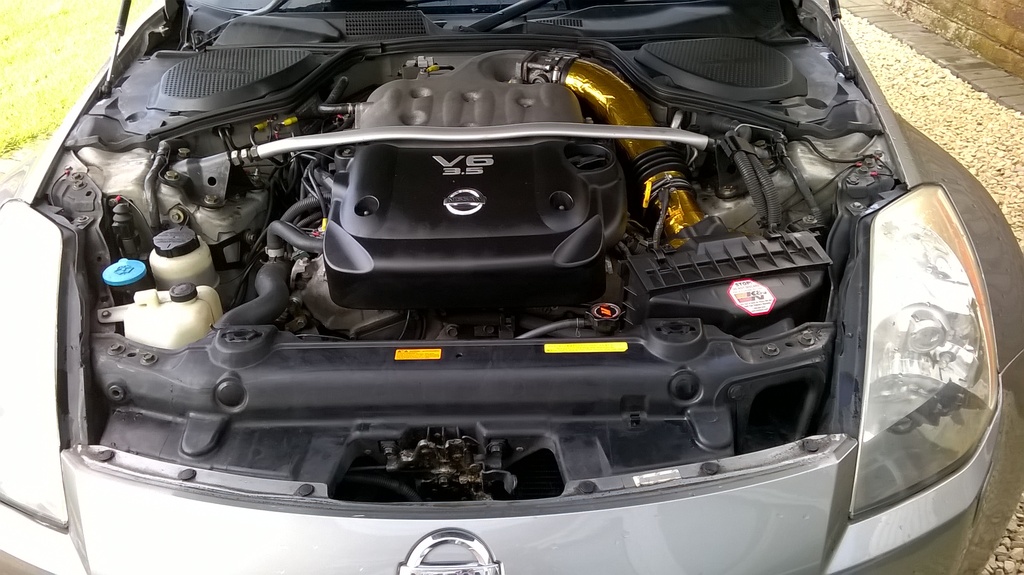

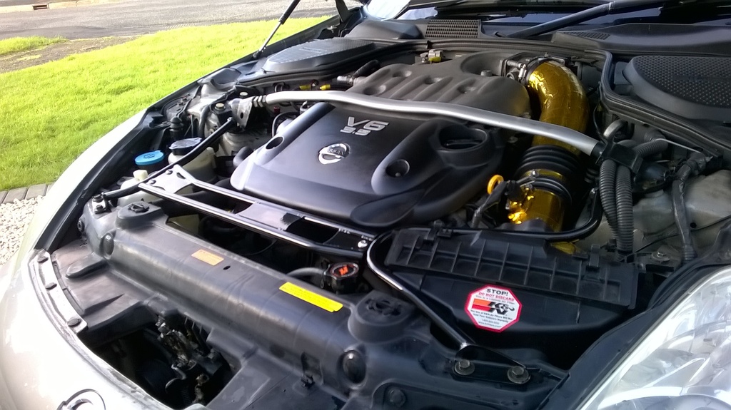

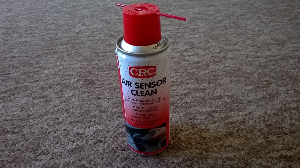

On to this weekend and a small service of oil and filter change and fuel system cleaner and engine flush .
Also cleaned out the BMC air filter .
And gave the MAF sensor a good clean .

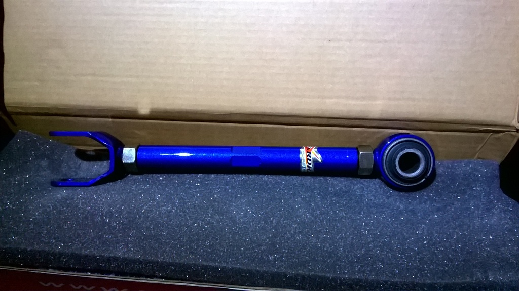

On Thursday I took the car down to Abbey Motorsport for a few parts to be done .

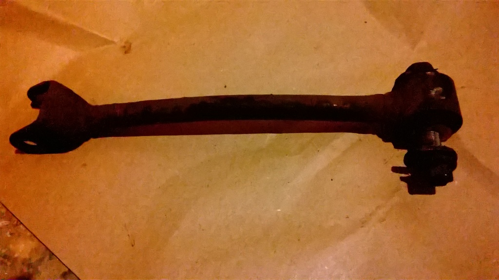

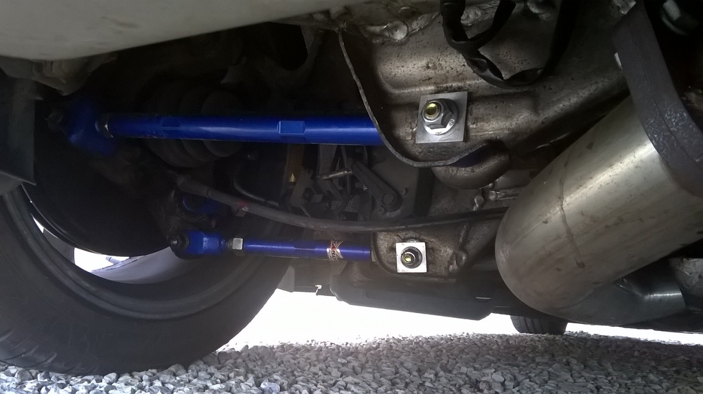

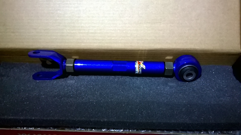

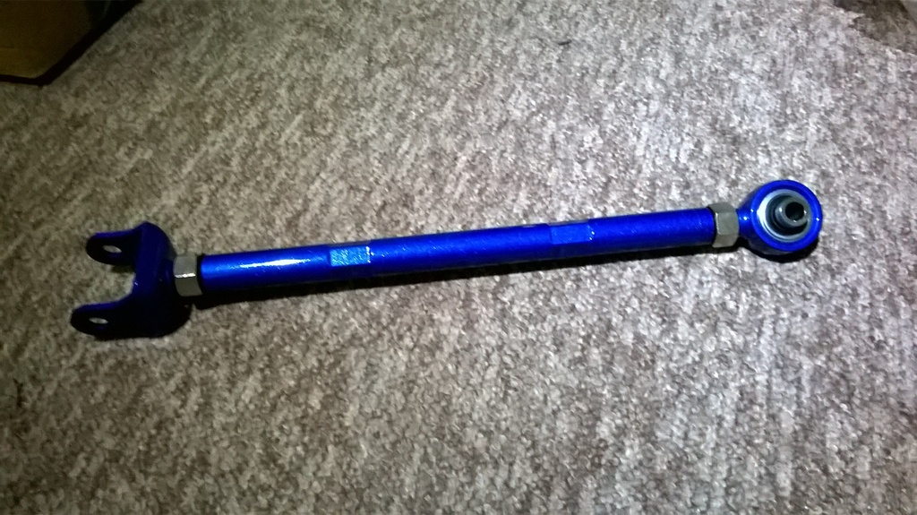

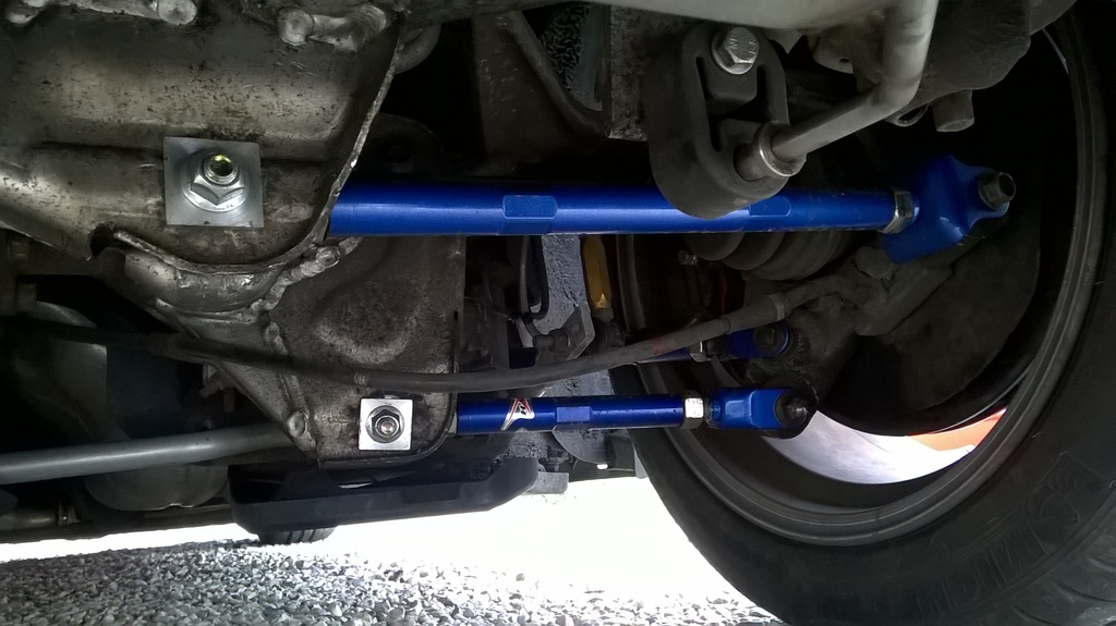

First up was to change the old tired camber arms
Old
New Hardrace uprated adjustable units .

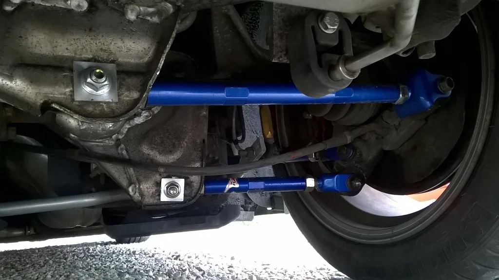

Then the rear old tow arms .
Then was the spring bucket replacement Hardrace uprated adjustable units .
They replace the inboard spring bucket that are left when using true dual coilovers .
New lock out camber bolts as the tracking can be undone on the original camber bolts if hitting large potholes .

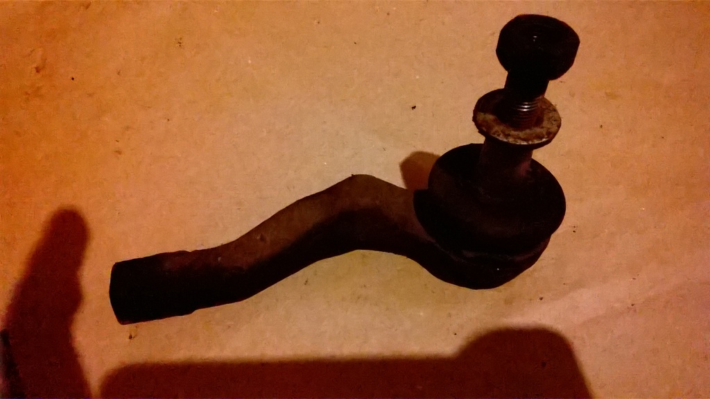

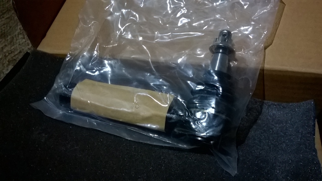

Then on to the old front track rod ends .
New Hardrace uprated long shaft units .

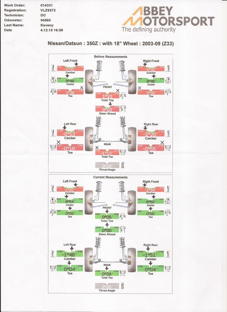

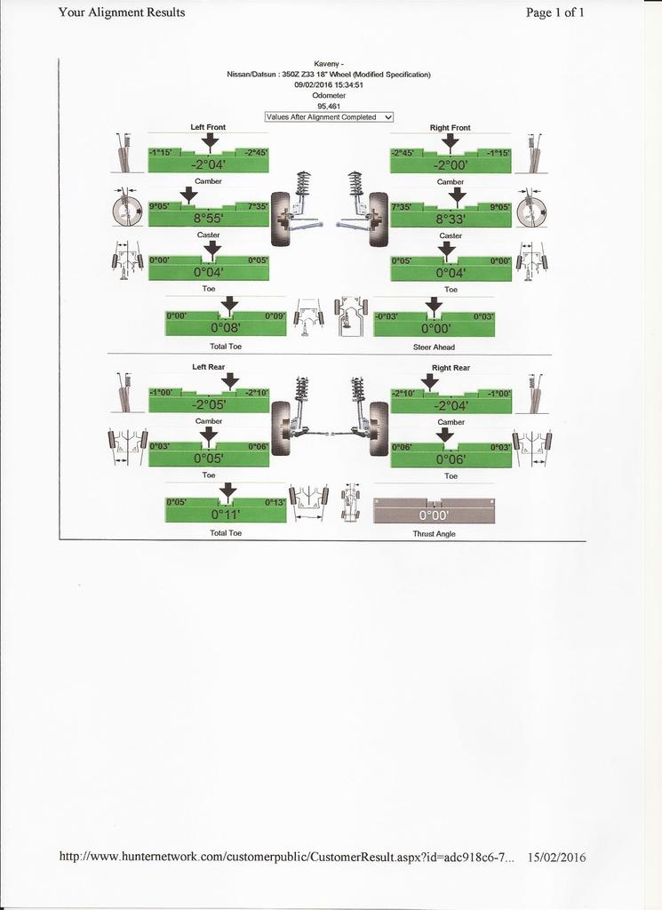

Then after all of the suspension changes a full tracking session was done .

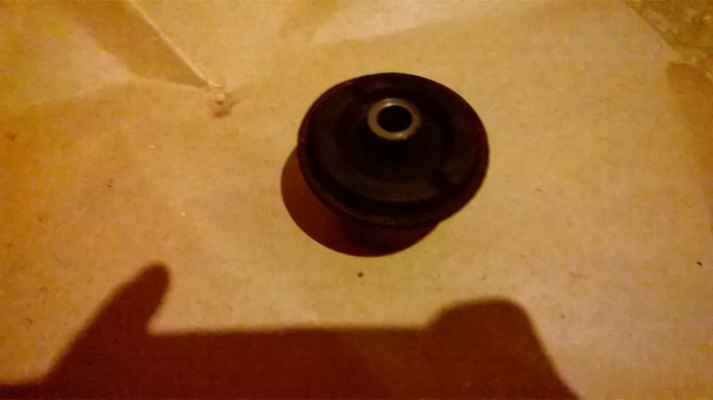

Next up was the Diff .
The diff bush bearings were getting and were knocking and one was leaking so needed to be changed .
Old units
New Whiteline bushing kit

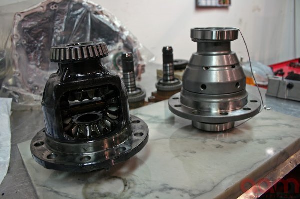

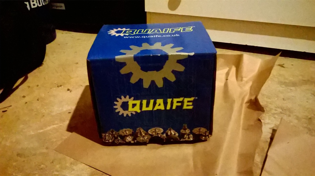

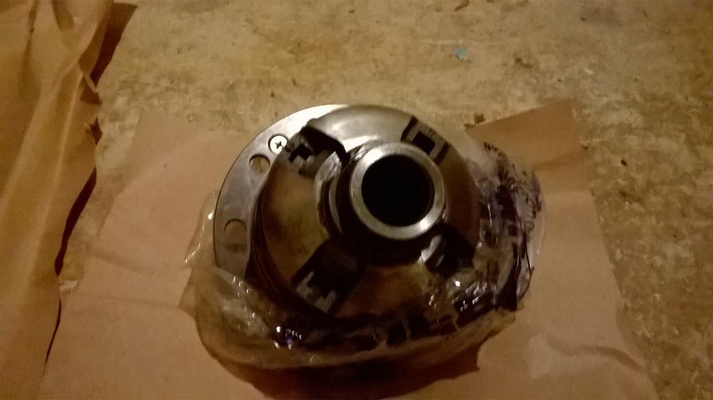

Then on to the diff .
The unit in the 350Z UK car is an open vicous type and the last time I did a diff oil change the unit looked a bit tired .
After doing some reading the best plan for me was not a clutch type as it is still my road car so a Quaife ATB was put on order .
Old Differential unit
New Quaife ATB unit .

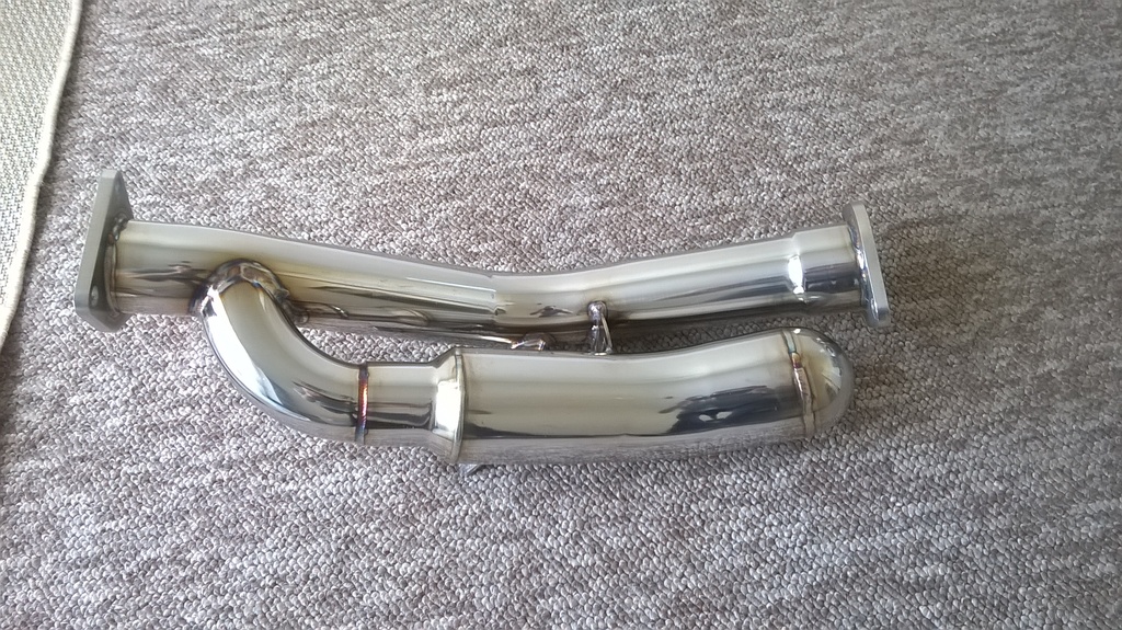

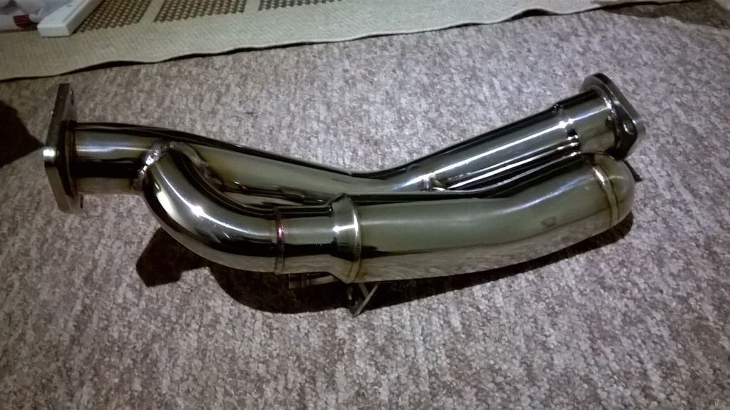

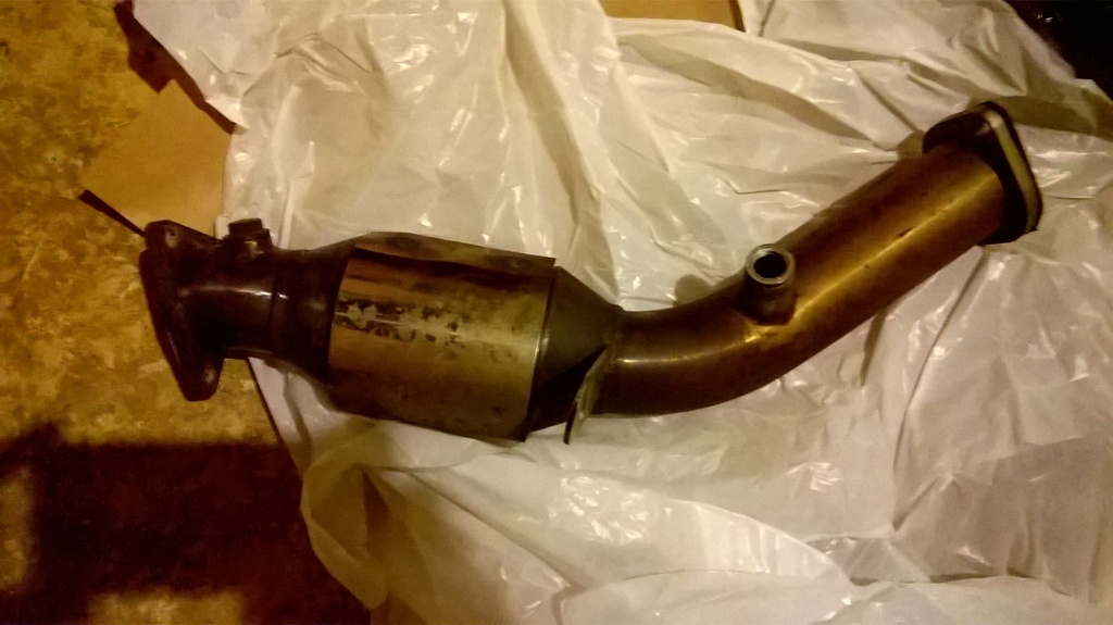

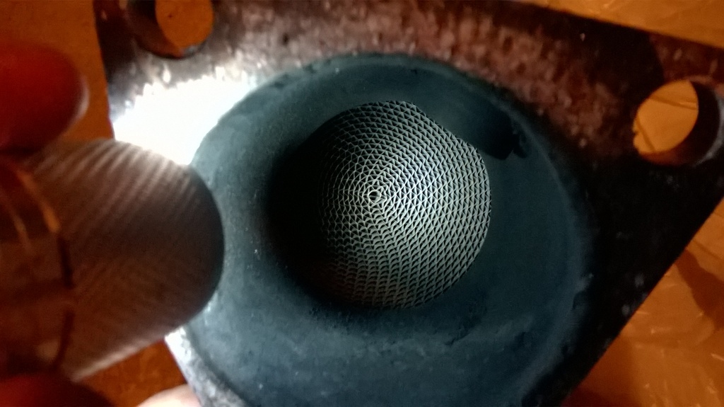

Then last on the list was to change over the hi flow sport cats for some Moterdyne ART pipes .
Old Cobra hi flow sport cats
New Moterdyne ART pipes .
Sound clip I will load up later but the car is still nice and quite and not too loud but give a good bark on full throttle .

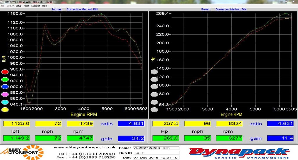

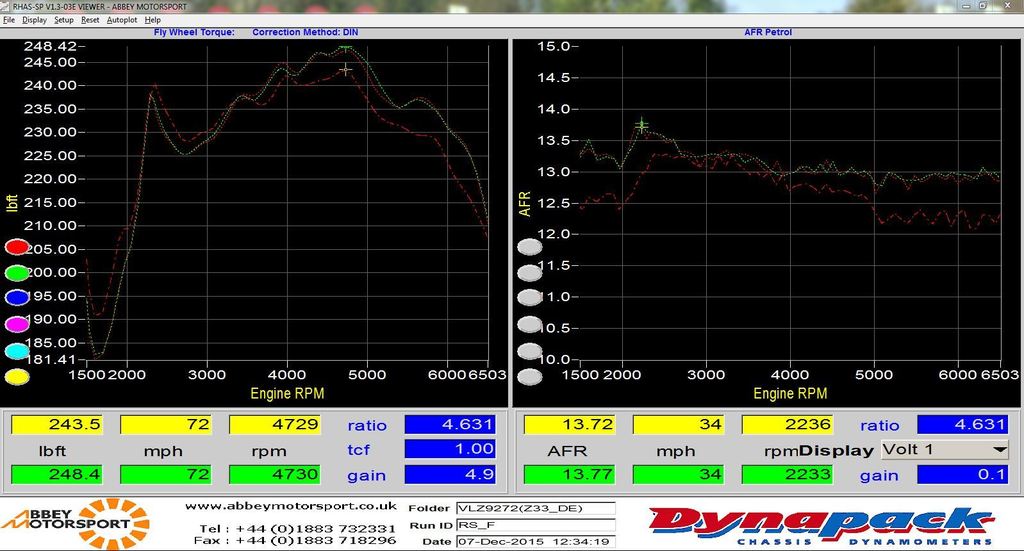

Last up was to put the car on the Hub dyno to tweek for the new ART pipes .
I was not expecting that much improvement in power but the ART pipes gave a 11.5 BHP gain and 5 LB/FT gain so very good in the end .
So the car is now putting out 310 BHP and around 288 LB/FT .

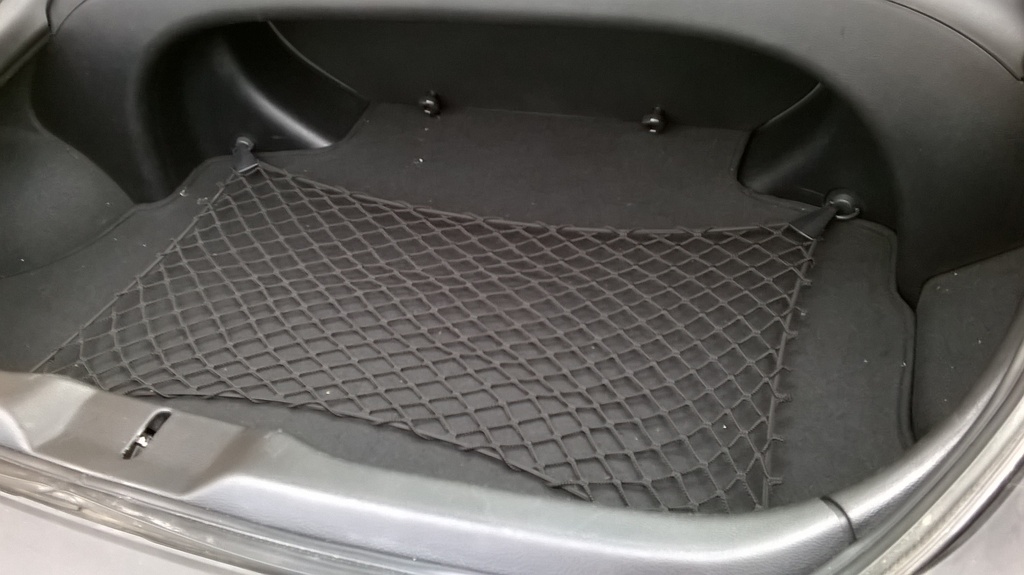

First up was a cargo net that I have been wanting for a little bit .

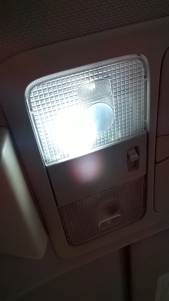

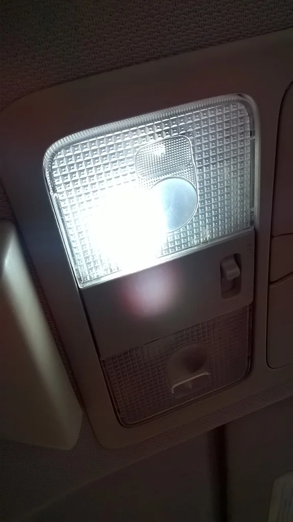

Small update

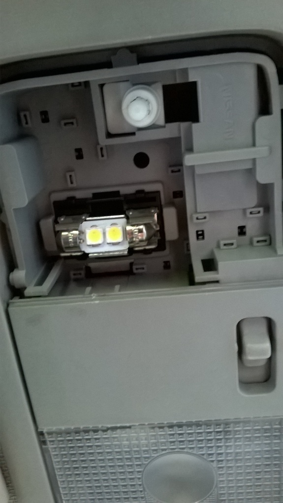

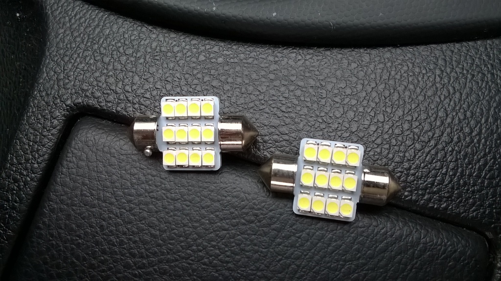

Changed the map lights old LED 2 type to LED board type 12 LED

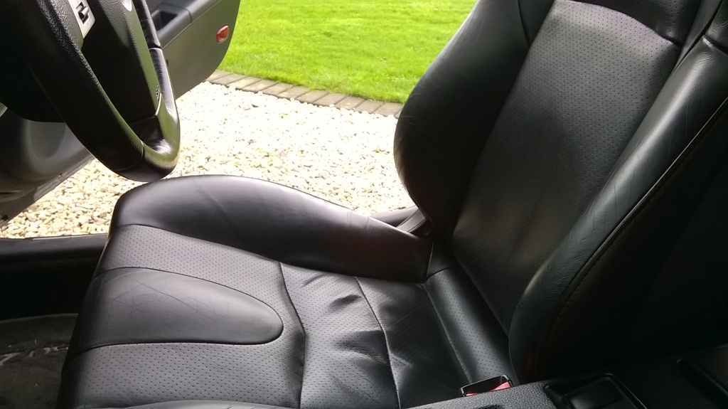

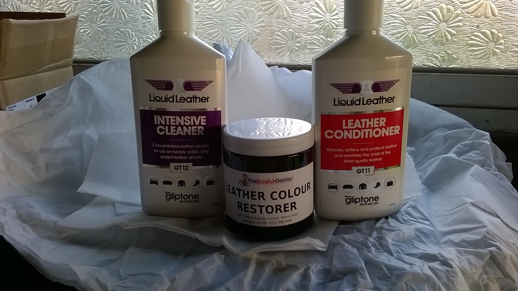

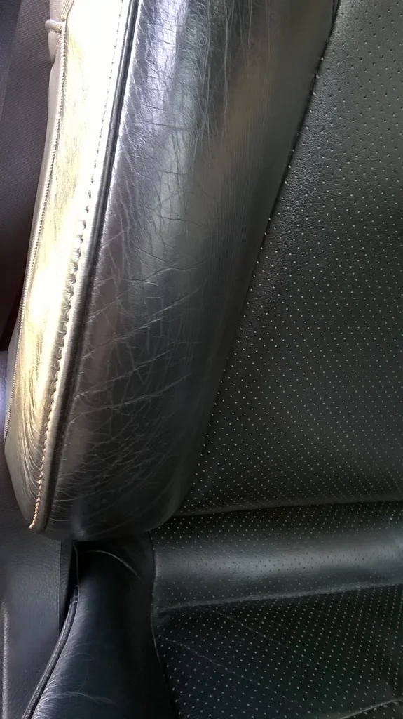

Then gave the seats a good going over .
After a clean and tidy up .

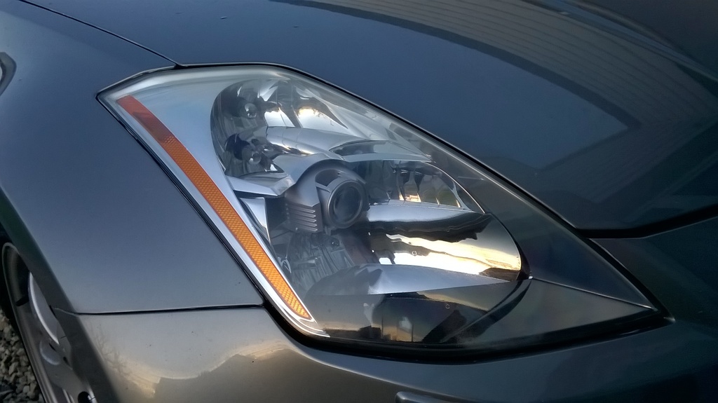

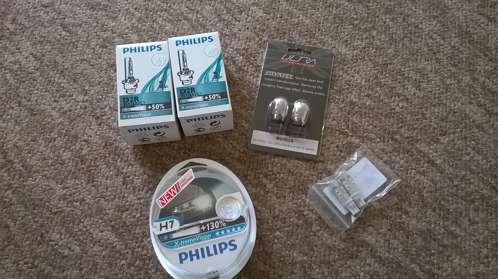

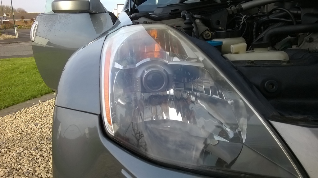

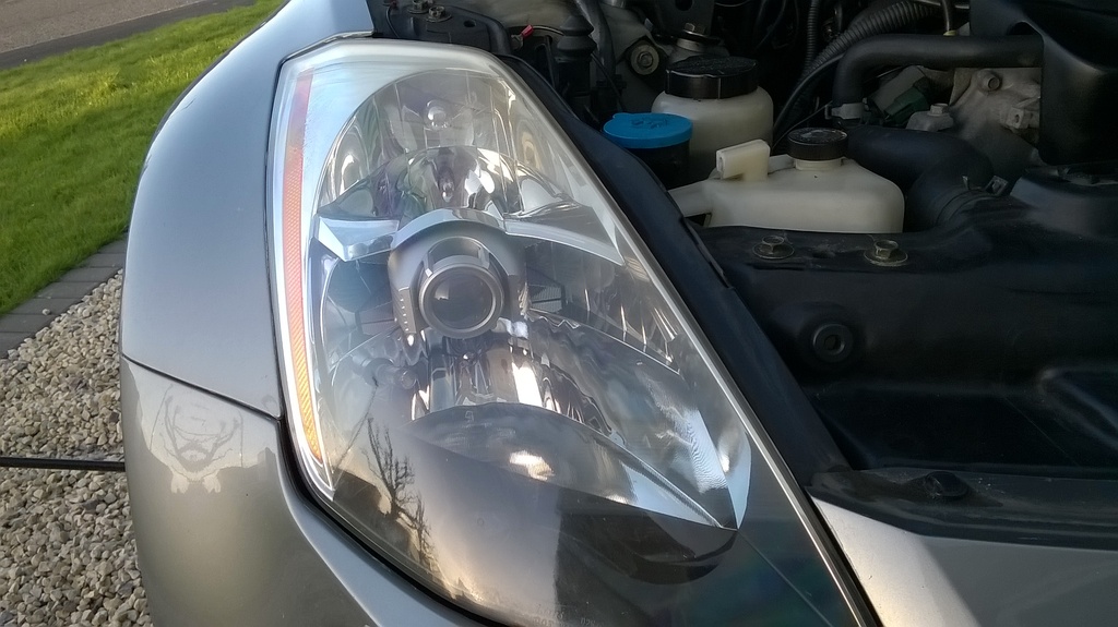

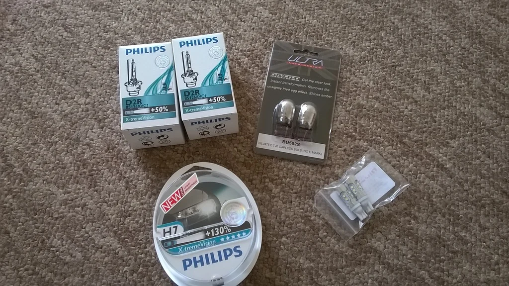

Got round to changing all of the headlight lamps at the weekend bit of a pain as you have to remover the inner wing arch liner .
Thought I would upgrade all the lamps .
The main beam ones Philips extreme H7 + 130%
The dipped Xenon ones Philips extreme D2R + 50%
The side light ones are 501 50W CREE
The indicator ones silver vision
The old units with the orange indicator lamp in place .
All changed over and working

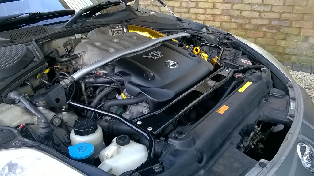

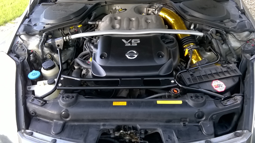

Just thought I would list all of the parts I have done so far .
Nearly there just a few more bits to do .
ENGINE
OIL PAN SPACER
MISHIMOTO PERFORMANCE RADIATOR
MISHIMOTO RADIATOR FAN SHROUD KIT
RAD COLLING PANEL C/F
MOTUL COOLANT
DEI TEMP COOLANT
ENGINE GROUNDING KIT
ENGINE BRACE DAMPER
GOLD PLUG OIL DRAIN PLUG
DEI GOLD HEAT TAPE
NGK IRIDIUM SPARK PLUGS
GATES A/C + DRIVE BELT
MOTERDYNE ART PIPES EXHAUST
MILLTEK Y PIPE EXHAUST
MILLTEK CAT BACK EXHAUST
DC SPORTS 3-1 EXHAUST MANIFOLDS
H-DEV PLENUM SPACER KIT
UPREV ECU REMAP X 4
MOTORDYNE ARMAID INLET GASKET
MOTORDYNE COPPER THROTTLE BODY HEATER
2006 350Z AIR BOX
BMC PANEL FILTER
DRIVETRAIN
MOLYSLIP GEAR BOX OIL
HELL S/S CLUTCH LINE
FUCHS GEAR OIL 75W-80
QUAIFE ATB DIFF
WHITELINE REAR DIFF BUSH KIT
LUK DMF
EXEDY CLUTCH KIT
NISSAN MTF GEAR OIL
SUSPENSION
NISSAN BANANA ARMS
WHITELINE FRONT ARB
WHITELINE REAR ARB
WHITELINE FRONT HD DROP LINKS
WHITELINE REAR HD DROP LINKS
HARDRACE REAR CAMBER ARMS
HARDRACE REAR RADIUS ARMS
HARDRACE REAR LOWER ARM
HARDRACE FRONT CAMBER ARMS
HARDRACE FRONT LONG TRACK ROD ENDS
ULTRA RACING FRONT LOWER BRACE
ULTRA RACING REAR W BRACE
REAR CABIN BRACE
FRONT CORE 2 POINT BRACE
MICHELIN PILOT SUPER SPORT TYRES X 4
EGEAL PRO TRACKING
MEISTER-R ZETA R COILOVERS
SPL LOCK OUT CAMBER BOLTS
BREAKS
TORQEN BBK XXL 8POT KIT
ATE SUPER BRAKE FLUID
TORQEN S/S BRAKE LINES
EXTERIOR
XEONES PHILIPS EXTREAM X 2
PHILIPS H7 EXTREAM
SILVERTEC LAMPS
50W CREE LED SIDE LIGHTS
MICHELIN STEALTH WIPER BLADE
LED NUMBER PLATE LAMPS
HONDA SHORT AERIAL
BONNET DAMPERS
INTERIOR
MAP LIGHT LED
PINGI CAR DEHUMIDIFER X 4
ALCANTARA GEAR AND HANDBRAKE TRIM
HIDE AND SEAT RE TRIM GEAR KNOB
CARGO NET

Then another alignment .

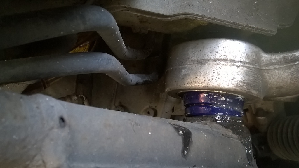

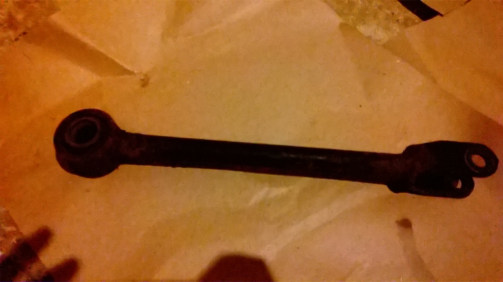

The front compression arms ( banana arms ) were changed last year but were showing signs of cracking again so some Superpro polyurethane were fitted .

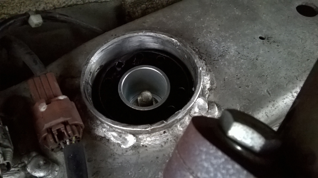

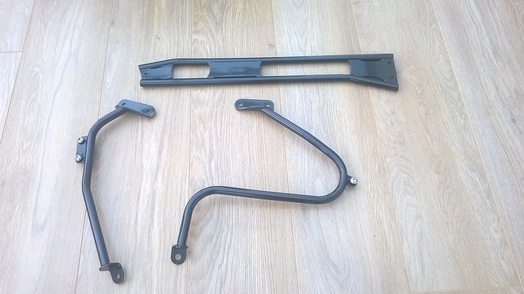

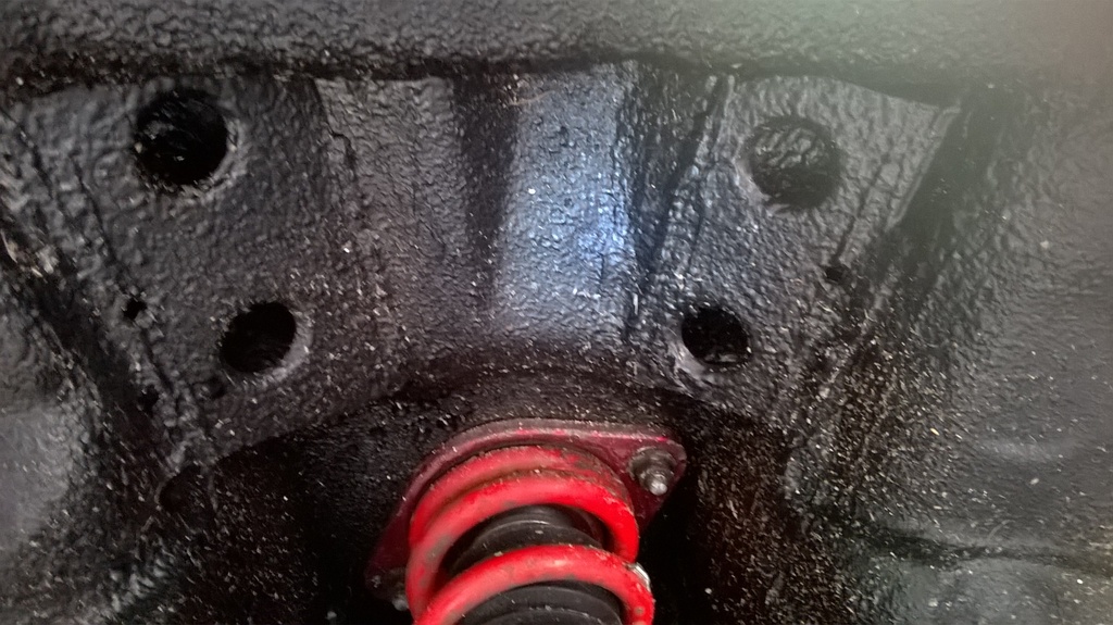

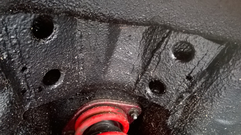

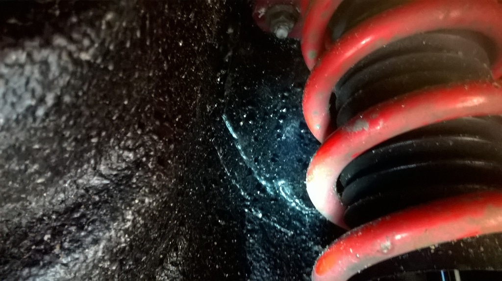

The car is running dual coilovers front and rear ( not the more common front but separate rear shock spring set up ) and the rear strut / top mount is not designed to take the load of the shock and spring so this needed to be strengthened with seem welding
and a new plate to link the upper and lower section together and 2 braced plated per side fitted along with a good coat of Waxoyl .
