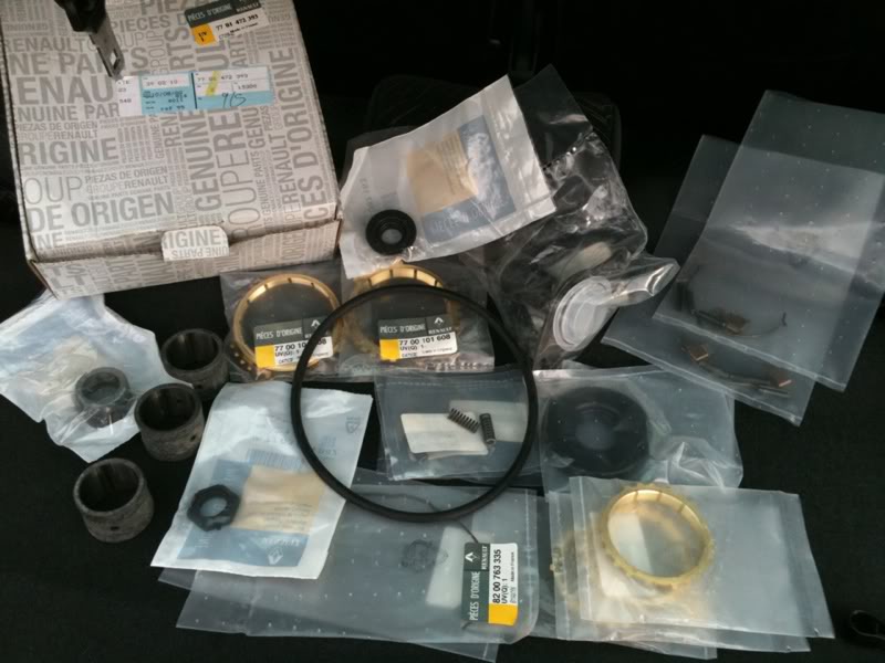

Are you able to provide a Renault part number for that jc5-130 kit? Renault Sweden managed to get me the jc5-089 kit = fail
Are the big service kit only 200?
My Gearbox on my 172 Ph1 is JC5-089
The only part number Renault could come up with was 7701472393
The Kit was all there and correct except for 1st and 2nd synchro's which to me looked like JC5 diesel ones so I couldn't use them.The individual prices on these 2 synchro's were astronomical so I passed on changing them. They looked good and braked the gear ok so I just carried on.

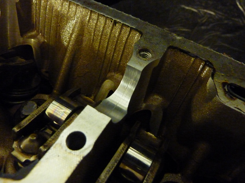

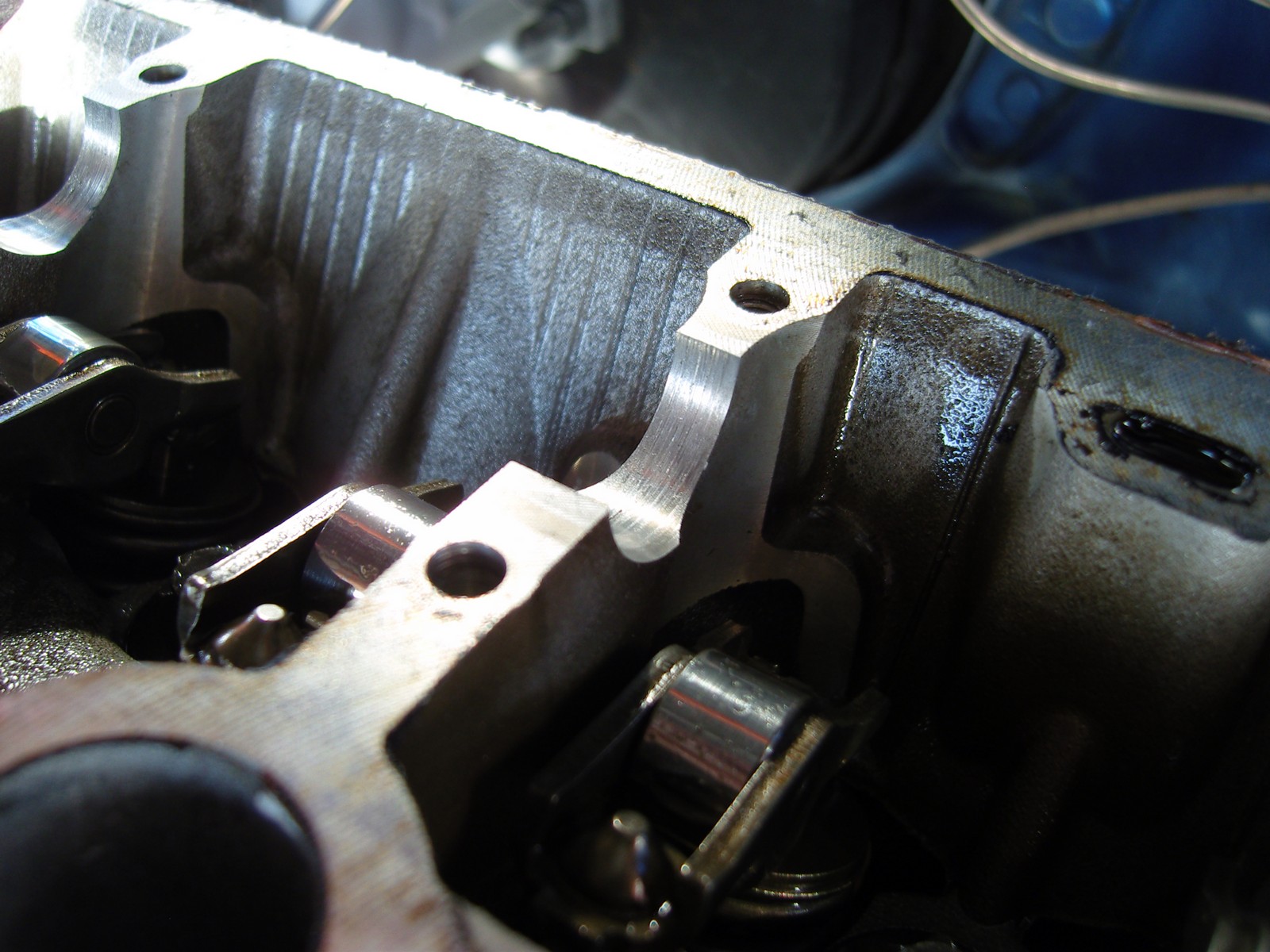

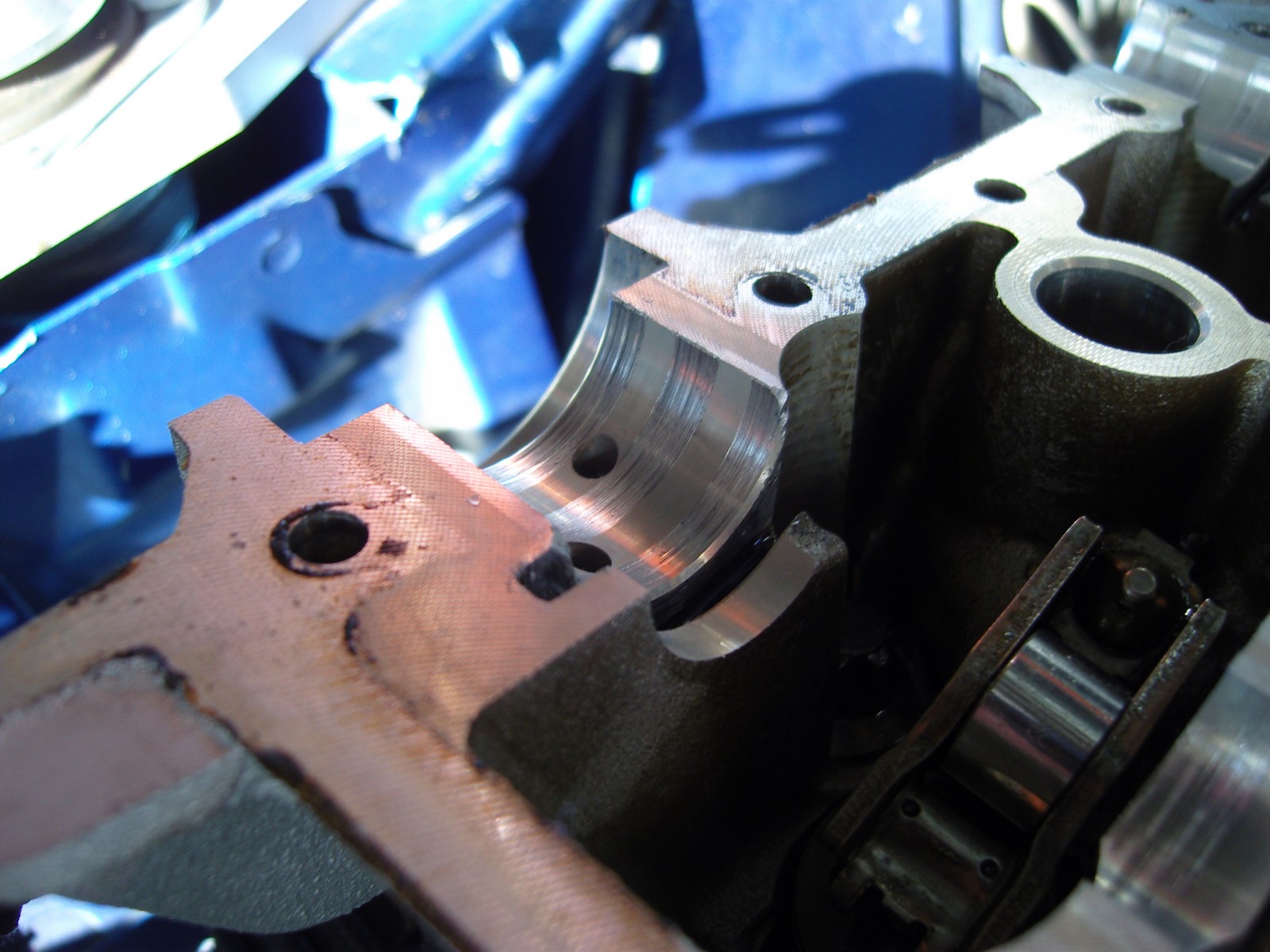

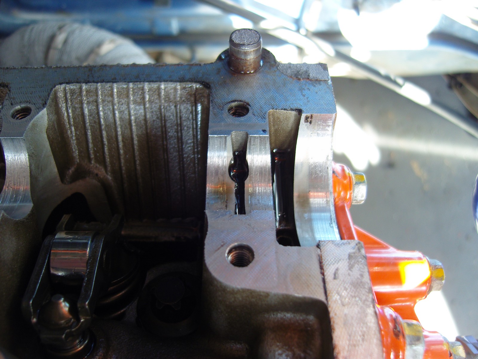

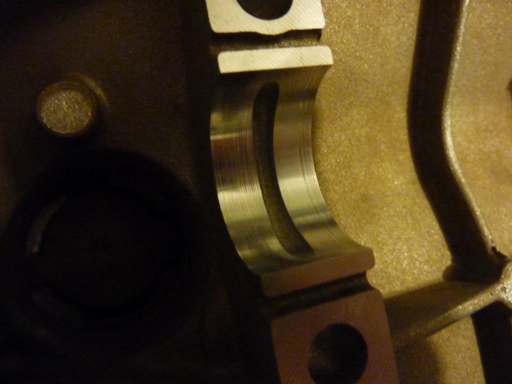

Mine was rather bad I guess, the worst scratches could easily be felt with your fingernail. I polished the worst out smoothening the edges and put it together with new cams. The engine have been going 2½ years and 24000km since then, most of them under racing conditions and it is still going strong.
This is how mine looked.
View attachment 79427View attachment 79428
I've seen worse than that tbh. I would've run that again as well!
Thats the kit i got the first time from Renault. For several reasons that kit is not ok for a JC5-130. The locking pins are to short, the 5th gear nut are not the same and more important the seal for the in-going shaft is not right. JC5-089 have the seal integrated with the guiding for the release bearing while JC5-130 have the seal integrated with the in-going shaft bearing.
Im also after the big kit including bearings and all.
That looks normal to me. I'd reuse it myself.

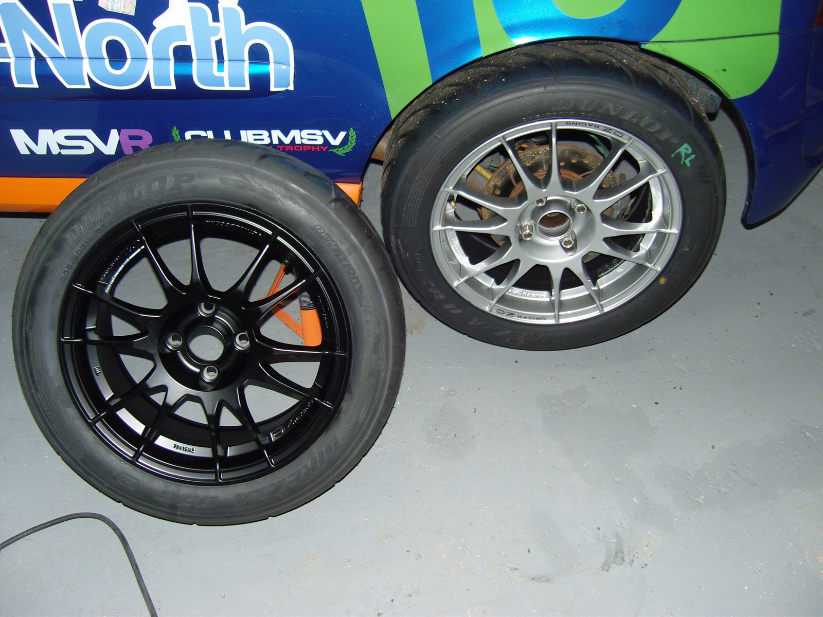

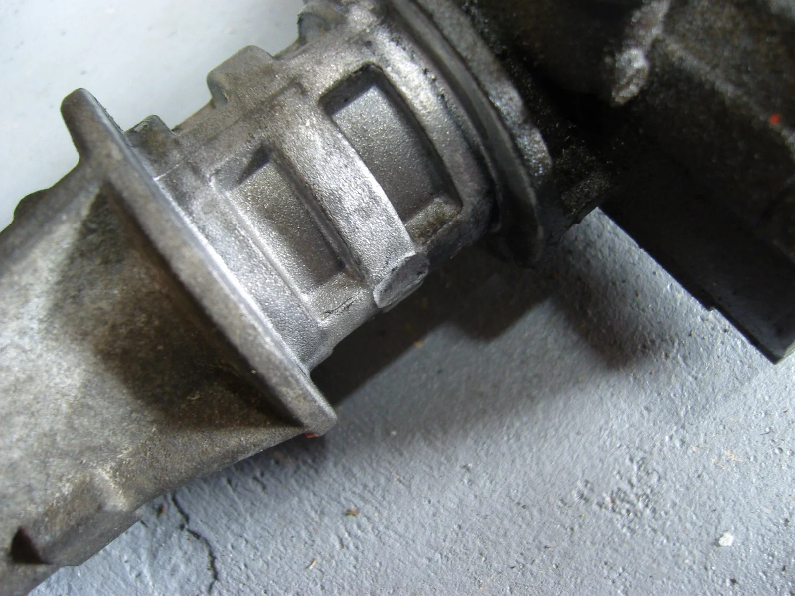

Oh I did some other jobs this weekend. My new black Ultraleggeras arrived and I fitted my new steering rack. Whilst fitting I noticed the locating pin on the other rack was missing, no wonder it was difficult to align with the column. Having a custom bracket made to secure my Saxo pump and then Ill get some custom pipes made for it, also chopping off a lot of the gearbox ally mount. Pics to follow.

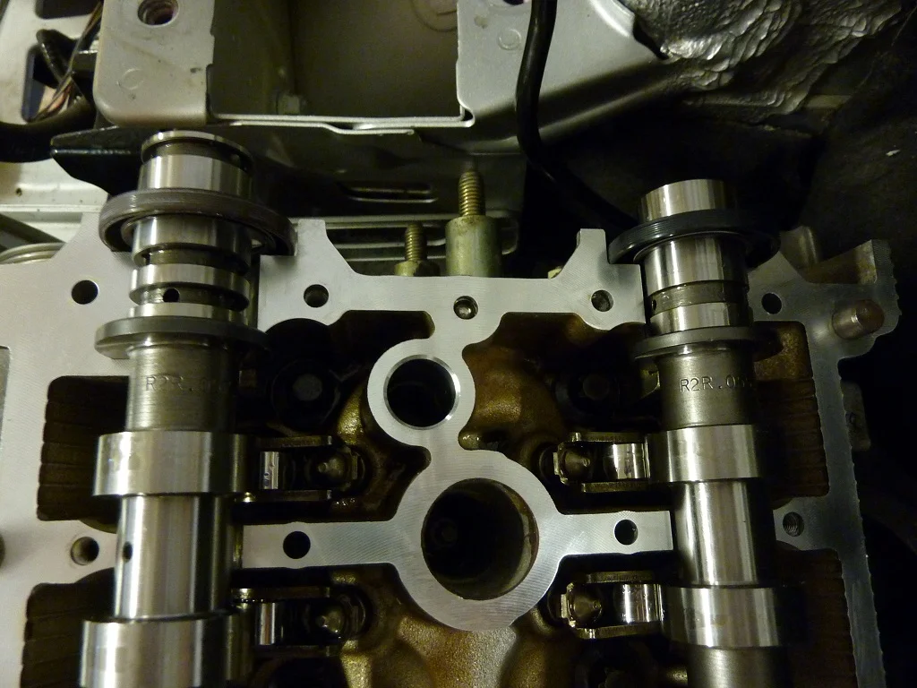

Is the head dammaged? Looks badly scored in the last picture or is it suppose to be like that?

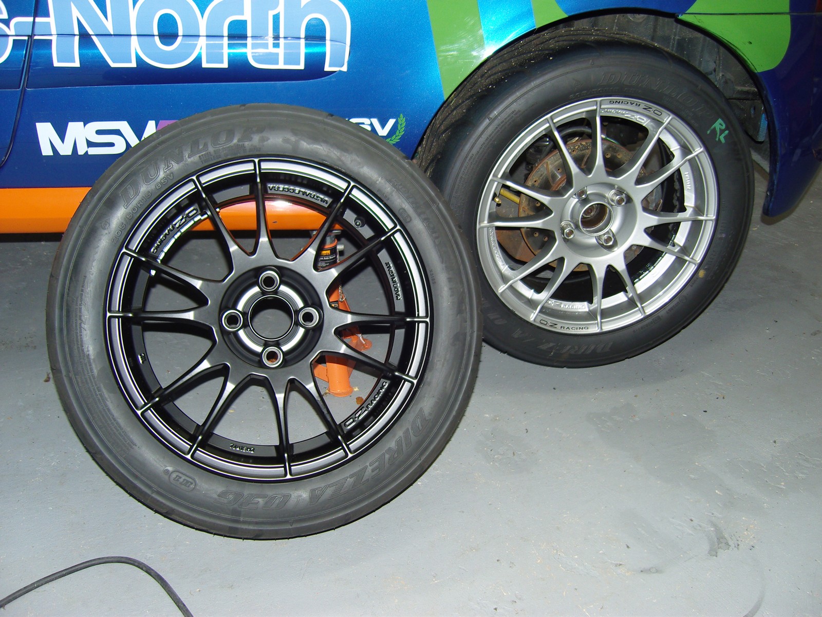

What size tyres have you got on the Black wheels?
  182 trackday racer
Scratching looks very bad on the last pic, may analyse it wrong bit there may be traces of going warm aswell. Worst case scenario this may be evidence of longterm oilstarvation, not good. If you are doing the head I would check the bottom end for damage aswell. Rather sure that head is a gonner :(

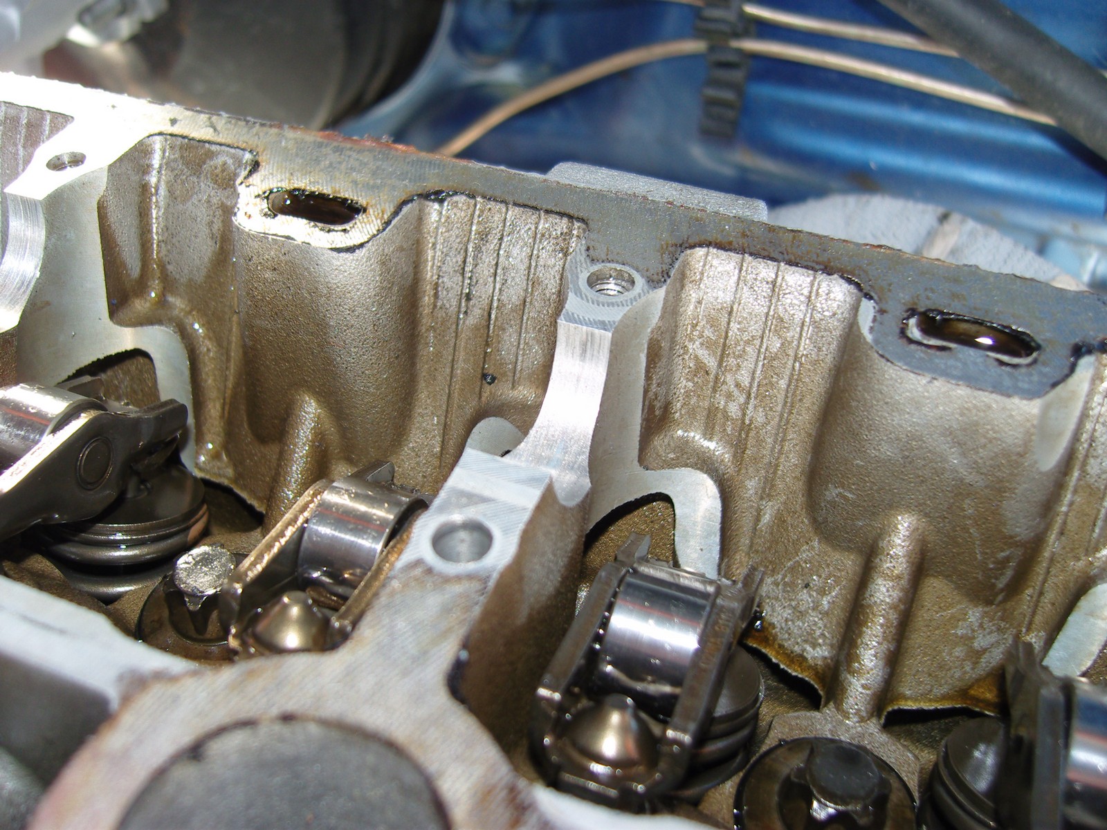

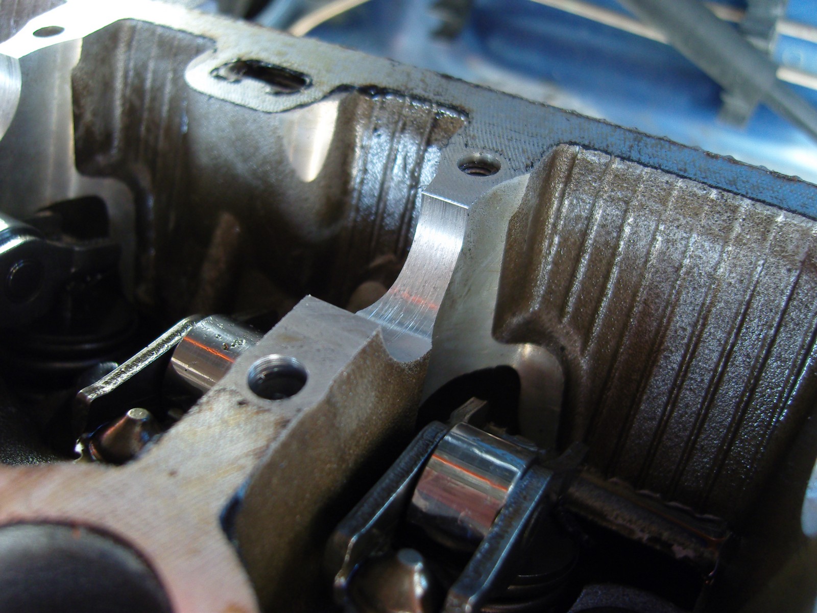

In the last picture of the head it looks as if there is a piece of casting broken off? Never had one apart tho so don't know if it's manufactured rough like that?
  182 trackday racer
Sharp eyes, can not imagine its supposed to be like that. Wonder where the missing piece are.... That may be the cause of oilstarvation aswell. IMO that head is wasted. You also need to find that missing piece it may be stuck anywhere in the engine... I feel bad just thinking about it.. :(
Tried to find a picture to 100% confim but I have no photo of my head without cams in it.
  182 trackday racer
EDIT: From what I see on pictures of my top that piece is not supposed to go all the way up to be flush agains the cam cover, so far so good, but the sharp edge looks wierd so does the heavy scratching.

Are the black wheels 17s that you were talking about trying? Will be interesting to see/hear the results if so.
Upon a little bit of Zooming in on the picture I can see they are 205/50/R15's
So just another set of wheels and tyres as a spare i suspect.

Like the look of the black superleggera. Powder coated or painted?
Do you have oz spigot rings for them and if so where did you get them? I need one as it's got lst somewhere.
that's how they are
the scoring on the journals doesn't look great but it may polish out

Wheels will come once ive gotten through these 3 sets of 205s I have. Black Ultra leggs are spares for my super soft Yokos for a cold day then I have Toyo for wets and Direzzas for balls out dry :)
