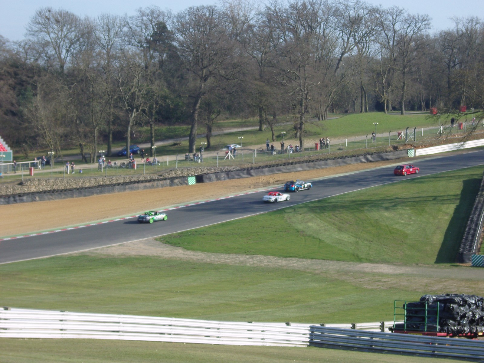

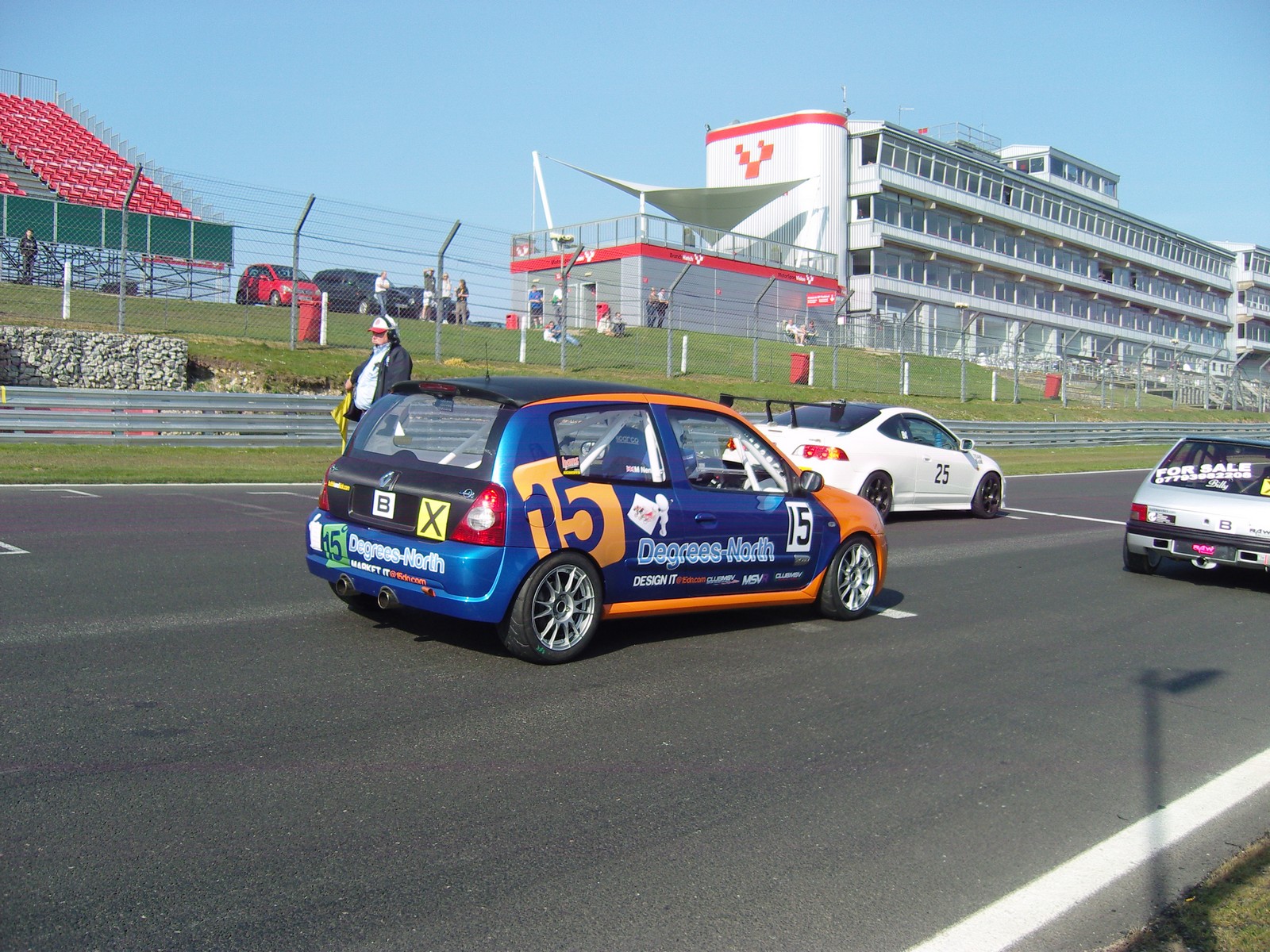

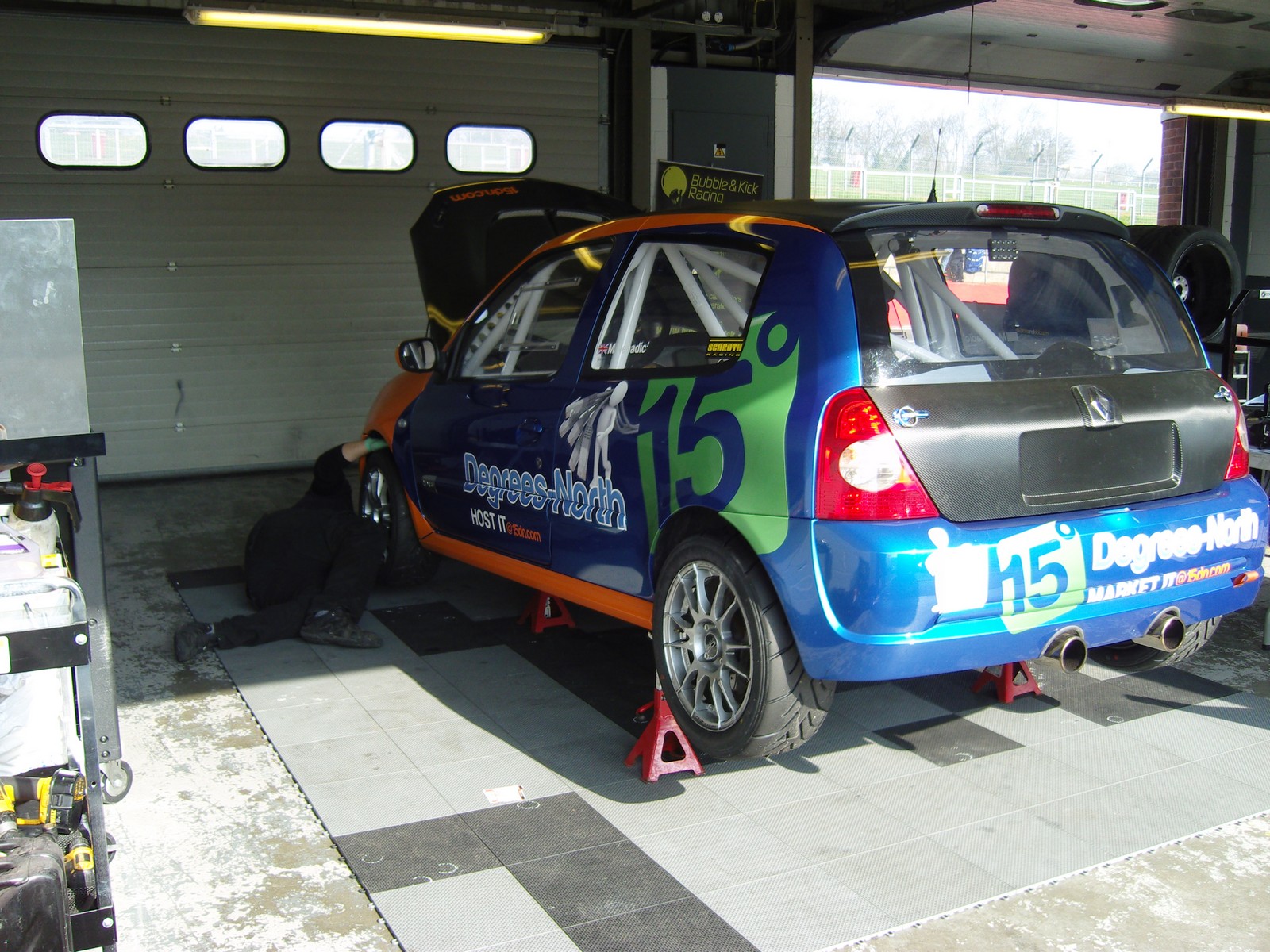

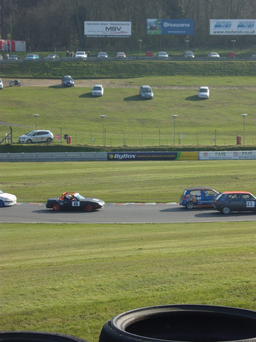

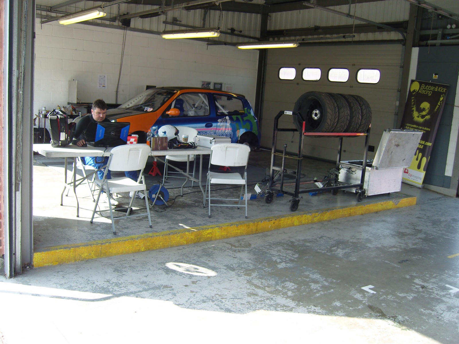

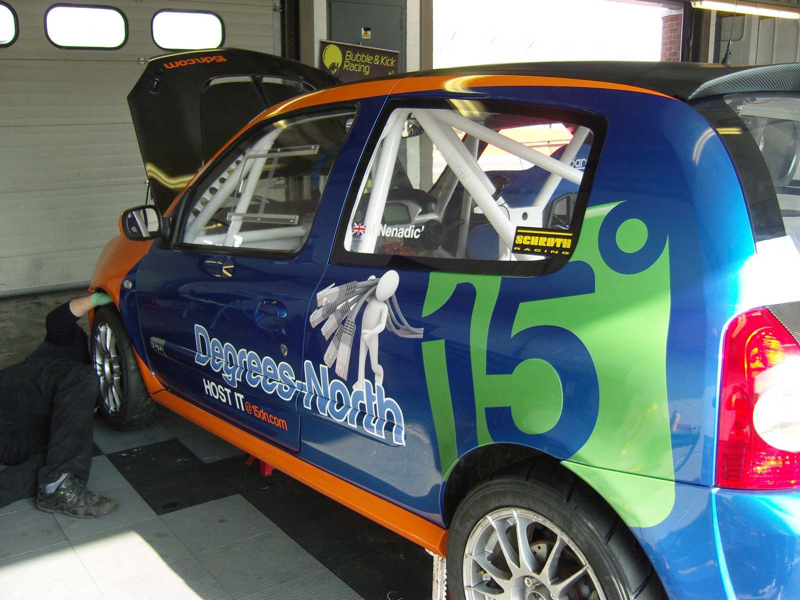

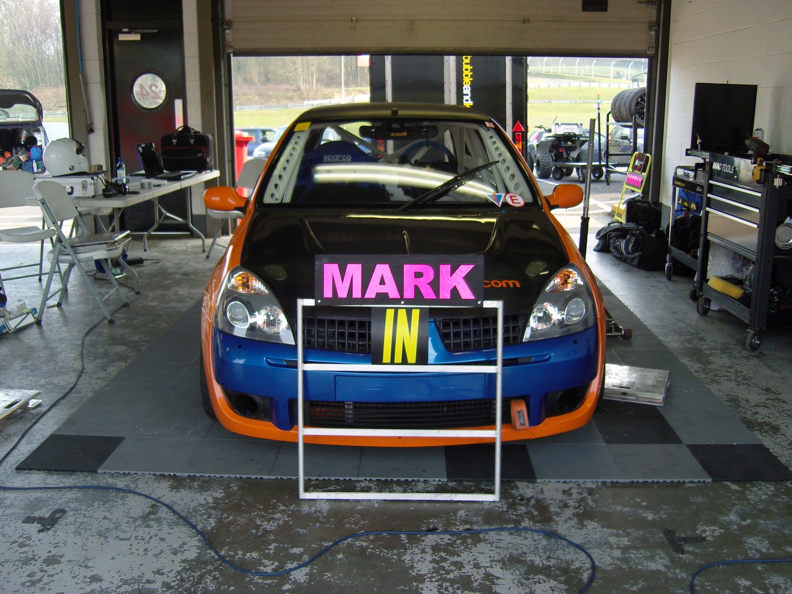

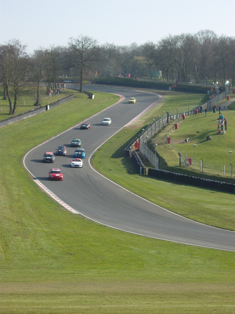

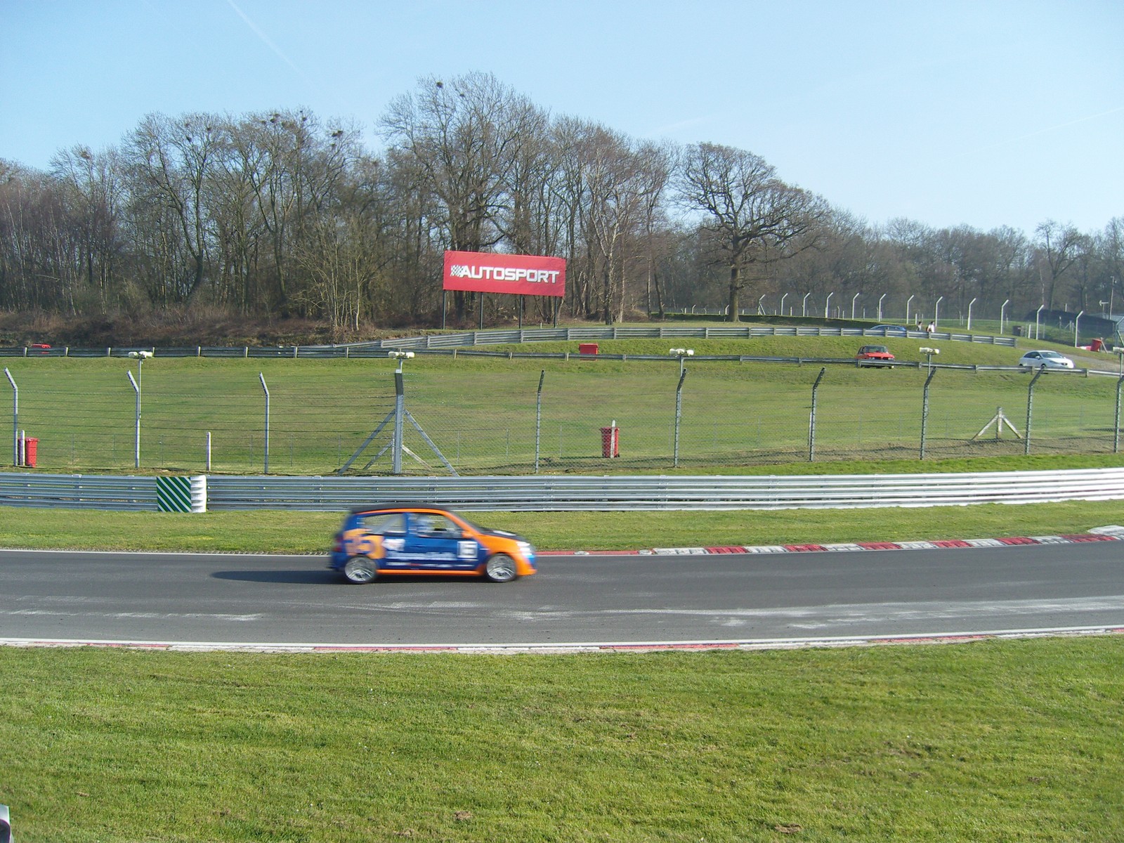

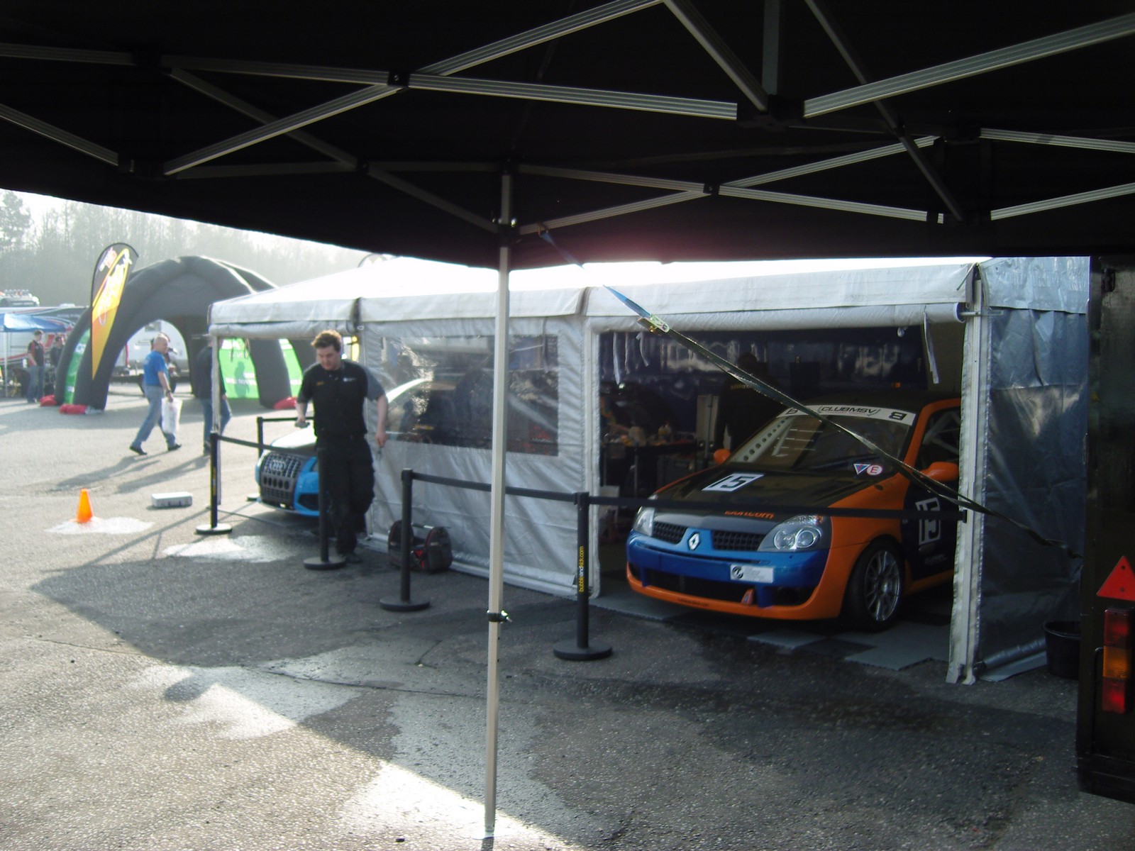

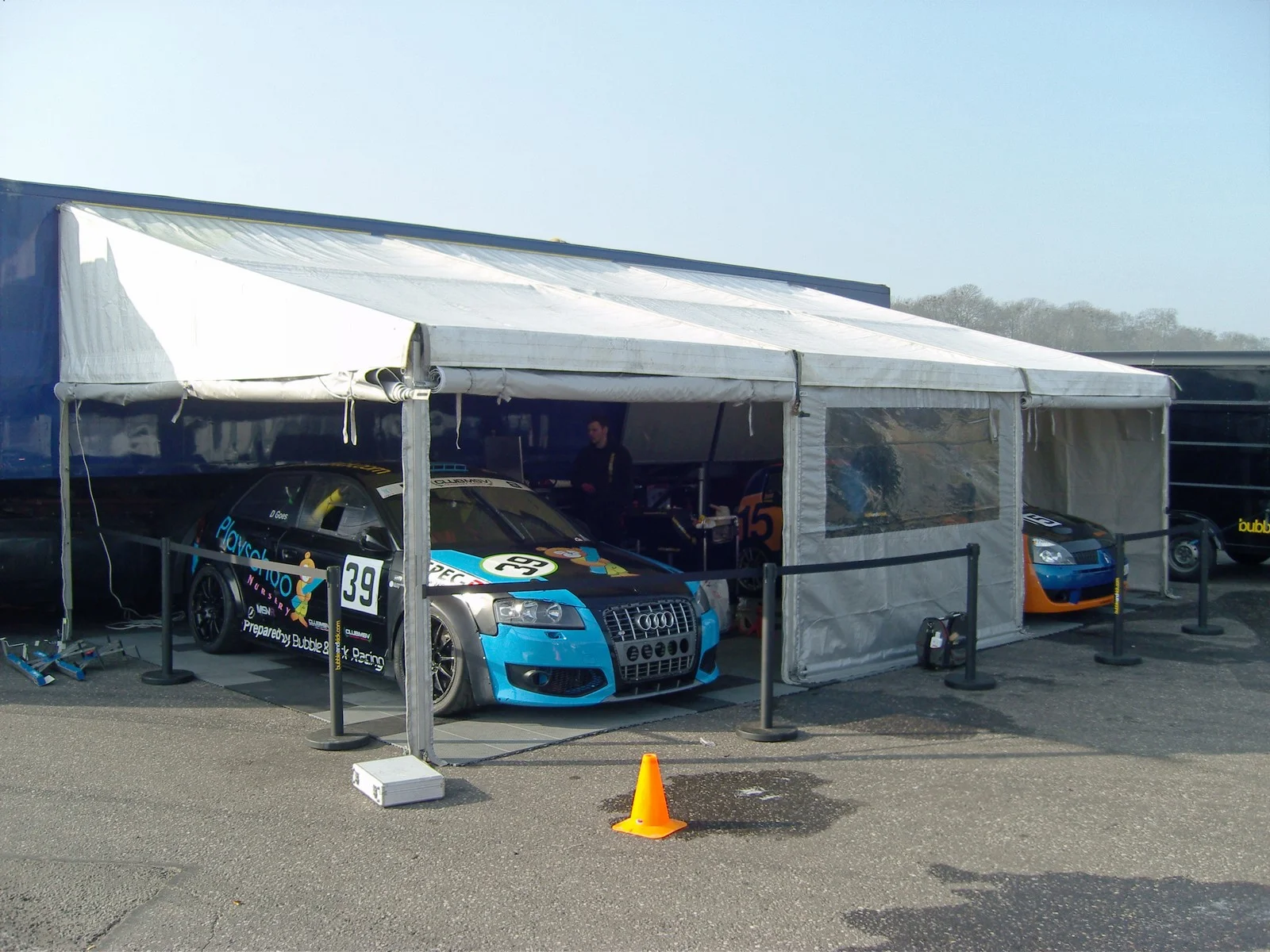

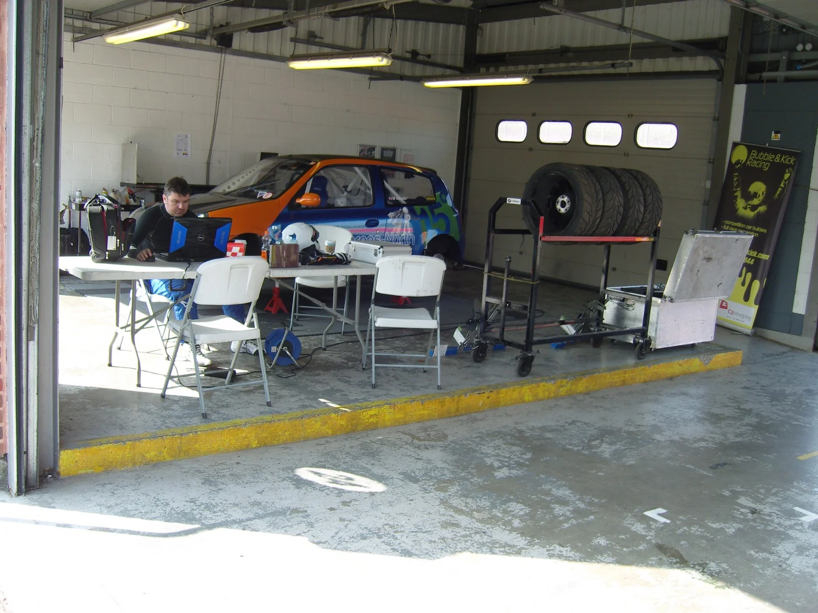

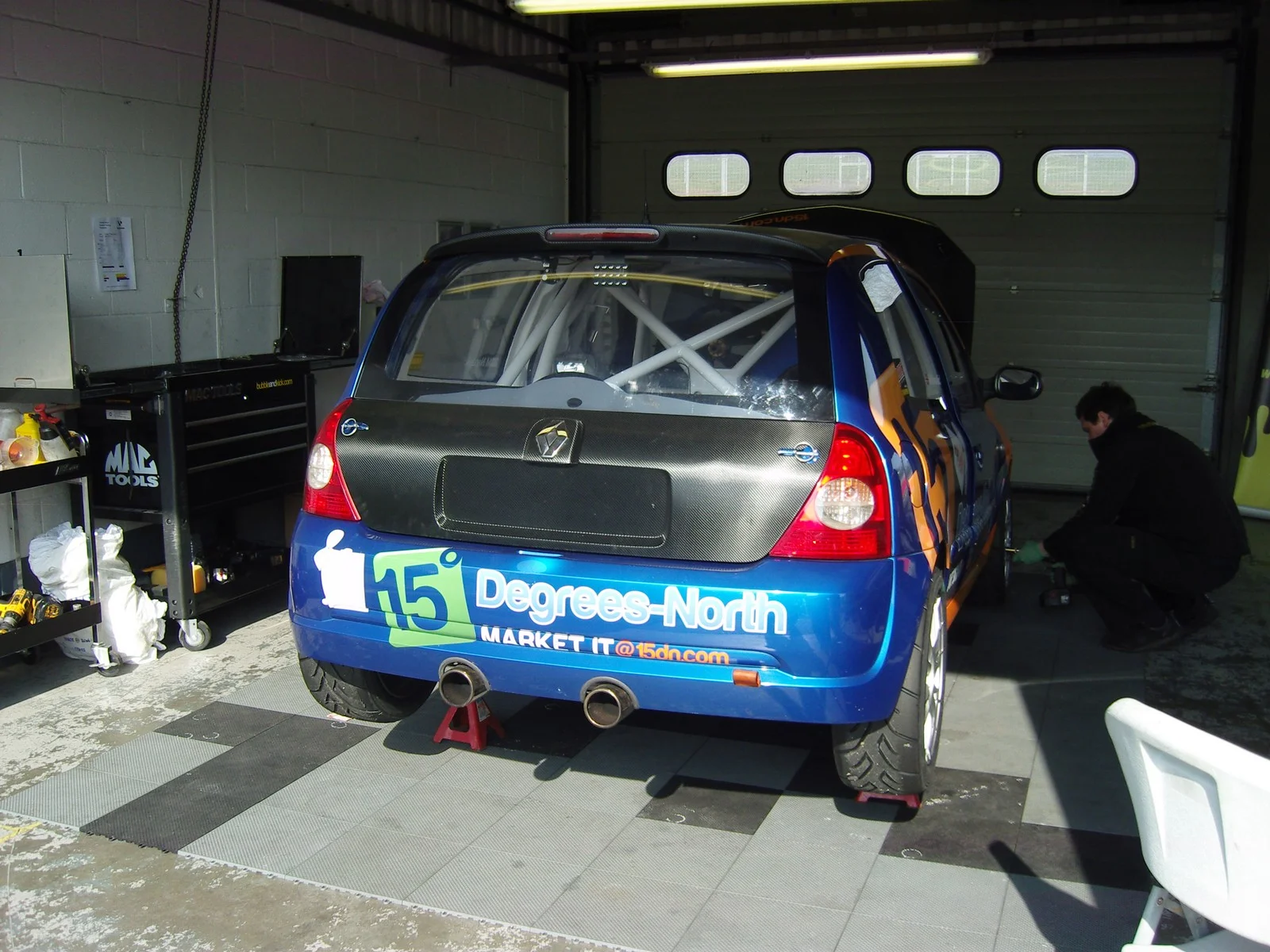

I just remembered I have not posted any pics of race day at all LOL. OK here are some plus some others after my investigation in my garage this weekend into my off at Clearways and then being dragged out the gravel sideways.

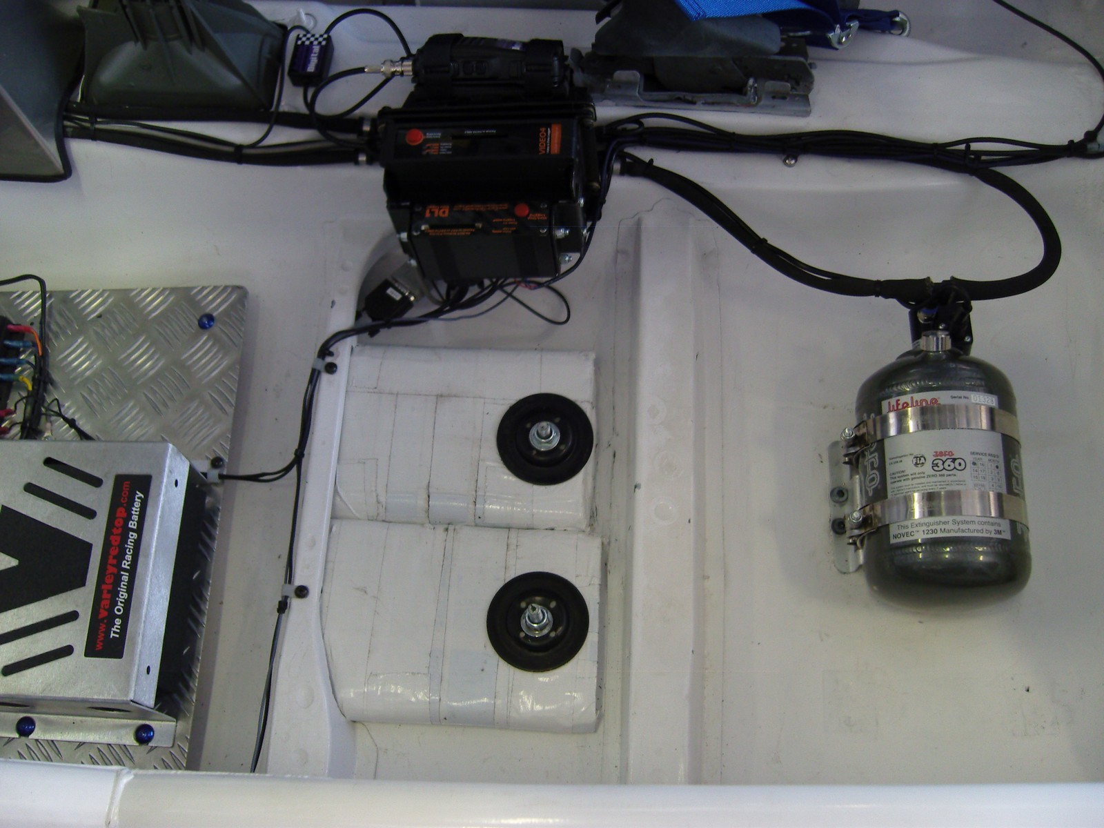

My damned ballast!!!
Assorted supporters
This is what you look like after a race :)

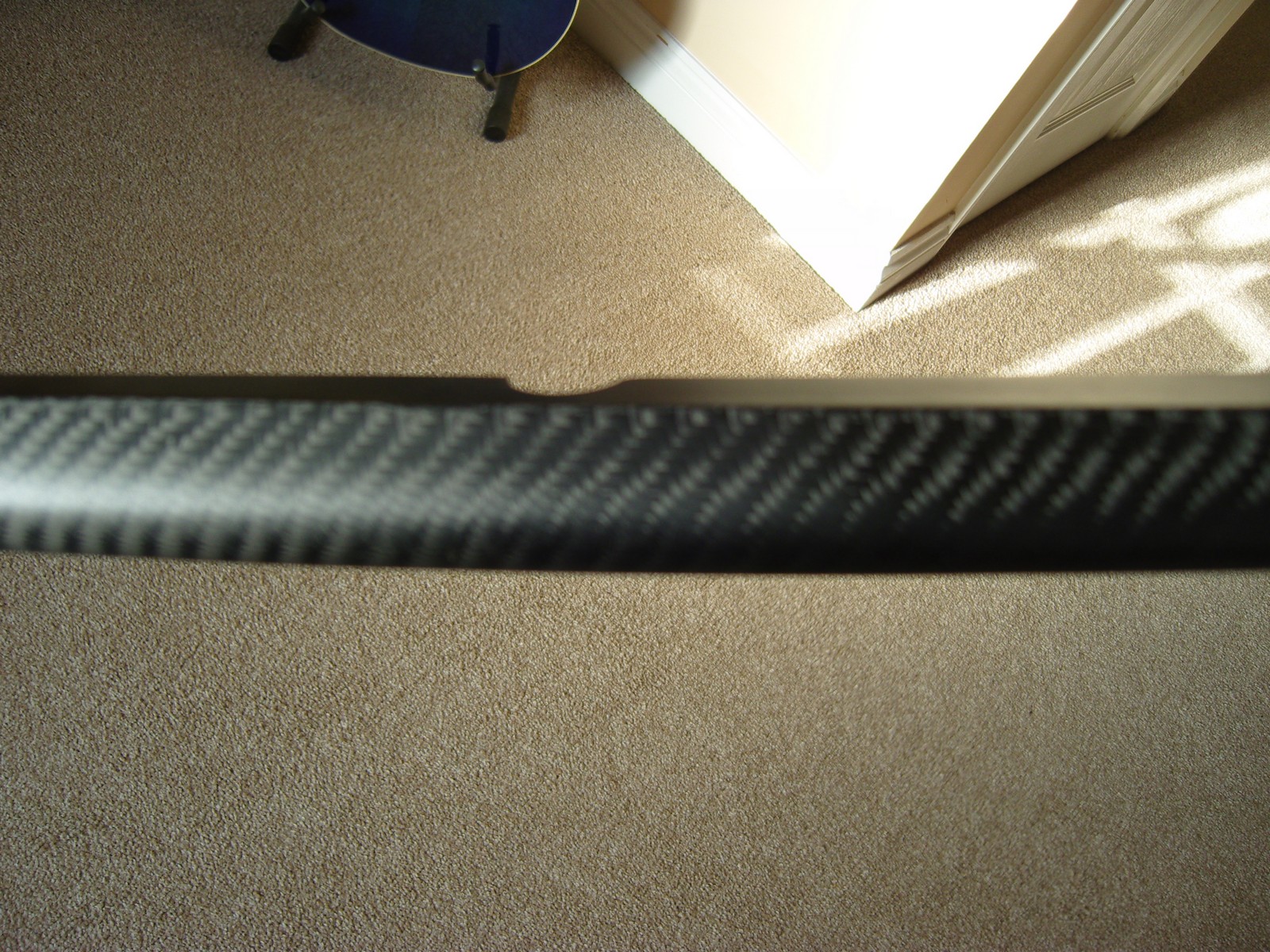

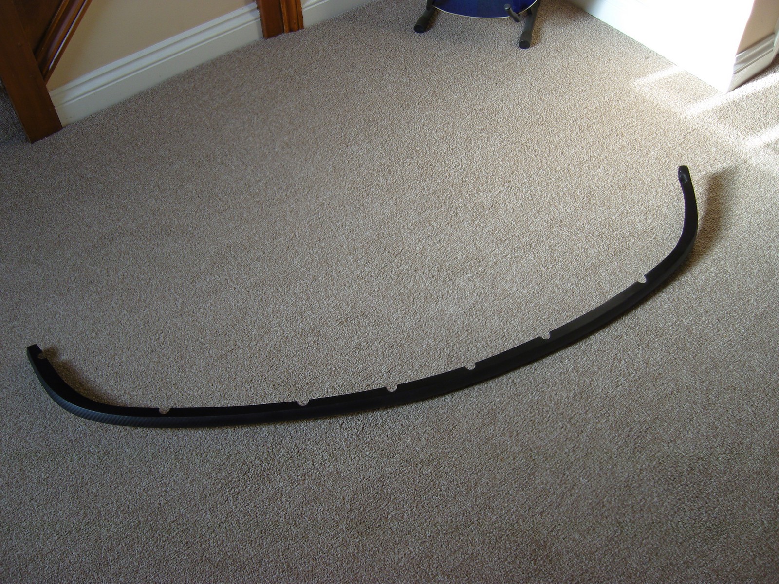

Going to fit this carbon splitter to the front as it looks nice :)

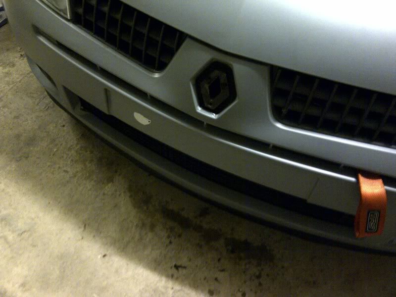

Must move this tow strap so that does nto happen again

Thats a bit of a shame about the front bumper! Where do you think you'll move it to?

ideally it needs to be in the middle?

I got towed sideways the other day at Brands and luckily it hasn't damaged the bumper after seeing you photos though i'm going to cut the little upright from the left hand side of my tow point! This is where we mounted mine

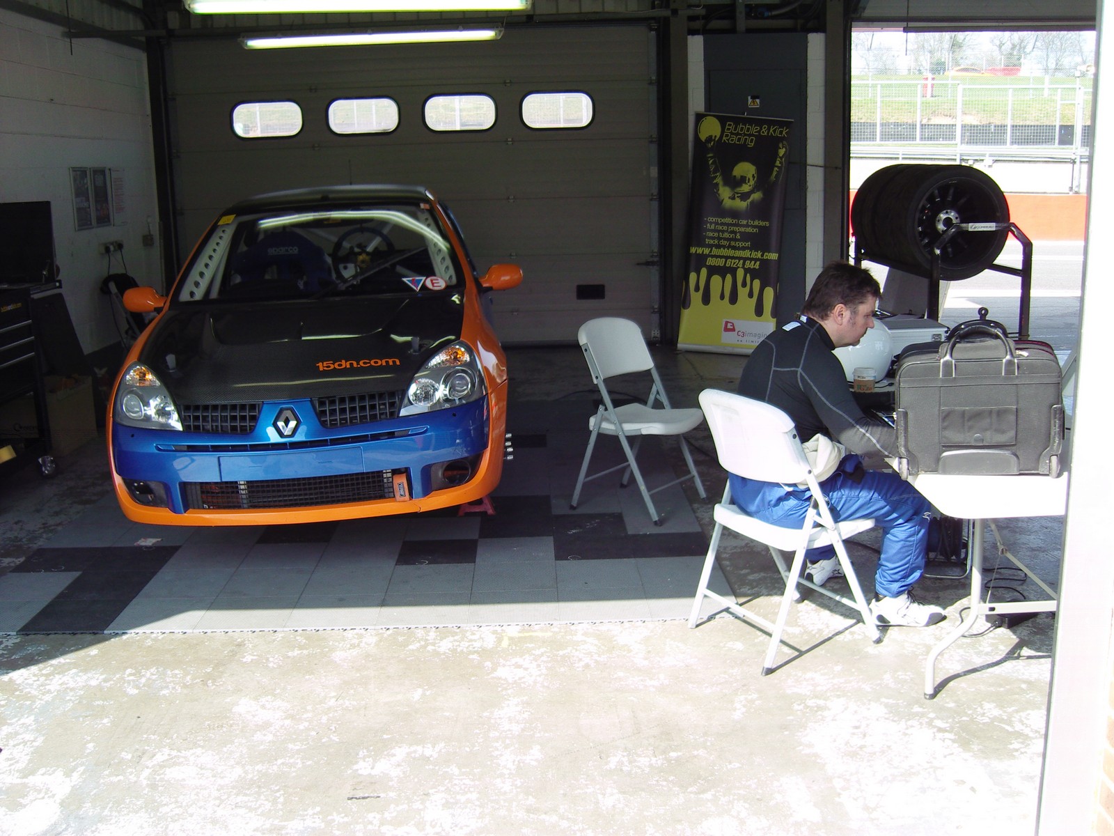

For Race support they are totally great as you can see from their setup. Living in Switzerland I just have not the time to drag the car around and do all the unpacking etc so for that they are perfect for me.
As for work on the car I get them to do small things but as I am such an OCD perfectionist large jobs I do myself at home and they drop the car off. Why would I pay someone ££ to change my flywheel when i can do it myself is my motto. To be honest I am not overly happy about anyone but me working on the car for obvious reasons. They are never going to do it just how I like or want it. Only Chrispy is really allowed to work on it unsupervised ;) and I had to train him in OCD LOL :banghead:

The carbon splitter will keep the bumper together nicely as its bolted on with 15 bolts and large washers along the bottom of it. It comes with self tappers as the fitting kit LOL. I shall move the tow strap to the left a bit so it does not foul anymore.

New bumper on order, this one has been glued and then bolted at the bottom with the splitter so quite ok now.
