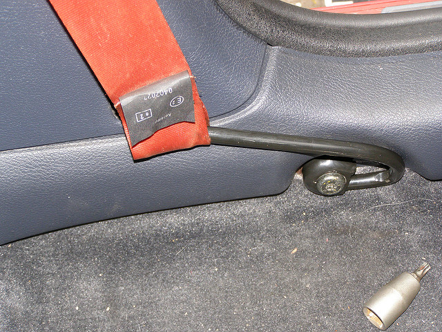

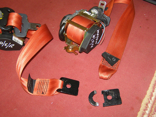

The first thing i noticed was at the bottom of the megane seatbelts the fastener was totally different. I know the clio had like a bar that the seatbelts slid up and down on and the megane just had a buckle.
I set about cutting this buckle off as i thought it would slide over the bar like the standard clio belts did.

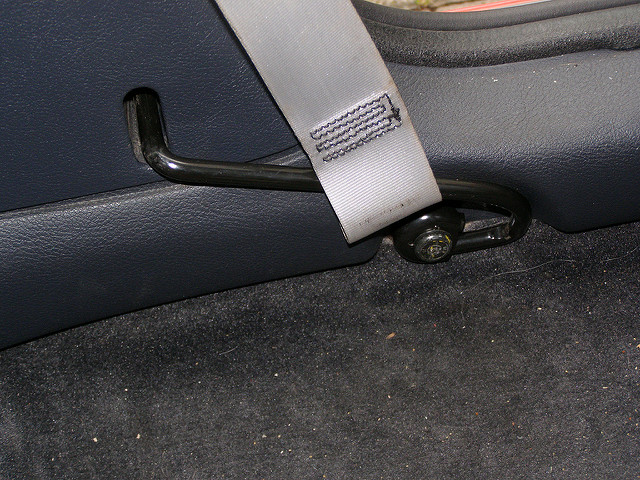

The Bar with standard clio belts on:
IT WORKED. Megane belts on!

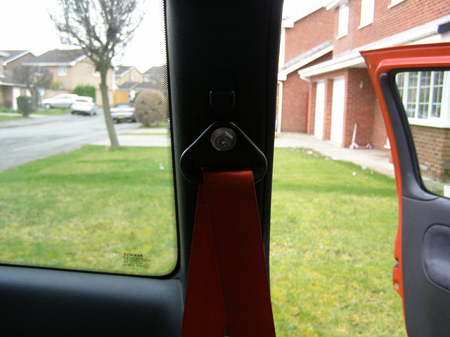

Next was fitting it 'bit that fastends to the door pillar' to the door pillar.

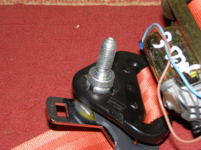

The bolt for the clio is really stubby, where as the megane one is quite a bit longer. I look at the back and noticed there where 2 little clips on it. (You can see the 2 little black clips)
So i carefully bent both clips and the bolt dropped out. I then did the same on the clio belts and got the bolt from that, and pushed it into the megane one. Fitted perfectly.
So i bolted that on.

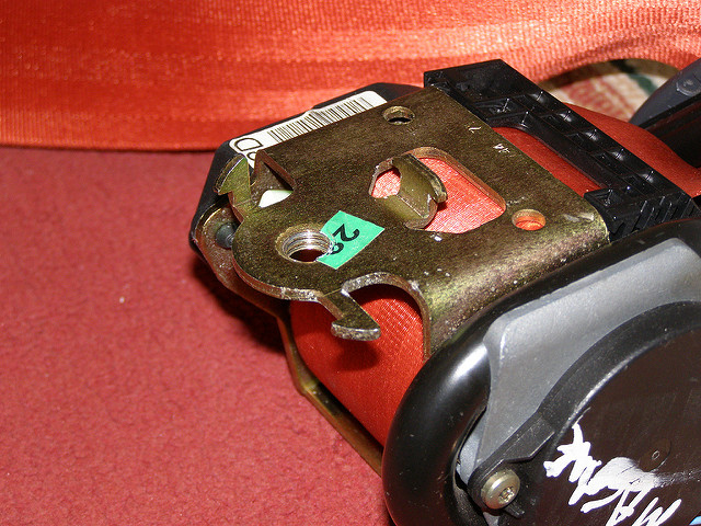

Right. If you look at the picture above, this is the megane seatbelt.
On the megane, im assuming that there was a bolt which screwed into the tapped hole and went into the chassis. On the clio. This is not the same.
There is a bit of metal, around 10cm long which bolts into the chassis further down and then the other end of it is onto the seat belt mechanism.
So i undid this and where it connected to the seatbelt mechanism on the clio was a big old school rivet.
I got a 6MM drill bit and drilled the old rivet out so i could get this piece of metal.
I then got some 10MM hign tensile rivets and dug out my rivet gun. (It needed some WD40. HAA)
I got a 10MM drill bit and drilled the tapped bits out of the megane mechanism so it was nice and smooth, then i placed both bits of metal together and wacked the rivet in. Then just put the bolt back in the bottom of the bracket and put this into the clio chassis.

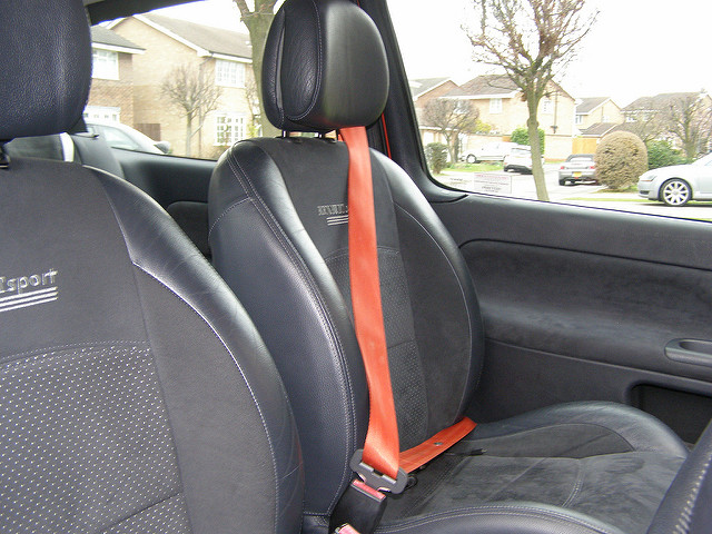

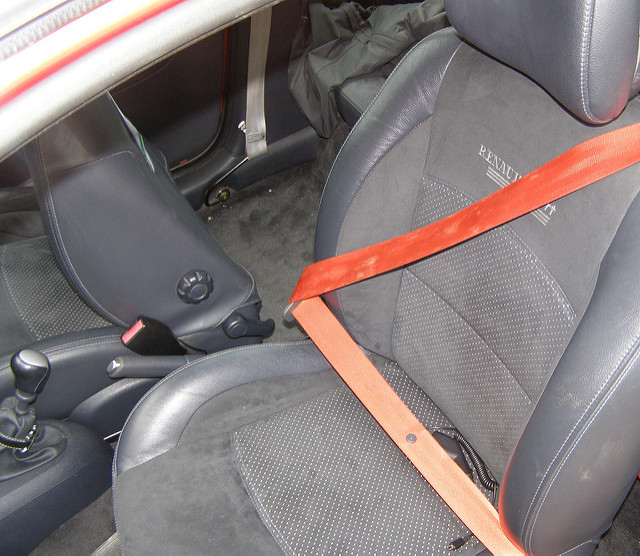

The Finished Item
Well, overall im really happy with the seatbelts. I need to clean them up a bit more.. (Anyone know what i can use to get a good clean finish ??)
Heres the pictures.
Well. Im BUZZING i finally got them in. I hope you guys like.
Any questions fire them over!
Thanks, Sam!!
