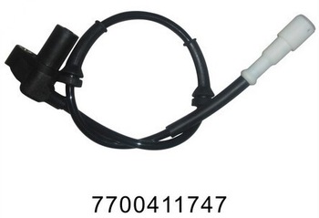

Need to get a new abs sensor for it too as that was literally stuck in the hub, had to cut the top off and smash the innards out with a hammer and punch
  PH2 172

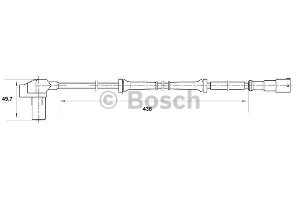

182 Front ABS sensor should have 2 female pins Bosch 0265 006383, oe 7700411745, about £30 on eBay.

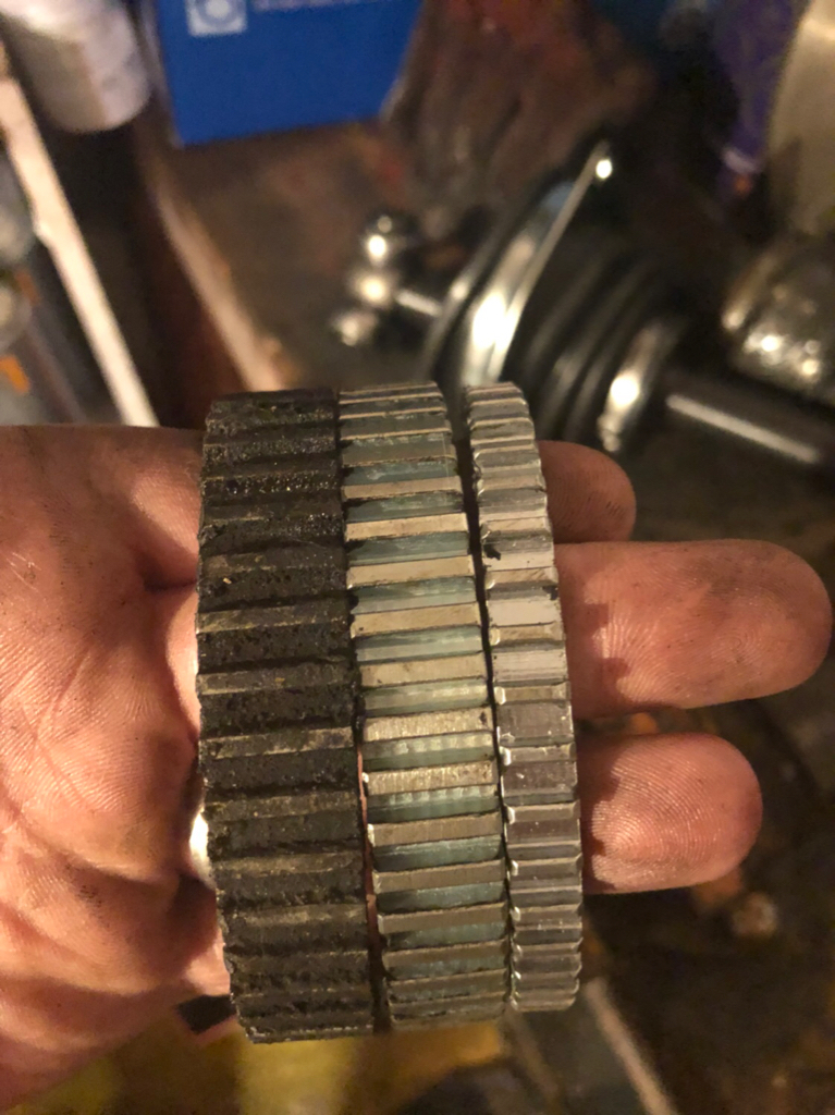

Well it’s arrived and seems to fit the hub which is good. The abs ring is a lot thinner than standard but has the correct amount of teeth at least, the other ring looks the same width but far more teeth. No point me fitting it yet as my gearbox oil order hasn’t shown up so I’ll just wait until it shows up. Would like get it fitted before the snow hits though - do not want to be freezing when doing it
  Inferno 182 & Saxo
Just having a look at the abs rings now, the number of teeth match just fine yet the ring itself is much narrower than the standard one (probably about a third of the width).
The ring with more teeth (which I assume is for other variants of the car) is wider but still not as wide as the standard/Renault item.
Has anyone fitted it with the supplied thin abs ring and it worked fine? I’d rather not get it all together and find the abs is throwing a wobbly as the hall sensor can’t see the ring.
Suppose I could tap on the old abs ring if all else fails...
  Inferno 182 & Saxo
For future reference or those who might be curious - from the right
what came on the drive shaft so the thinnest ring same number of teeth as original,
Middle is the spare ring supplied by j and r - incorrect amount of teeth for my car but wider than the ring on the shaft
Far left and dirty is your standard abs ring from a genuine Renault shaft
