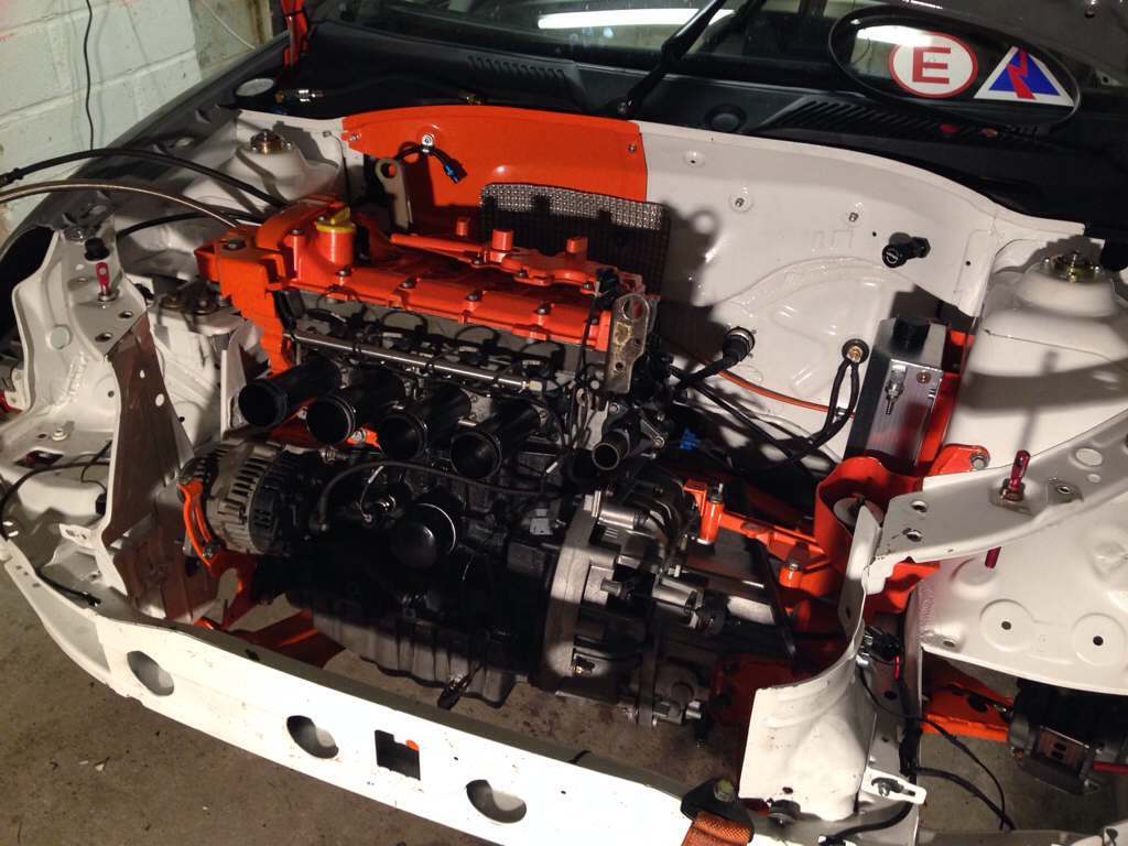

Just got in from work and tomorrow is my only day off before Donington so the car is booked in at 2.30 for the geo doing! The car is currently still in a million bits with the gearbox and engine removed! Massive thanks to Fred for building the engine on Wednesday as a bit of a rush job! I am just heading down to the garage for what I think will be a very late night :( I'm already shattered!
Proper update will happen during the week if I get time!
Thanks
James :)

Realised I don't have any oil so not going to be able to fire it up and also don't have any fueling/knock stuff at home so probably not really safe to run the engine for long. Might have to cancel the geo and have a lay in lol
Have you adjusted the cam timing atall? If not you should be fine to do a start and low engine speed without the issue of det, it can't be *that* different to the last engine to cause det.

Dan, the reason he is worried about knock is the new lump is higher CR, although Im sure his current one isnt mapped right to the edge of det on tickover anyway TBH.

Yes cam timing has been changed along with a slight change in CR as chip has said.

Yes I think it will be okay at tick over but it would be nice to have a proper drive and check everything is okay.

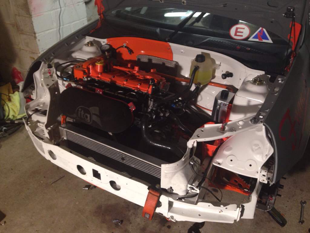

So all done and ready to fire up and the starter is dead :( so annoying! Thankfully I have a spare so will swap that over after I've eaten some dinner.
I've found and had to replace a damaged driveshaft and also an upper engine mount but thankfully had them all in 'stock' as spares.
I told you them modified hubs were s**t didn't I. I just can't believe that everything else around them got damaged pretty much, but yet they came out of it all unscathed. What an utterly pointless modification they were. You should've known better mangina.
