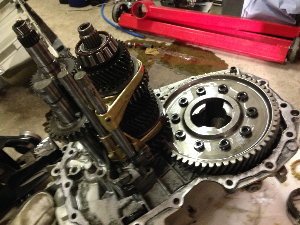

Had a few hours this afternoon and wanted to learn about the JC5 so took my knackered one apart
Had a few issues with the selectors but other than that not too bad. The diff does seem quite stiff in the bearings. Does anyone know the big nut size so I can remove the diff? I have bought a 182 gearbox so I am planning on getting that built up by gripper themselves over winter and then after Donington I will choose which box I prefer and stick with that one and sell the other I think :)

I think it is 50mm (that was on a laguna box though so could be different). The one I bought was too wide to get into the recess though. Not solved that issue yet but may just thin the socket with my grinder lol.
  clio cup
Yes, it's 50mm, you'll need a deep socket and may need to grind the outside of the socket down to slip into the recess,
When building mine, it's not the diff that's the issue as its not sandwiched between the casings, it just sits it the bearing, just make sure to torque setting is right.
The issue is when changing the ratios as to achieve this the crown wheel and pinion need to be changed, only way to do this is to machine a new main shaft. This shaft is sandwiched between the casings with a bearing each end, too much load on these bearings will cause issues with heat and wear!
There wasn't a shim available from Renault thin enough to get my box right so after measuring the end float and taking the shim and my measurement to a very good engineer it was machined down with consideration to expansion of casing and mainshaft.

That would explain the issues then as I couldn't understand how the diff itself where it is bolted in could cause my issues. I presume the main shaft is the one that goes out of the main casing and has 5th gear bolted onto the end of it (The one with the pinion at the end)?

The JC5 box is probably most complex selector wise, Everything else is pretty much standard engineering through manufacturers.
Main shaft is the one fith gear bolts onto, below that bearing you see in your pic james is a shim, As you bolt the casings together this is where you will find pressure build up, too tight and it will cause issues with heat,

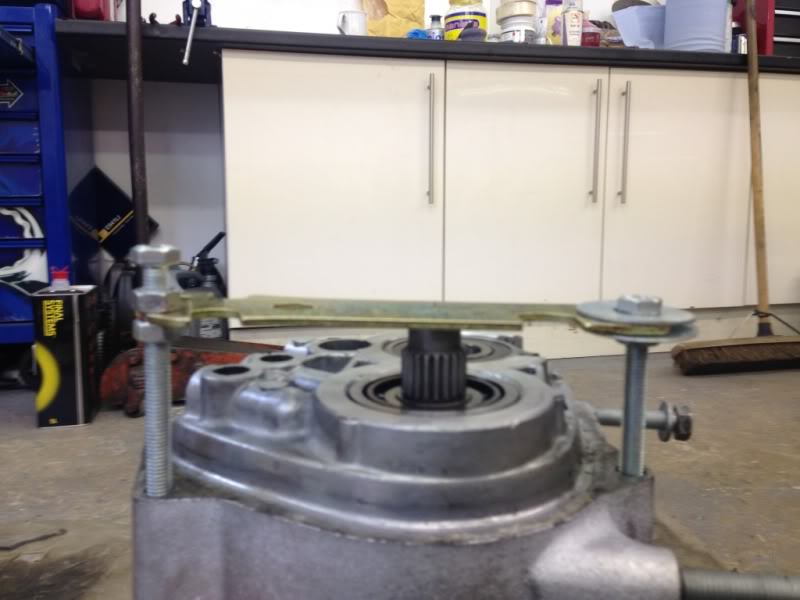

Below is a pic of how I measured the end float, fit mainshaft into casing with out shim, lift mainshaft with pliers and adjust measuremnt plate so it touches the end of the mainshaft, Drop the mainshaft and measure the gap with feeler gauges, repeat five times, make a note of all measurements and take the average,
Your engineer will then need his knowledge and experience to machine a shim to the correct size.

Thanks for the explanation Dave now I understand it! The main shaft was quite hard to turn so maybe that was the problem

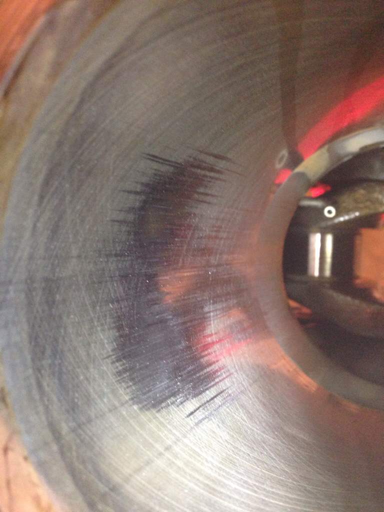

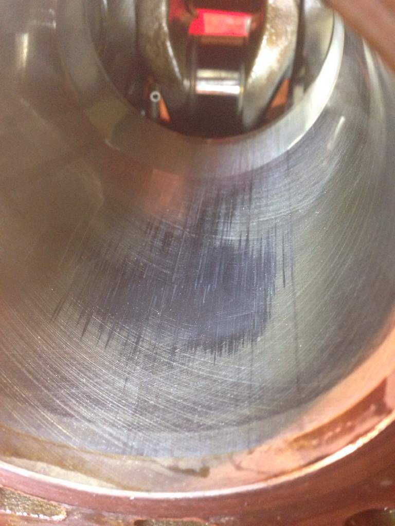

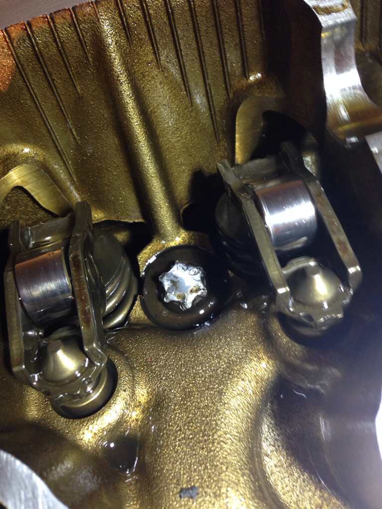

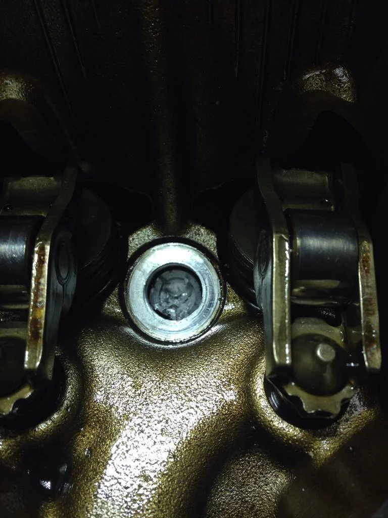

Spent most of the afternoon stripping the engine down. 2 headbolts sheared so ended up having to drill them out :(
I thought it was a broken ringland on one of the pistons but it turns out they were all okay. What it was though is it seems the pistons have been slapping around in the bores as there is scoring and a polished area in the bores. Which obviously stops the rings from sealing as effectively.

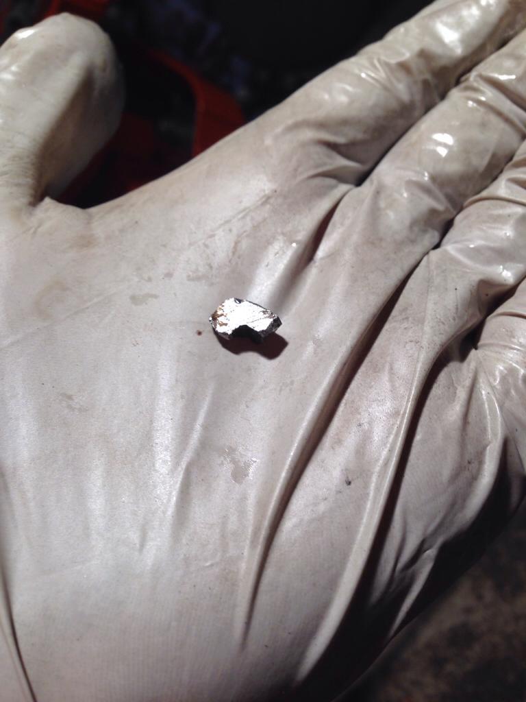

Then found a decent size chunk of metal in the oil pick up which was worrying but can't for the life of me see where it's come from
This puts a spanner in the works as the plan was to do a quick glaze bust and chuck a set of 82.7mm pistons with new rings. I have got another engine at Fred's which he is going to check for me and Chip has also very kindly offered a block so hopefully we can get sorted out :)
I'd strongly recommend going oversize to get the correct clearance, new pistons/rings in old bores with just a hone is a bodge, it will almost always end with early wear and short life expectancy.
Yes Sandy I agree but this is just a solution to get me out for Donington and then over winter an engine will be getting built when we have time for machining etc :)
Obviously that block is no use for a quick hone so I need to find a very good block otherwise as you say its a bit pointless.
What causes that then? The bores in my original 140k engine looked fine.
I'm not too sure myself I guess its the high rpm and mine somehow saw 8200rpm at Oulton on the test day
