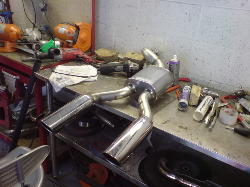

Ended up doing a more basic type system using 2 x small resonator silencers Aero AR25s and then into a Custom Silenced Y pipe (made from our Aero Stealth 156 silencer......then the two tips.... No big back box's as such.
Anyway Matt has some pictures of it and Im sure he will post them up....
It does sound well :)
Oooh Tips are 3.5" Slash cut rolled end and there 12" long (Room for a little resonator silencer inside them if needs be.

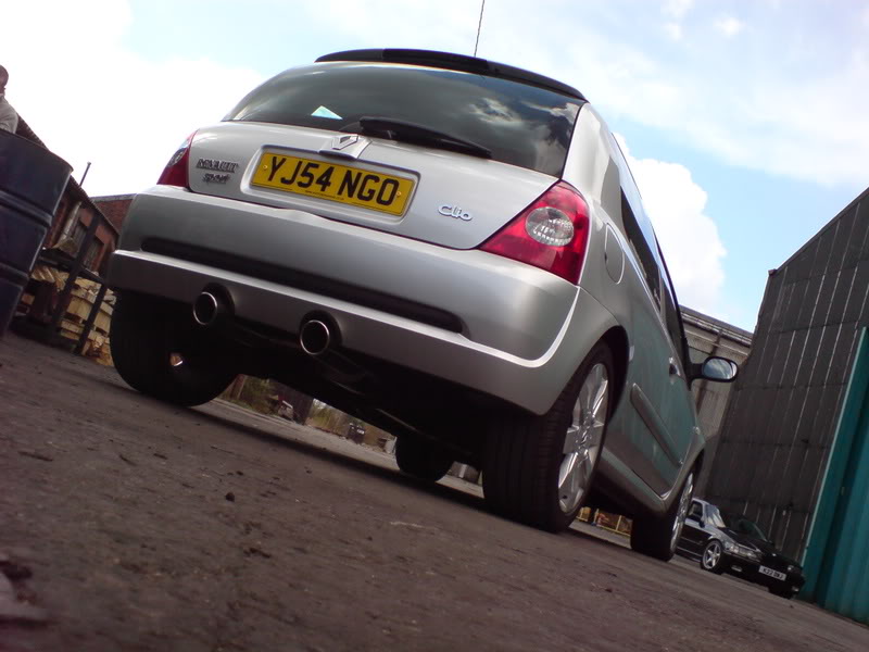

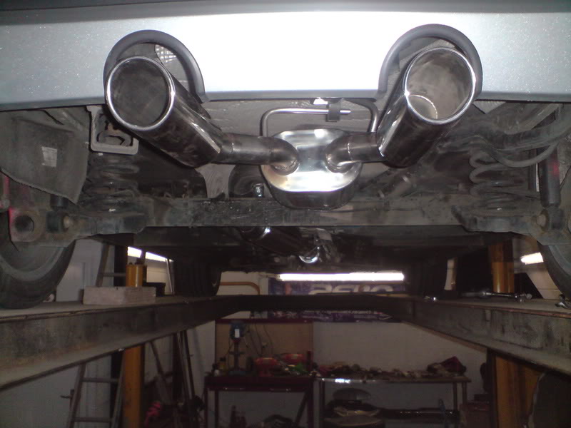

hello yes my exhaust was done yesterday to the highest possible standard. extremely happy with the end result, the car feels alot more responsive in all gears and really does want to rev now. very happy indeed :)
as we speak i am uploading a couple of pics although a friend has the best pictures and most of them. tried doing a soundclip but mobile phone quality is pants so i'd rather get one done with a proper camera :)
anyway ill upload them now...

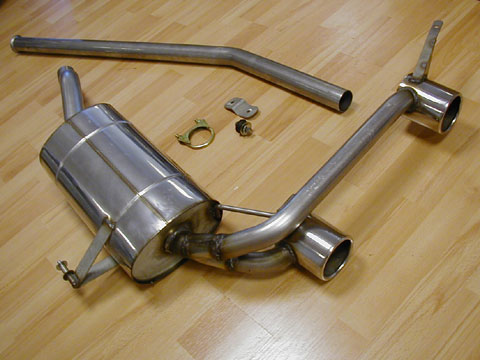

heres a pic to give you and idea, how much roughly would it be, back box only.
Jim....... On tuesday this week I will be starting a project like this system you posted... A local garage that produces the V6 body Kit needs me to make a system just like this ... I'll post pictures when its done

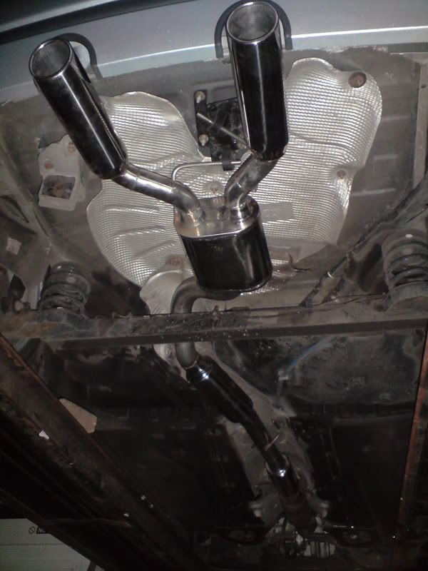

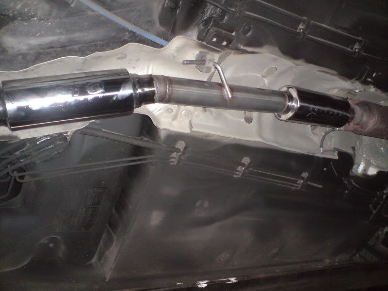

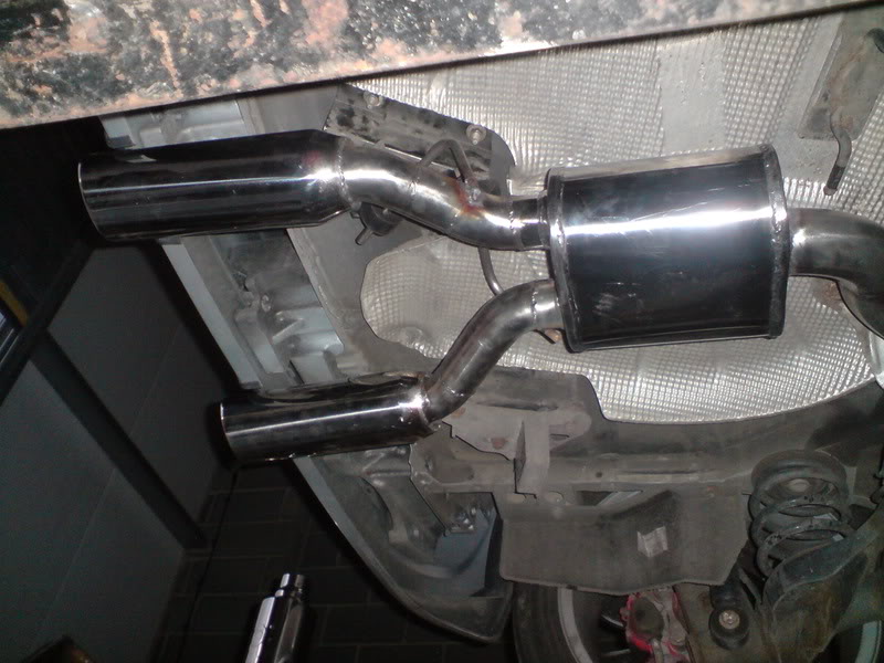

ok only got a couple of shots, this is my back box;

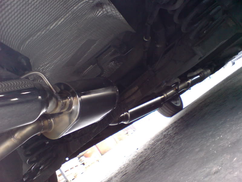

centre section under the car;

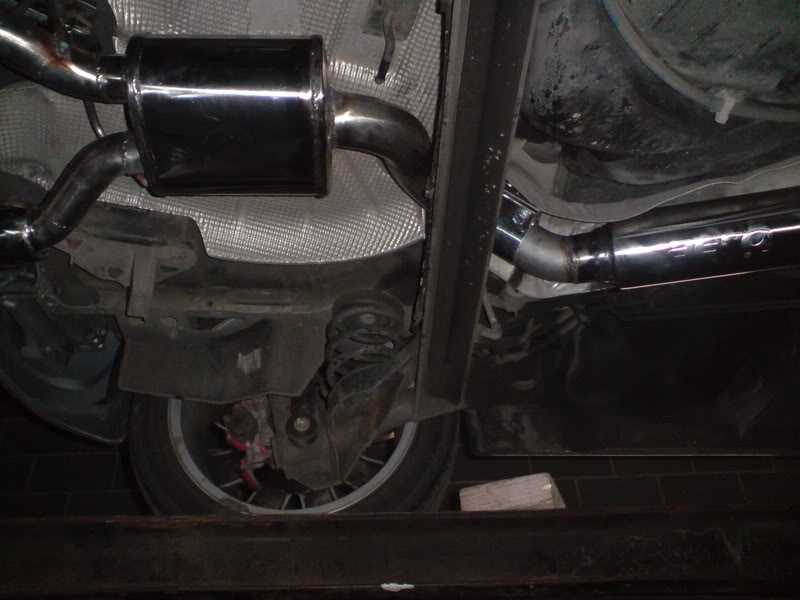

back of the car;
will post the best pics up when i receive them :)

lol those silencers are awesome, dont really quiet it but just make it sound damn good, fantastic components used and end result is brilliant, though i think the standard cat-centre section join needs looking at.
93.8 db is a lot quieter than the 107db we had before the Y pipe box went in..lol
And that FRENCH Exhaust joint needs a new V band around the outside
  2002 172
yeah ill get a new 58mm clamp tomorrow at work, though i think we may ahve to just cut the flanges off and weld in a bit of pipe, but keep the cat in as i like it how it is :)

the system does have 3 silencers, though my back box was modified as we were going to go with a different design. the full silencer should be ok to use with the tips that arent as long as the ones i have. mine is loud, 93db. on overrun it does make your ears ring lol, sounds absolutely gorgeous on acceleration. i need to find someone with a good quality video camera to do some clips for me.

looks really good chaps, too many silencers IMO, and the rear one is tiny with MASSIVELY long tail pipes! but i'm impressed which is rare for me to say!
