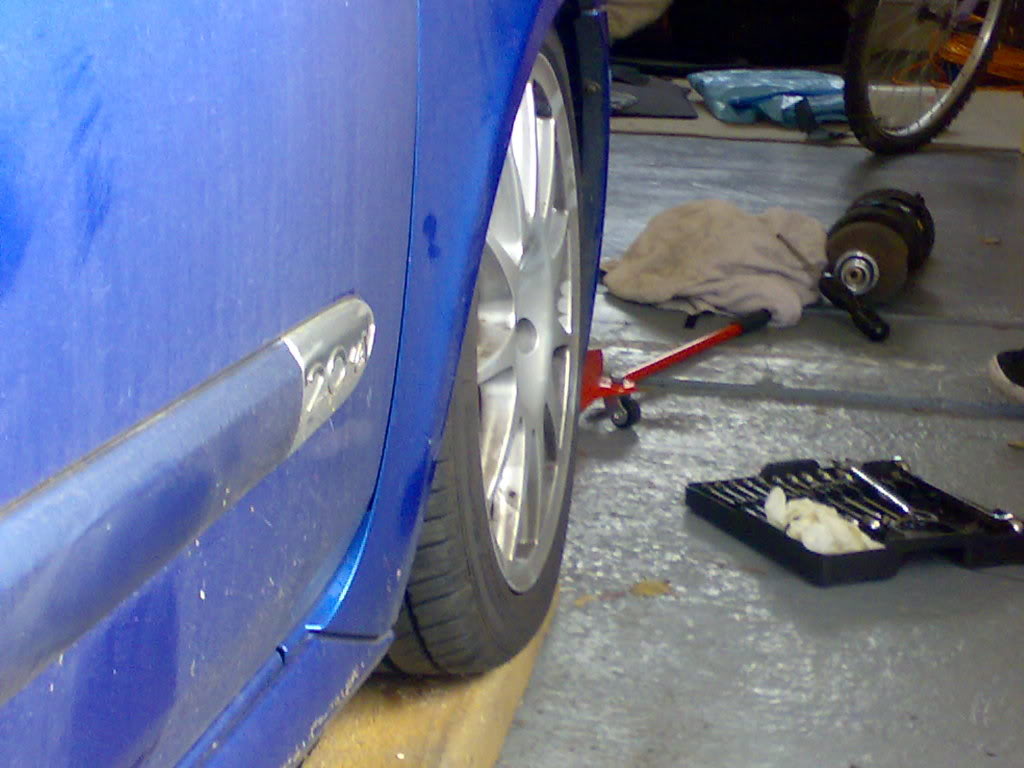

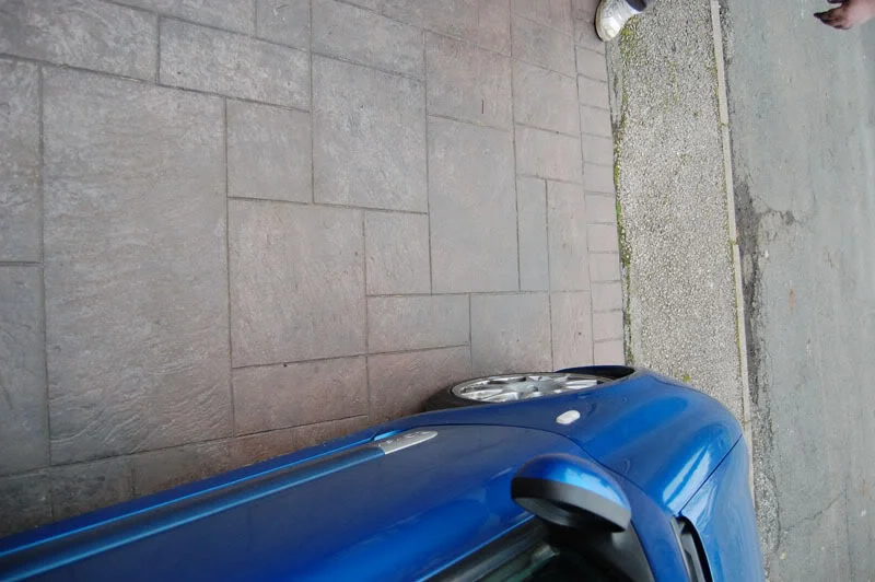

Norm wanted to see what max camber looks like:

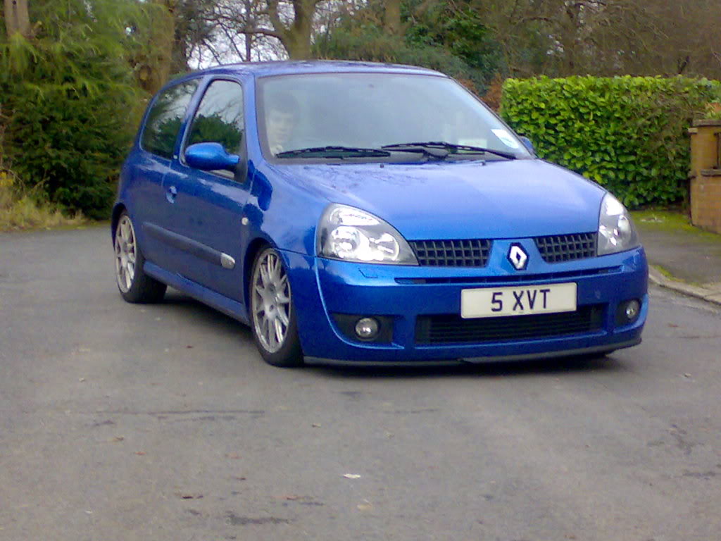

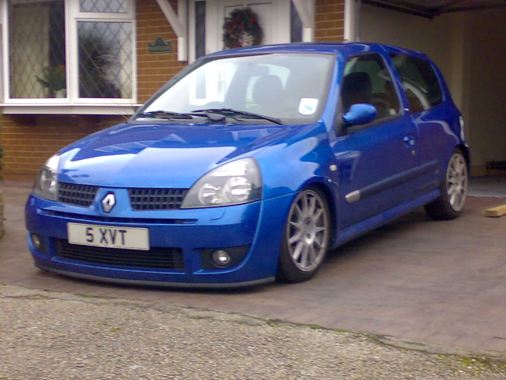

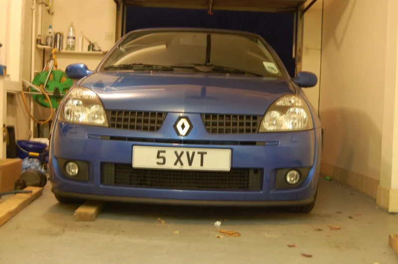

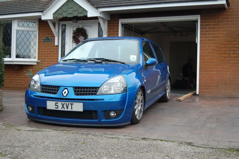

Its now at this height with reduced camber:
but scrubs on full lock so might have to remove the liners, otherwise its f**king mint drive!

Looks mint!! What are the topmounts like? PMSL at cling film Norman, looks like a massive caterpiller!

mint mate! I've set them for castor over camber now as Curtis said on a road car it'll be better.
Can still adjust camber on the elongated holes anyway :)

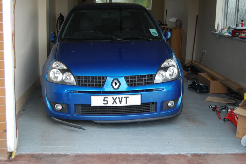

few pics i took along the way!
Front done.......
One side done.......with a P3wnd splitter!!!
All done- the way i liked it!!!!

IMO, too low. Looks broken!
its not that low now anyway :rasp:
its so low I lost me splitter on my own drive!

I still don't understand what this does? Surely having less rubber in contact with the road is a bad thing? and in the wet the tyre can't do what it's supposed to do? i.e. channel water away from the contact patches?
Basically mate running say 0 degree camber, under fast cornering the car leans, taking part of the tyre off the road, less rubber = less grip!
So giving it some (iirc) negative camber, in a straight line yes there is slightly less tyre on the road but under cornering you will get the whole or more of the tyre on the road, more rubber = more grip
Thats just a basic way of putting it mate.
