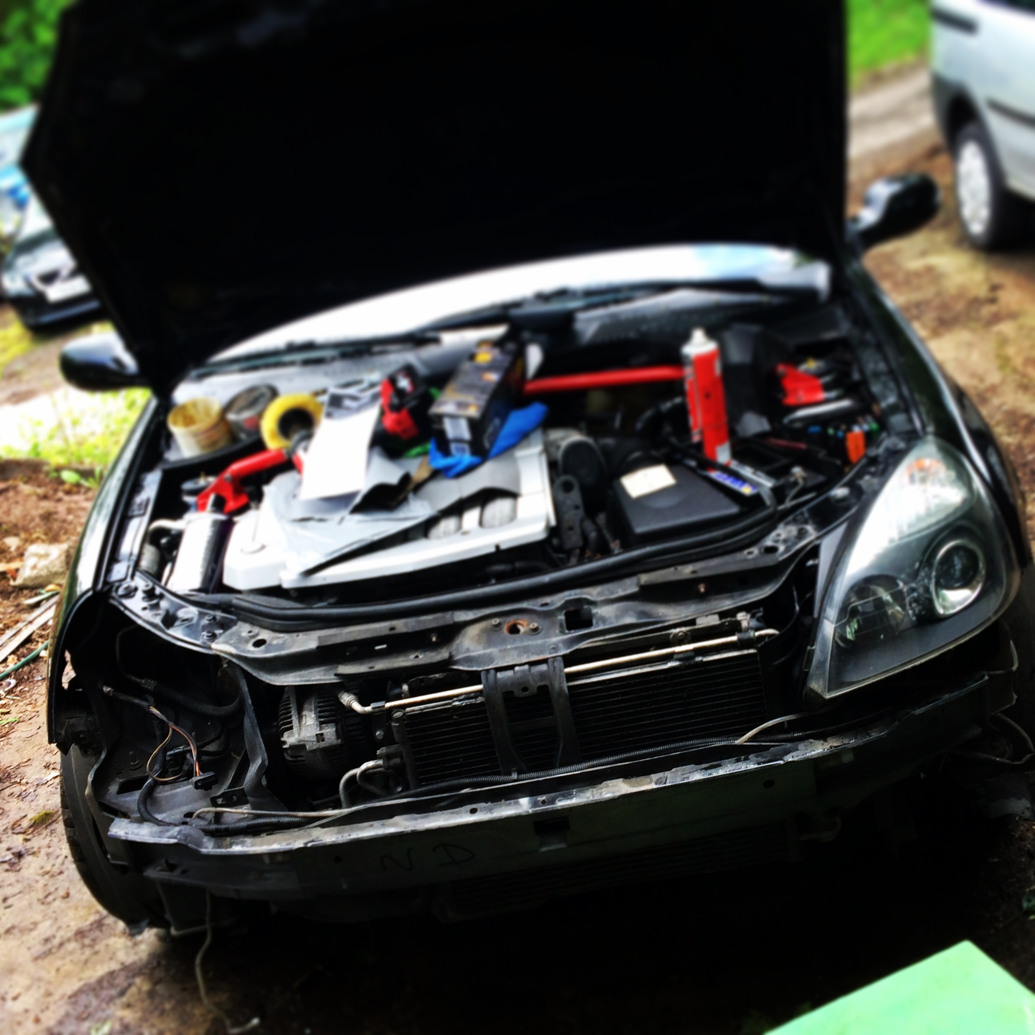

just had this problem on my 182, you've tested the bulb, first check the fuses, next i would swap the ignitor to the opposite side and check that. lastly swap the whole lamp units over to test the ballast packs.
i was lucky and it was just an ignitor. simple fix. especially when i had the bumper stripped anyhow. :) IMG_4423.JPG
