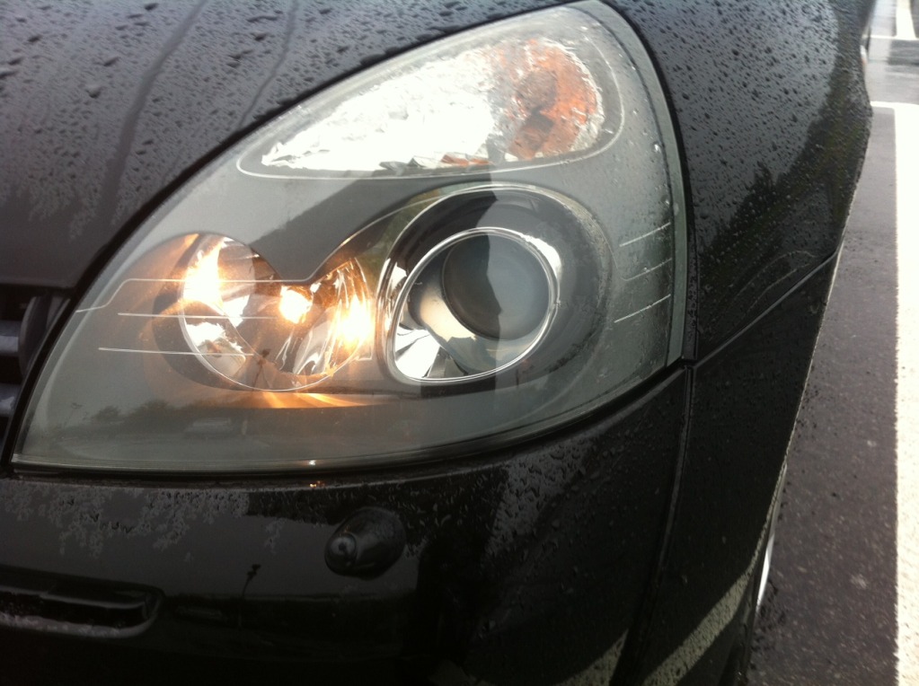

I finally got time to change out my bulbs earlier today.
Good news: it was the xenon bulb that went and not the ballast :cool:
The LED sidelights looks slightly green in the picture but they are white to the naked eye.
The 5000k dipped beams are great. Noticeable increase in brightness compared to my old bulbs although the one on the passenger side looks slightly more blue for some reason!

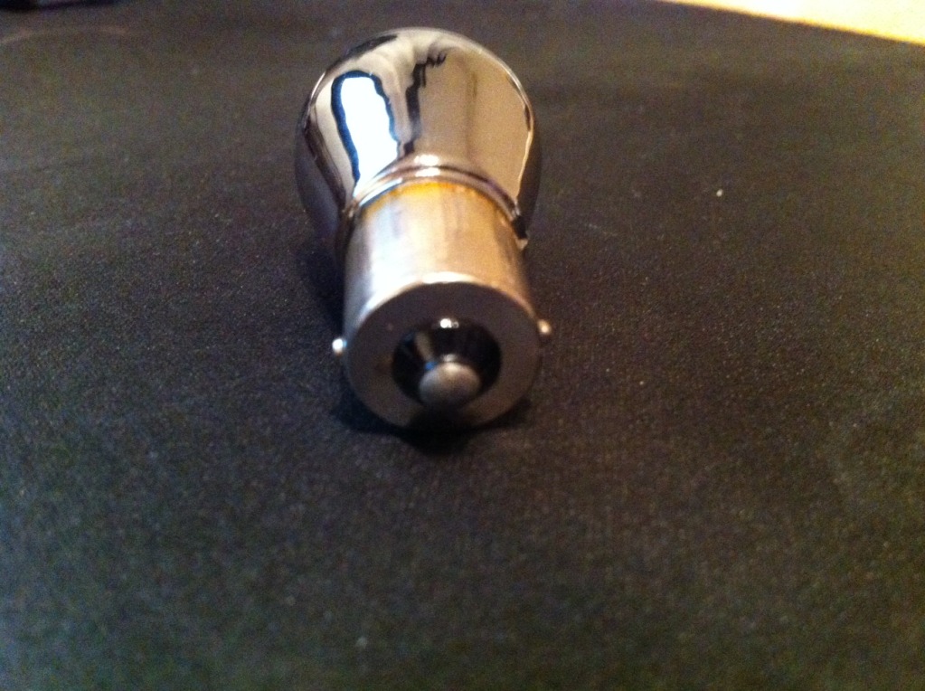

Bad news: Silver indicator bulbs dont have the correct pin alignment to fit in the bulb holder so im stuck with the regular ones for now. Anyone know a way around this or did i just get the wrong ones?
