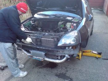

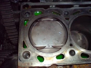

engine developed a little rattle so we decided to strip it down and find the fault.
first we took of the rocker cover etc to see if the lifters where ok.
first thought was that if i had to take the rooker cover off i would fit some cams.
found that the lifters where fine so next choice was to remove the head
so i am now thinking if i take the head off iam gioing to get the head gas flowed etc

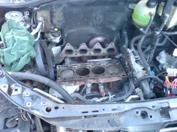

head off now then and we found some play on piston no 4. not good

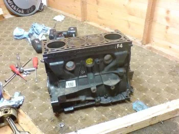

  clio 172 sport, zxr6

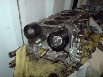

yeah think the 70bhp shot of nos has helped it on its way but i ran it for 2 years and this year i ran 2 bottles per 1/4 mile day
any way taken the block out now

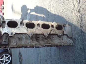

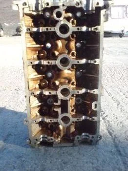

heres some more pics of the engine parts before they went off for the upgrade.

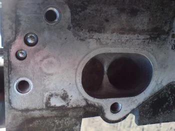

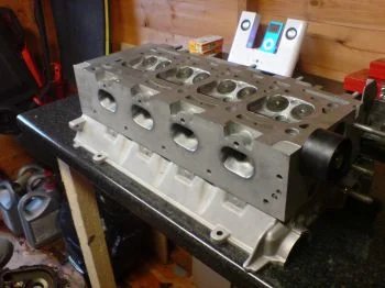

me and my m8 dean who works from renault are doing the strip down and refit then a local company in durham is doing the machining for me cleasby precision engineering 01913782407
hope they live up to there name :clown:
they are going to gas flow the head and do 3 angles valve seats,
they have also checked the block and recommened i get some over sized pistons so i oredered some high compression wossner forged pistons from
k-tec.

result the block, head and fly wheel are ready to be collected 2mora :clown:
so i will go pick it up and drop it off at my m8s for him to build it up ready for next sunday when he reckons he will have it back in. cams have come today as well so its coming all fine now

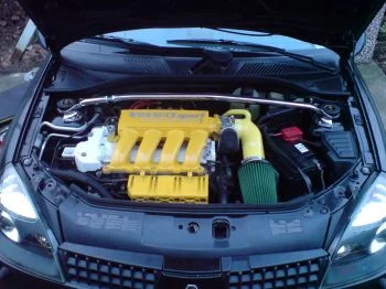

awesome
any vids of it? there is some vids from the fcs track time on you tube didnt get any from the 1/4 mile
what's the spec?
it was 172bhp before this work without nos
182 manifold, green filter, group n ecu, de cat, magnex full system exhaust, diy inlet manifold work,
with the nos it ran 240bhp but thats not going back in now cos iam going to do n/a now due to the cost of the nos refills plus it only ran around 1 sec faster with the nos on the 1/4 mile this year
13.2 with and 14.5 with out
track days are better as well better fun for your money

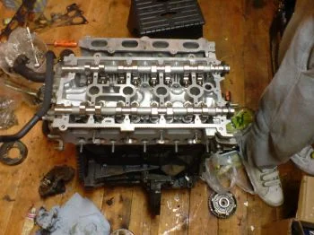

some more pics. still waiting to build it up and get it back in the car. will hopefully get it back in next weekend but who knows with the weather and with work commitments

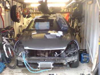

carnt wait to get it back on the road and also carnt wait to get the garage back car is blocked up at the min

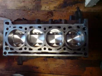

right been busy again heres the progress, got the block and head put back together :clown:

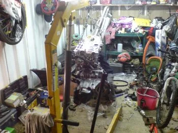

then we started to fit the rest of the parts. it takes longer than you think to build it all up. bulit it up on the engine crane made it easier to move the engine round to fit belts and wiring harness

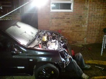

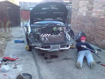

it was a late night on sat but finally got the engine back in its home. result. had to rig up some lighting

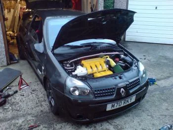

pics from today engine is in and its all built back up. it started first time :clown: but an engie management light came on so 2mora its going to get plugged in to the renault clip. bit of luck it will only be a injector or a lamba sensor
