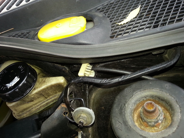

Right i'm trying to wire up my subwoofer, how on earth do I get it to the battery?
I've searched, seen how and I just can't seem to see where the wire will come out into the engine bay, I've tried feeding a bit of power cable to see if I see the end and no luck, its all covered in firewall!
can someone circle or something where it should be going in?
This is the last of the bonnet release I can see
And this is where I tried feeding some through first.
Cheers!

This is what I have done on my current clio and my last one, pull the passenger carpet down from under the dash until you can see a pressed shape in the body off the car, in the dead centre of said shape drill a hole and fit a rubber grommet, this will put you your wire out just above the abs unit.
hope that makes sence! :approve:
Isn't there a hole suitable behind the coolant bottle? Not sure, just what I've heard! May be worth having a look.

It's easy Chris honestly mate. Push a hole through one side of the bonnet release grommet in the passenger footwell with a screwdriver. What I did was push the earth cable through the grommet from the footwell and then feel down behind the washer bottle and pull it through a bit. I then used a bit of duct tape to attach the live cable to the earth cable and then just pull it back through from the footwell. It's a piece of piss mate. If I can do it anyone can lol

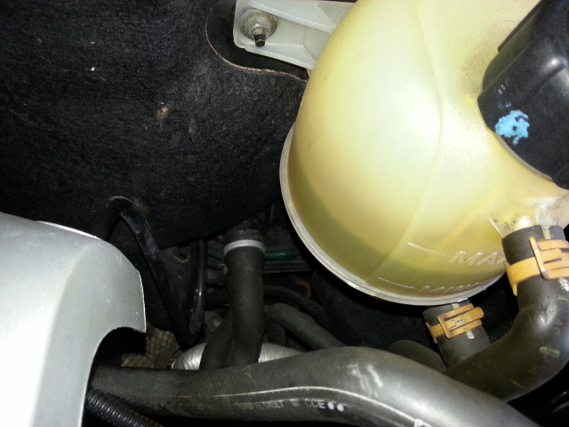

Ok, maybe I should unscrew the coolant bottle? As I could really see way of getting behind it.

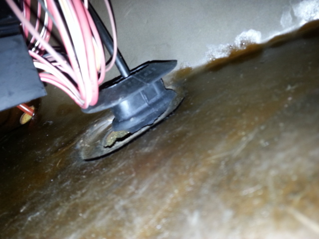

SO basically the third picture is the grommit I want to be feeding a wire through? its been hanging like that for god knows how long (not actually attached) so do I need to poke a hole or shall I just feed it up next to it?

and yes, the coolant bottle bracket unscrews. and will surely come away from the firewall no?

The coolant bottle doesn't need to be unbolted, just unclip the power steering reservoir instead, I think it just pulls upwards, might be a tab on it or something. once that's un-cliped and dangling you will be able to pull away the carpet behind it and put your hand down to feel the grommet. Thats why I used wire because its easier to feed that through then pull the new wire through into the car.

ooooh ooooh ooooooooooh so the grommit in the passenger footwell, actually poke a hole next to the bonnet release wire? got it! I tried poking earlier but though "nah its blocked" didn't think about poking a hole through it.

Pulled out power steering bottle, felt down and there was the grommit! (although it wasn't actually fixed, much like the passenger footwell one pictured above, sub ben fitted before?)
So i just fed it from the engine bay down and there it was in the passenger footwell, just ran it next to the bonnet wire and grommit as I can't be arsed to get it in the grommit.
