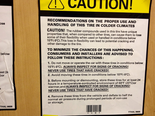

I've heard that they shouldn't be left out when it's cold, as it damages the rubber?
BTW my R888s are wrapped up in the garage for the winter ;)
I have never heard that, and never had a problem with my tyres. The track car spends it's winters in a non-heated garage.
Is your garage heated?
Fletcher
Caution sticker that was on the R888s
securedownload by fletcher10, on Flickr
The wheels and R888's are left in my non heated garage, which does get cold, but nowhere near as low as the temperatures outside.
  SQ5
It's only to do with if car being used as the rubber can crack when it's cold and brittle. It's more to do with actually putting the tyre on though!
