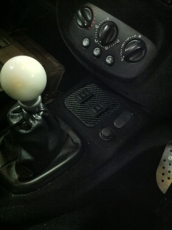

I bought a clio wiring diagram which has turned out to be pretty crap tbh.
Basically I want to move the elec window switches (just the driver's side ones) to the centre console (I'm putting a little panel in there). I've bought some aftermarket window switches which I know the pinout of.

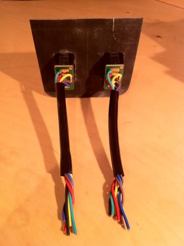

Cheers Rob, just wired in new ones in the end, saves trying to mess about with the relays and whatnot!
