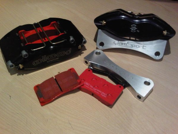

Anyone out there running Wilwoods that could tell me the caliper model and/or part number?
I've got a set of Wilwood Powerlites on another project car and wondering if I could fit them to the clio with brackets
Cheers
Tom
  E46 M3 & UR Quattro
The ones supplied with the brackets from Jamsport/KTEC are Wilwood Midilight Calipers with dust seals IIRC.
  182/RS2/ Turbo/Mk1
You will be able to make some brackets to suit, but im not aware of anyone retailing one for that specific caliper already on a clio.
  182/RS2/ Turbo/Mk1
Radial.
You can see the brackets on their site:
http://jam-sport.co.uk/shop/renault-clio-295mm-4pot-brake-kit/
  clio 182
Anybody know the piston size used in the Midilite calipers supplied by Jamsport/Ktec? Might just buy a set from Rally Design then make some mounts.
Looking at the spec for the Wilwood Powerlites I've got already the maximum vehicle weight is 750Kg
