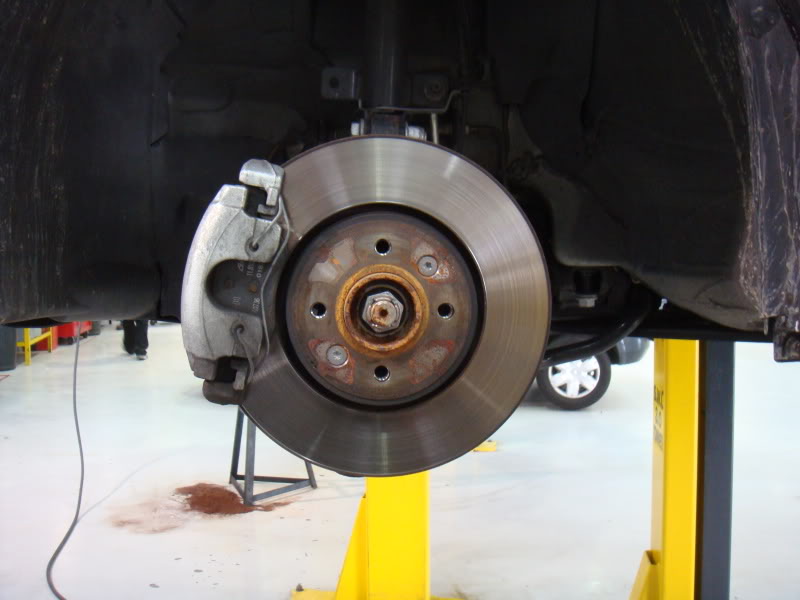

  Inferno 182 CUP
Twingos dont have 4 pots lol!
I have a Twingo..
It has laguna pads (1.5DCI) and 182/72 discs. 280mm.
I spent months looking to upgrade them and spent alot of money so yes i know that for a fact
182 pads WILL NOT fit
  Skoda fabia Vrs
i can deffo confirm as i have a twingo lol. brakes are off a 172/182 hub. Also use the same brakes on standard meganes and lagunas now too.
  Inferno 182 CUP
It's 182 disc and laguna caliper as i just said. I've spent months playing with them and lots of money so I know what they are.
But they are not!!! 172/182 calipers
  Skoda fabia Vrs
wasn't very clear with what i said. discs are clio 172/182 and calipers are new laguna or megane aint they? sorry lol
  Skoda fabia Vrs
Bit of technical info from renaultsport site.
17" 133 Cup alloy: 10.4kg each
205/40/17 Toyo R888 tyre: 8.5kg each
Megane II brake disks (280mm diameter vented fronts, 240mm diameter rears)
Laguna front callipers (57mm)
Megane II rear callipers (34mm)
