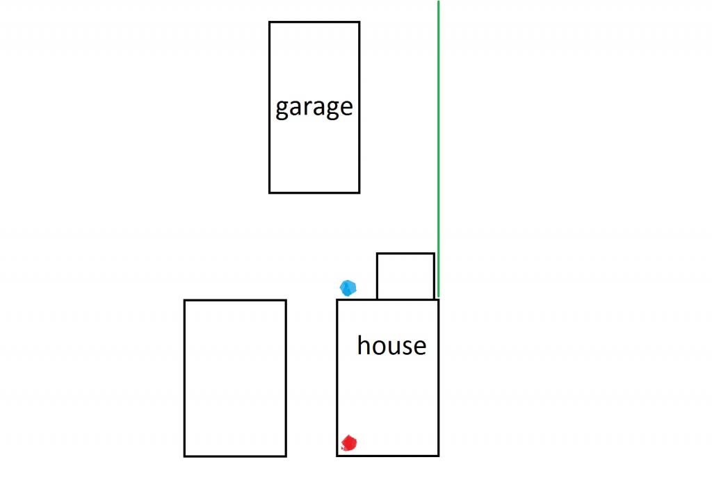

I need internet access in my workshop and am having trouble getting it there
on the below pic currently my phone line comes in at the red dot, right at the front of my house. this is where my bt homehub is, so I get zero internet in my workshop.
got a second wireless router and put it in the loft to see if I could pick it up in my workshop and no, zero, nothing.
so now im thinking about running an Ethernet cable down the outside of my house and putting my second wireless router in a water tight plastic box at the back of my house near my garage blue dot. just done a test run and although I get internet I only get a low signal in my workshop, so I was thinking about any range extenders or something I might be able to get to help.
Andy_con
  clio 182
my workshop is right at the end of my garage, my garage is like 13 metres long. the front of the garage is about 6 metres from my house, at the front of my garage I get great signal. go to the back of my garage where my workshop is and I get low signal. probably cos its full of machinery and metal cupboards and as most garages a big metal door.
no idea how these work or if they are any good, but plan was to put one of these right at the front of my garage in a plug socket on the wall.
http://www.maplin.co.uk/netgear-wifi-range-booster-for-mobile-devices-661733
