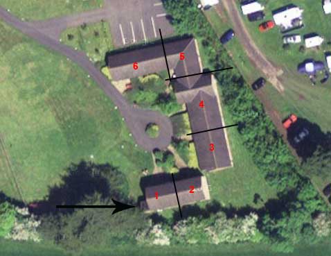

I've been asked by a website client how they could offer their holidaymakers WiFi. I've never put Wifi in anywhere other than a home wifi using one router, so calling on the tech-heads of CS for some advice. There's 6 cottages, as shown in the pic, the BT phone line comes into the office which is arrowed, attached to cottage 1.
The site is 50 yards by 30 yards, and 55 yards diagonally across from the edge of the shed to the corner of cottage 5.

You would probably want something like:
Phone line to Cottage 1 > modem > router (with DHCP configured) > CAT6 to each location / cottage > Wireless Access Point ?
Deepening on the range of your AP you might not need one in each cottage.
If there are not enough ports on the router just add a switch to it.

You can add wireless repeaters which don't require cables, but if they're thick stone walls, it may not work. I would start with an access point in the office and test the range.
