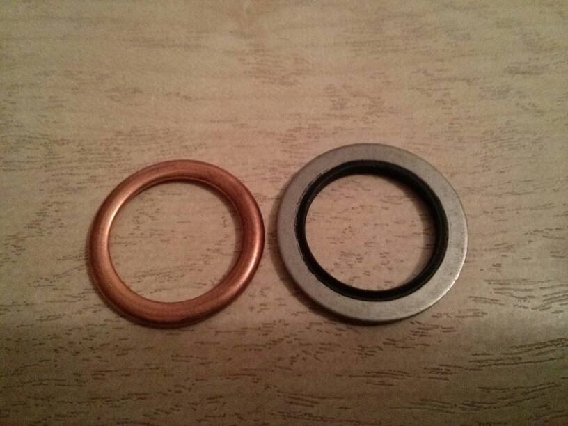

Which sump washer to use?
  mk1 Octavia VRS
I can never remember!
  mk1 Octavia VRS
Cheers, I seem to have ended up with loads of copper ones. Lots of the cars use copper washers so they'd probably still work?
DaveDreads
I'd say no, even the rubber one leaks from time to time,
so i'd expect the copper crush one's to drip like a leaky tap,
I could be wrong though as i've never used one on the sump.
MicKPM
ClioSport Trader
  Clio16v/Zoe Z.E.50
Copper washers don't work with cast sumps, as above, go with the rubber item.
  Mazda3 2.2D 185BHP
Eh they dont?
Thats what Renault gave me for the 172 when i asked for Engine oil and a washer.
And its not leaked once since I refreshed the oil at the end of july.
