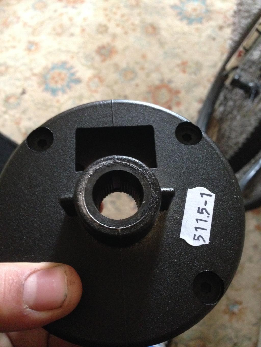

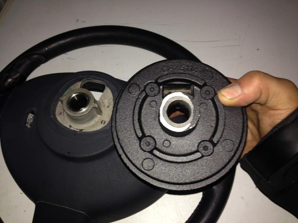

I had the exact same problem buddy, I bought a sabelt one which didnt come with the tabs needed and had a right farse trying to send it back.
Anyway as Nick correctly said I ended up after much research found an ORECA racing one. Apparently if the boss is specifiaclly for a 182 and not for a 172 ph1 for example most should come with the tabs but a lot of people advertise the bosses for 182's as they all fit across the model range apparently. If that makes sense.
Sabelt Boss:
ORECA Boss
Miles better quality too. But cost slightly more.
Sabelt Boss:
ORECA Boss
