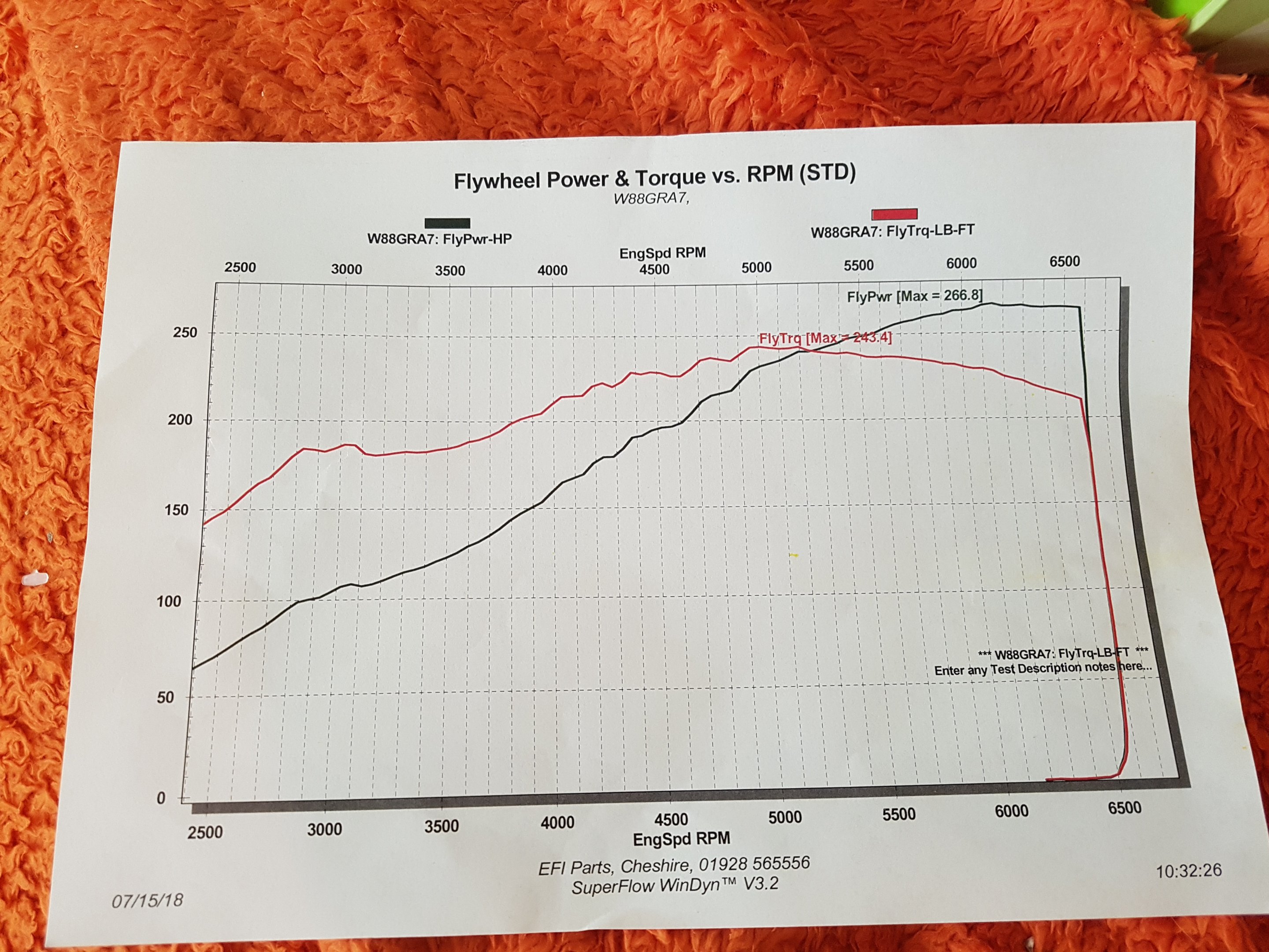

meant to message you, got one in to take you for a quick spin in if you are around? low boost, 270bhp.
bloke
  dan's cast offs.
I’m around 8-9psi at 245bhp I’m running the thicker head gasket
270!! How long has it been at that power?
not long, good few hundred miles so far but nice torque curve so no reason for it to go pop!!!

Nice, only reason I’m so interested is I’ve been pondering on the idea of giving mine a sniff more boost lately, just to add a bit more.. Who mapped it?
bloke
  dan's cast offs.
it's just gone back to him but let me know and i can get it back over for you.
