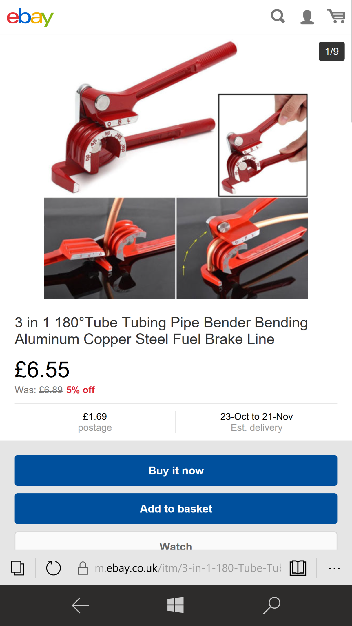

I use this myself. Gives pretty neat bends

Yes that should be spot on. There's a huge huge tip on how to use it too that i've got but it's very incredibly hard to write out.
I can do a video for you if you like unless i'm trying to teach you how to suck eggs.

I've bought one of these now, what's the tip? :)

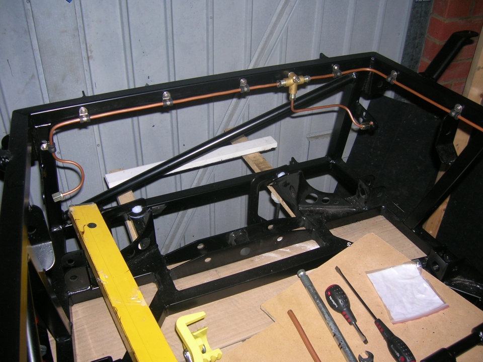

Did mine by hand and with the tool listed first. Make sure you get it right first time as it work hardens pretty quick and any more than 1 or 2 corrections and you will get stress cracks and kinks.
