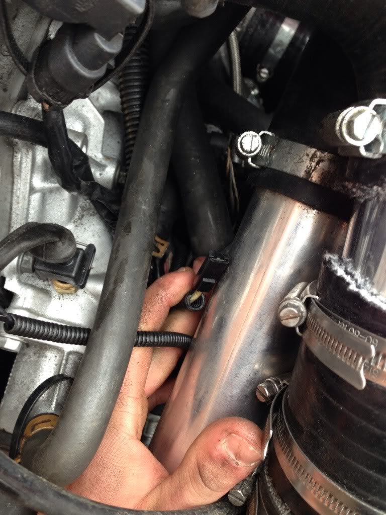

Where does this plug go? Won't start
  Ph1 T
Just put the engine back in and can't find where this plug goes also just tried to turn it over and not even a noise
Djw John
Scotland - South
As said starter solenoid wire, not an earth though, it triggers the solenoid. The other wire to the starter is the main power one to actually turn it and it earths simply by being attached to the gearbox.
