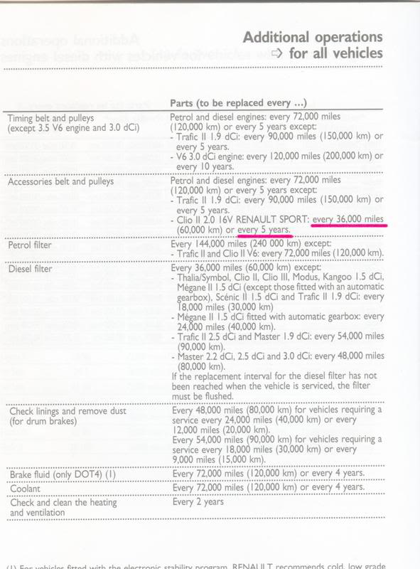

don't forget aux belt, every 36k or 5 years, whichever is sooner.

Not according to a friend of mine who is an RTE. But I guess if your only working on 36k intervals, based on servicing at 12k intervals I'd still say its 3 years. Anyway I changed mine and its up to the individual I guess if they choose to change it at 3 or 5 years based on the information given.

Renault always state that its only valid at the time when it was printed if you really want to be fancy you should check the service intervals for parts via icm.
