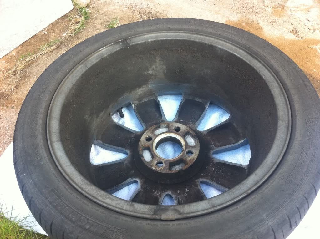

After giving my car a good clean before FCS, I kept noticing (Also previously) that the inside of my front wheels were caked in grease, tar, break dust etc etc! Kept putting the wheel brush through the wheel and bringing so much sh*t out!

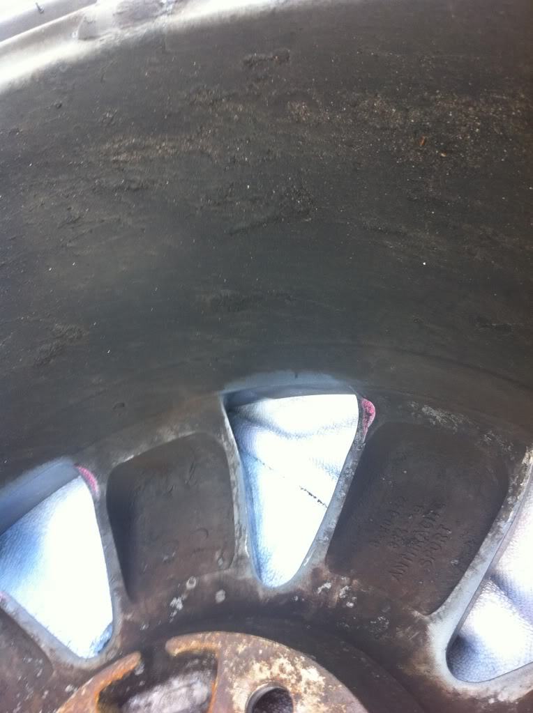

Tonight after work i bit the bullet and whipped one of the fronts off to unvail this;
Close up;
Must admit, i was hardly equipped to be taking this on, but thought f*ck it, Got to have ago. Ruined a wheel cleaning brush, numerous rags/towels.. Endless amounts of wheel cleaner and got to this eventually!
Probably about 2hrs attacking it and thats only one!!! Dreading the other front, and to be fair the backs arnt too bad. This is not to my approval so will be coming back off again!
Can someone list some products and a procedure for me to follow please, There MUST be a more effective way of tackling this..

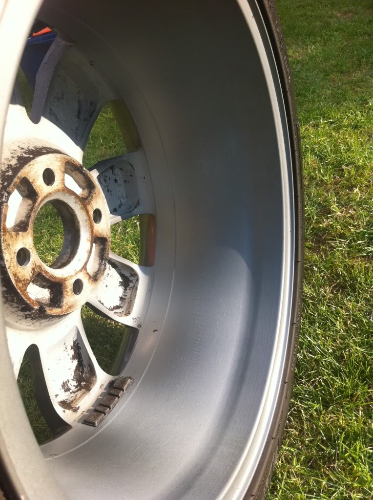

Started off like this...
I sprayed some TFR on and let it soak in a minute. Then got the store card and scraped off the excess grease.
Sprayed on the bilberry, again let it soak in. Agitate with the brush
This got rid of most of the mankyness, but with a bit more elbow grease - pardon the pun - 20 mins max later....
Im pretty happy with that result, the wheels are square anyway so not really that bothered, they're just going into storage now.
