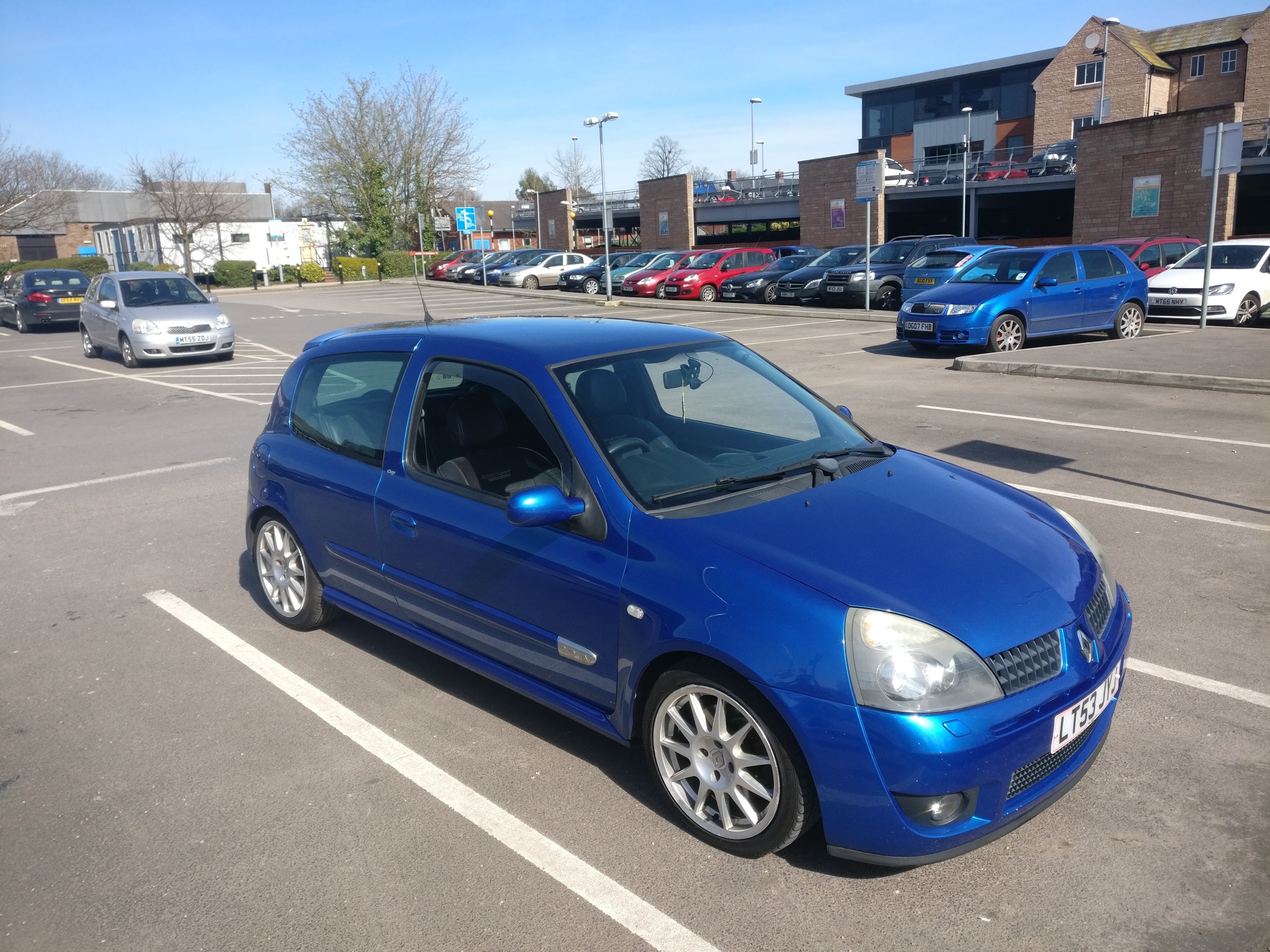

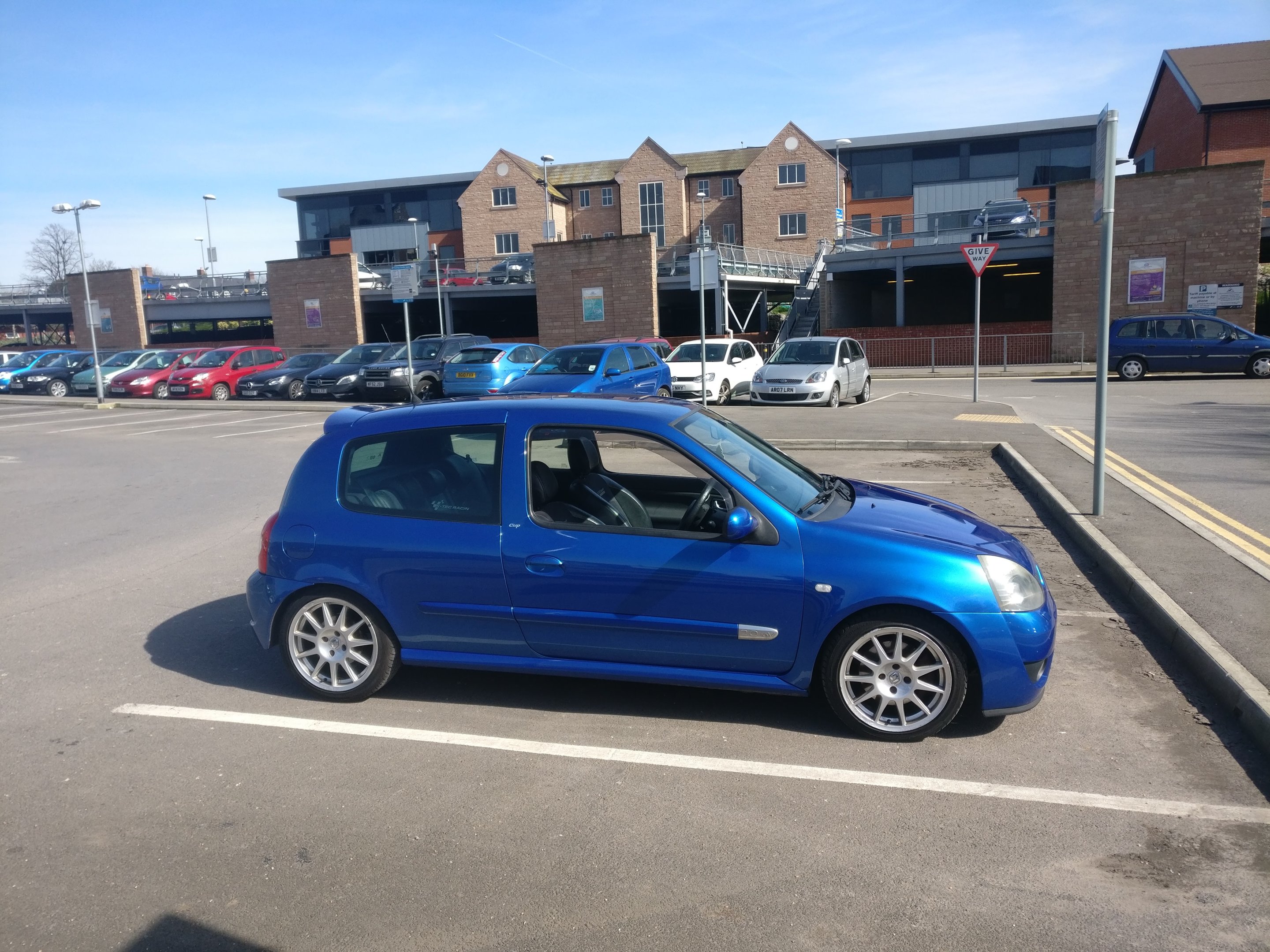

  172 cup
Still got it not done much with it lately , took it for a spin the other day felt good:)

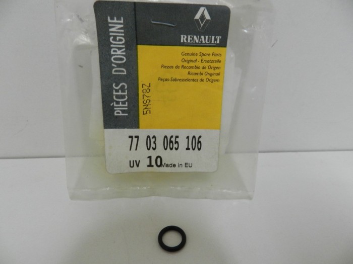

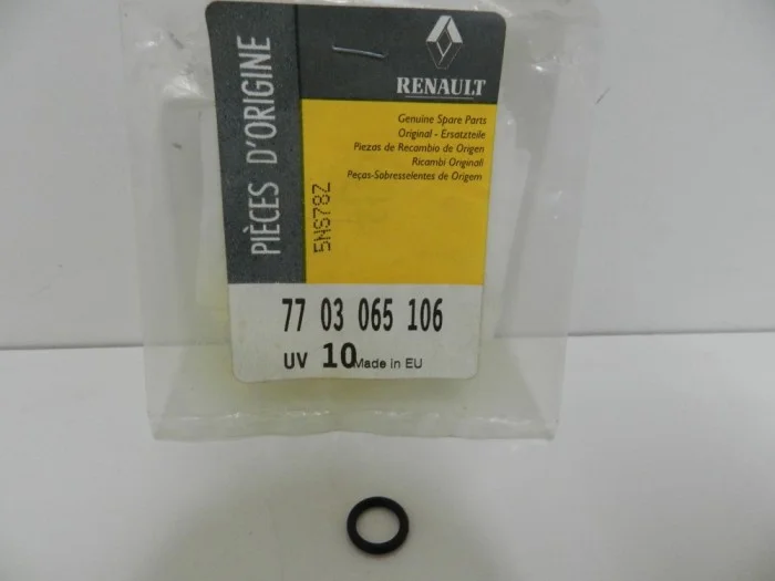

has a power steering fluid leak, I`ve got the part just not the money to repair it , ( the pipe from under the alternator that leads around the gear box so I believe ).
Where`s it leaking from?
If it`s the metal high pressure pipe at the back of the pump, with the idle switch, the O rings can be replaced.
A very simple job, but use a flare spanner, not an open ender.

@STEVE.M The fluid is leeking from the / a nut that's under the altanator so I beleave, I can see it when I kneel down and look tru the lower grill, have u got a link to the o ring on ebay? Cheers
