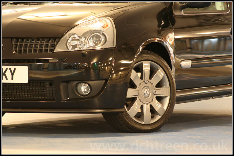

P21s is easier on and off, and gives deeper look, Nattys Blue gives a wetter glossier look and is cheaper, can't decide? Easy - just buy both!
  1.6 focus zetec....
Lol good idea mate...your car looks good no matter what you put on it judging by the pics...
