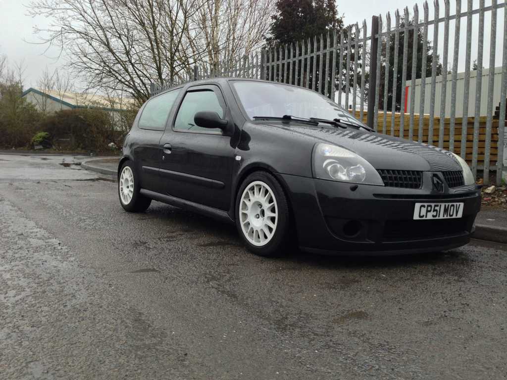

205/50/r15 tyre, ET48.5 with 20mm front and 15mm rear spacers, standard camber, sportlines on a 182 FF.
