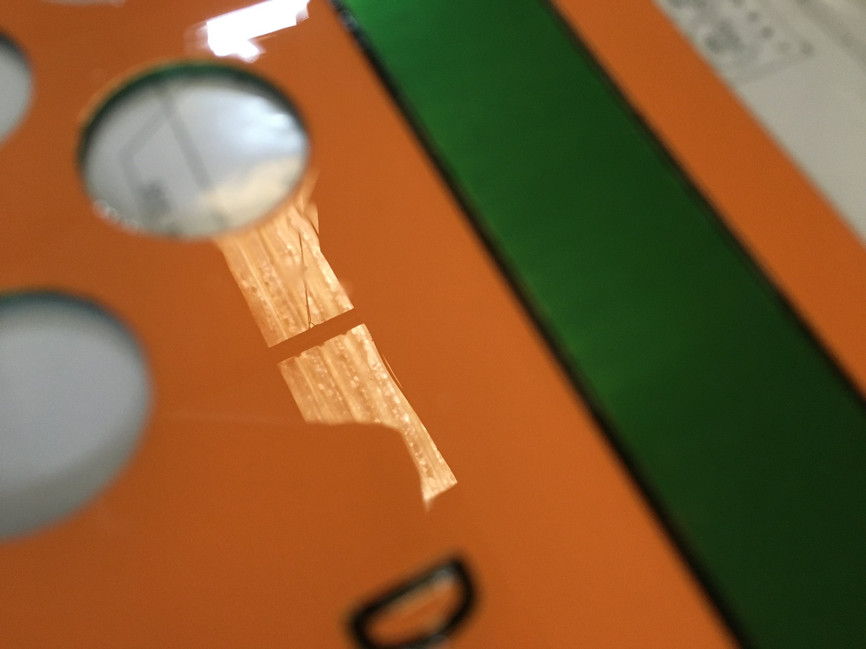

Knuckles
If it helps, that's the finish from 2k colour with no lacquer over it

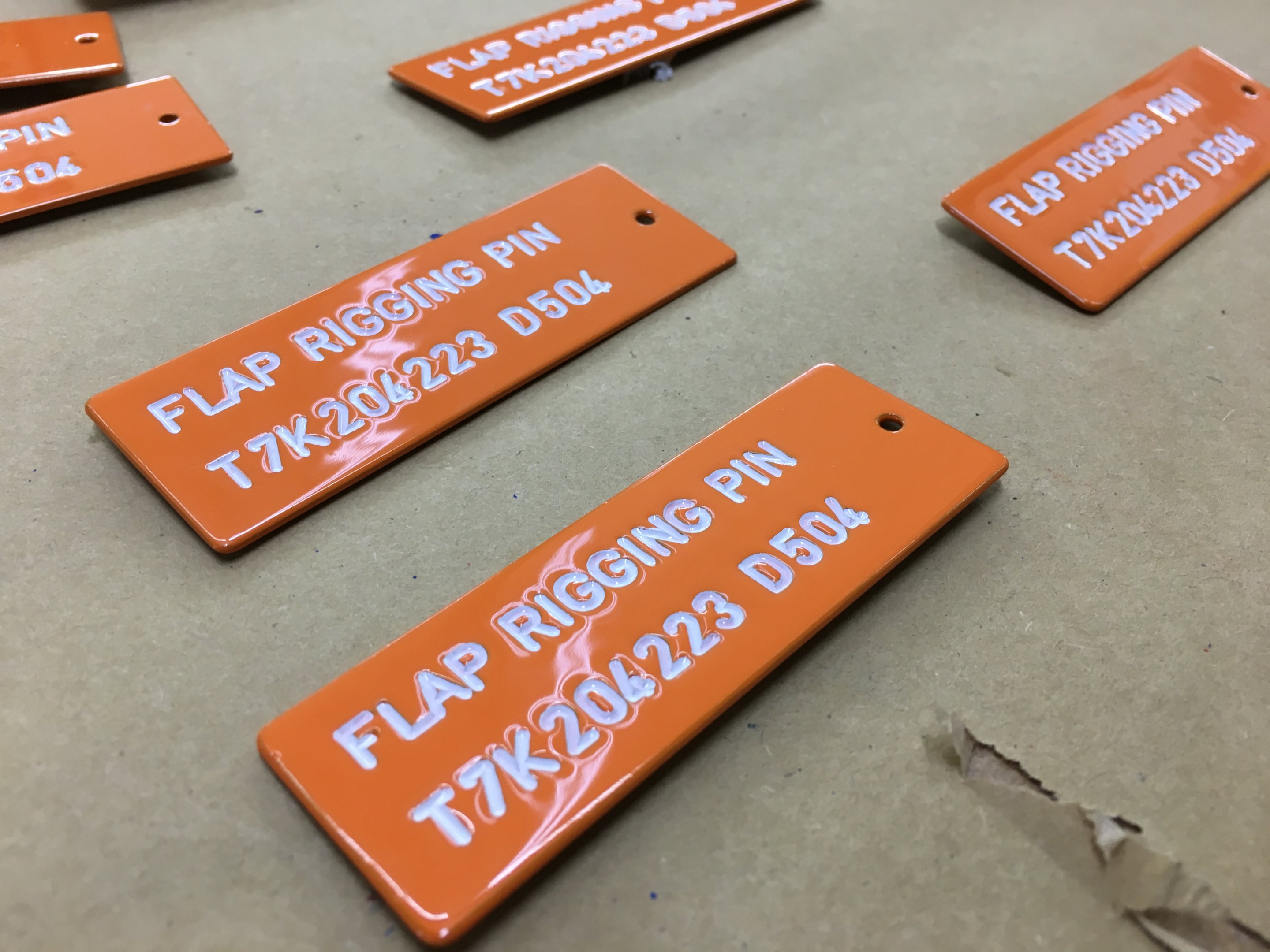

And this is lacquer over the top, which I think will be overkill for a boot floor
