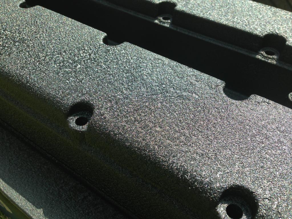

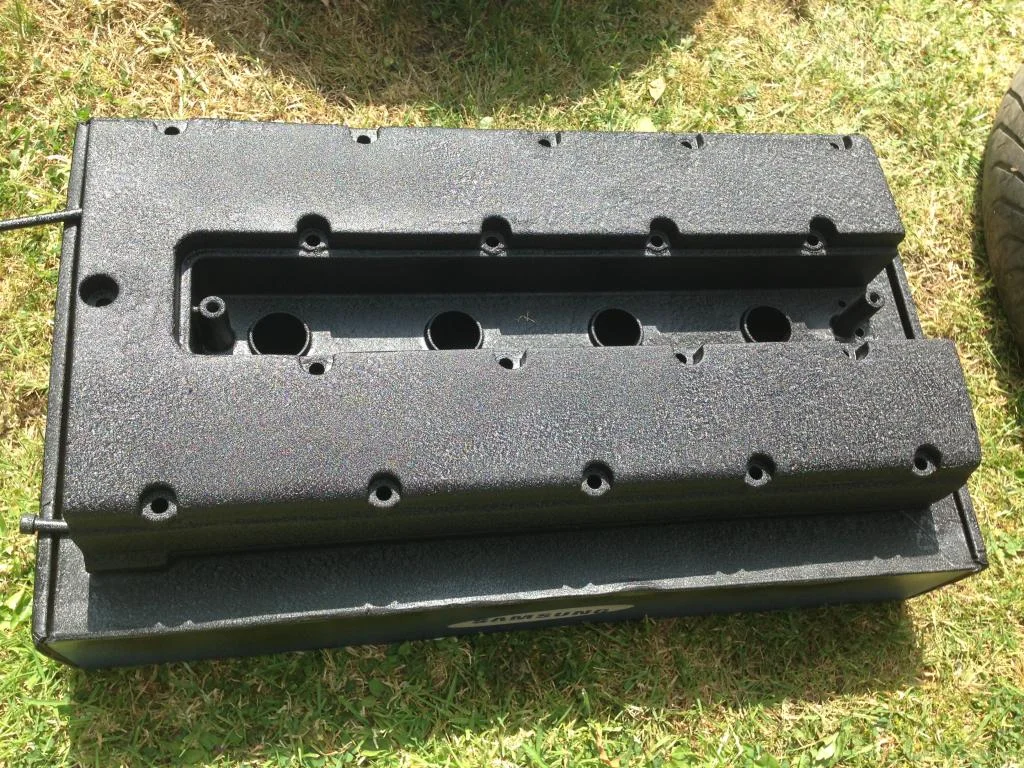

I used VHT wrinkle finish on one of mine and it turned out great. Not a Clio of course, but certainly different. Or it was when i did it at least...
