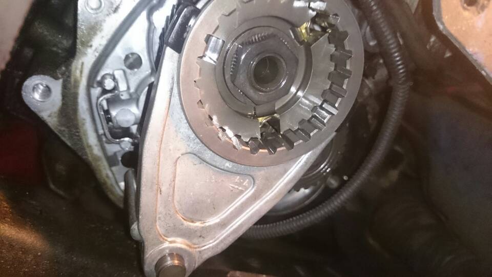

What gear am I in?

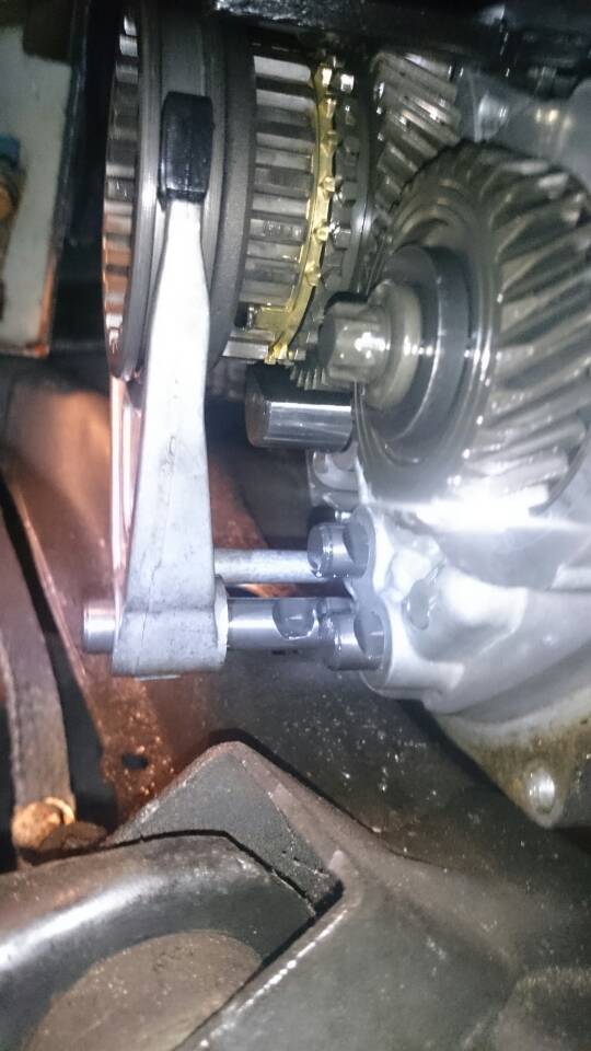

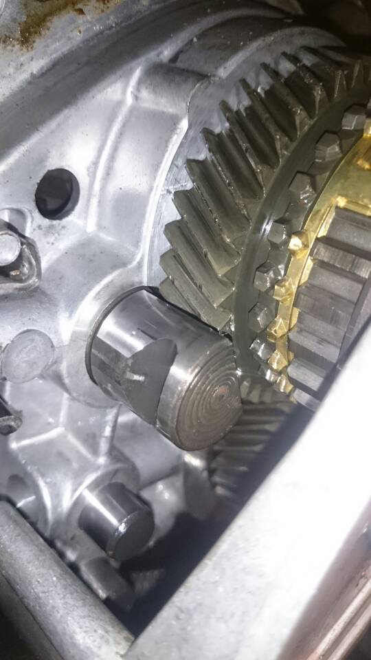

The gearstick feels like its in 4th and the selector looks like it is too;
The 1+2 and 3+4 shafts are all neutral, but the 5th shaft is outwards;
Anyone able to help Identify if I am in 5th?
Cheers

I am asking what gear I am in looking at the gearbox internals as such.
I somehow must of knocked the gearbox and one of the shafts (I believe) has moved, putting it in gear when the selector/gearstick is in a different position.

That my friend is not in any gear at all! You've managed to get the selector hub to go beyond its usual position.

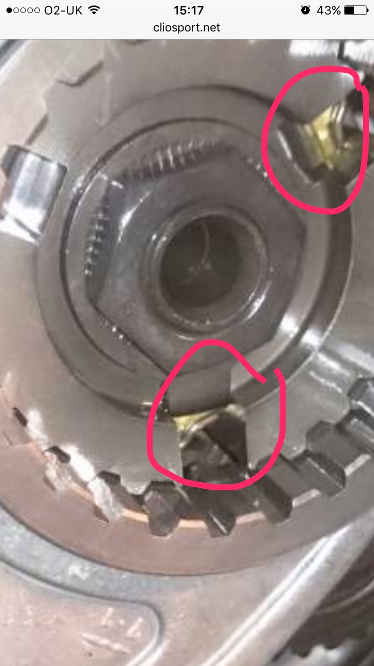

All is not lost though!! If you look inside the selector hub down the 3 relief grooves, you'll see that there's a spring clip. Get a thin electricians screwdriver and pry it inwards, but at the same time pushing the hub itself back down.
That should see the lever return to neutral.

Well from that one picture I can see that it's not in reverse and it's definitely not in 1st, 2nd, 3rd or 4th from the position of the shafts, and there's also a bit of wear on the synchro ring for 5th gear. 😂
If you zoom in on one of the images, you can see the spring clip that I am on about as well!
This is what comes from taking far to many jc5's apart!
Wear on the synchro ring; is this bad wear? Or okay wear....
