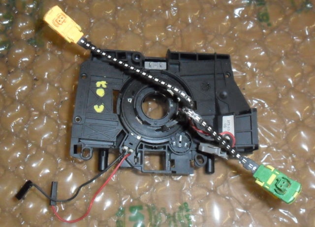

What are these wires on the squib?
  Clio 172
What are the 2 black and red wires bottom left? Someone said horn but the horns the red and black plug right?
  FF Clio 182
Horn. It's what connects to the horn on the stalk for the PH1.
I know because I have a ph1 horn on my 182

The above comment about the cruise control is wrong.
That's a non cruise control squib, both yellow and green connectors are for the airbag. Grey is for horn on the steering wheel and the as Carl said the black and red plug into the stalk and are also for the horn.

Okay cheers people :)
I put a voltage meter on both of them and there's no power coming from them? But there's power coming to the squib, joint the horn up and did work is this a problem with the horn itself or the squib? ( bought it from eBay)

There won't be as they come from the steering wheel not from the loom. If you plug them in there will be 12v between the red wire and ground.
