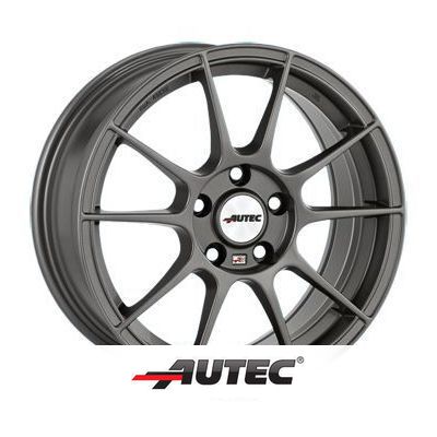

bashracing
These are lighter than pro race 1.2 and cheaper, Made in germany 15x6.5 et35 mine weighed 5.7kg
https://www.tyreleader.co.uk/alloy-wheels-brands/autec/wizard-4003/
