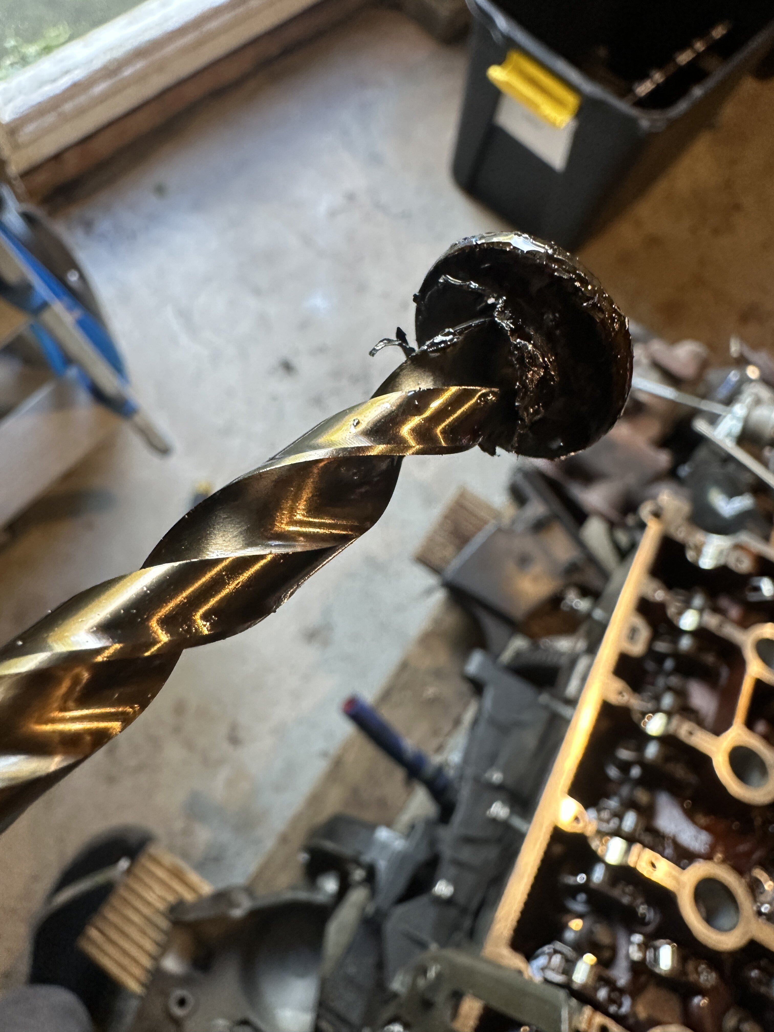

Drill the c**t out - ne need for a welder.
If I can drill a head bolt out then any normal human can drill any type of bolt.
Cobalt drill bits are your friend.

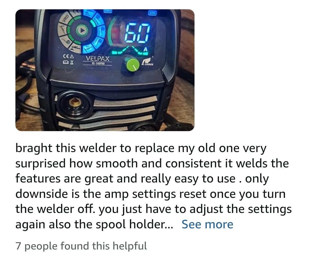

Looking for advice on a simple DIY plug In welder to pigeon poo weld a socket onto a rounded bolt.
Will something like this get the job done? Or are these cheap ones garbage?

That looks absolutely s**t, you'd be better off with a car battery and some jump leads (please don't do this either)
You want a Mig welder for welding a nut onto a rounded bolt.. where is it on the car? What else have you tried so far?
