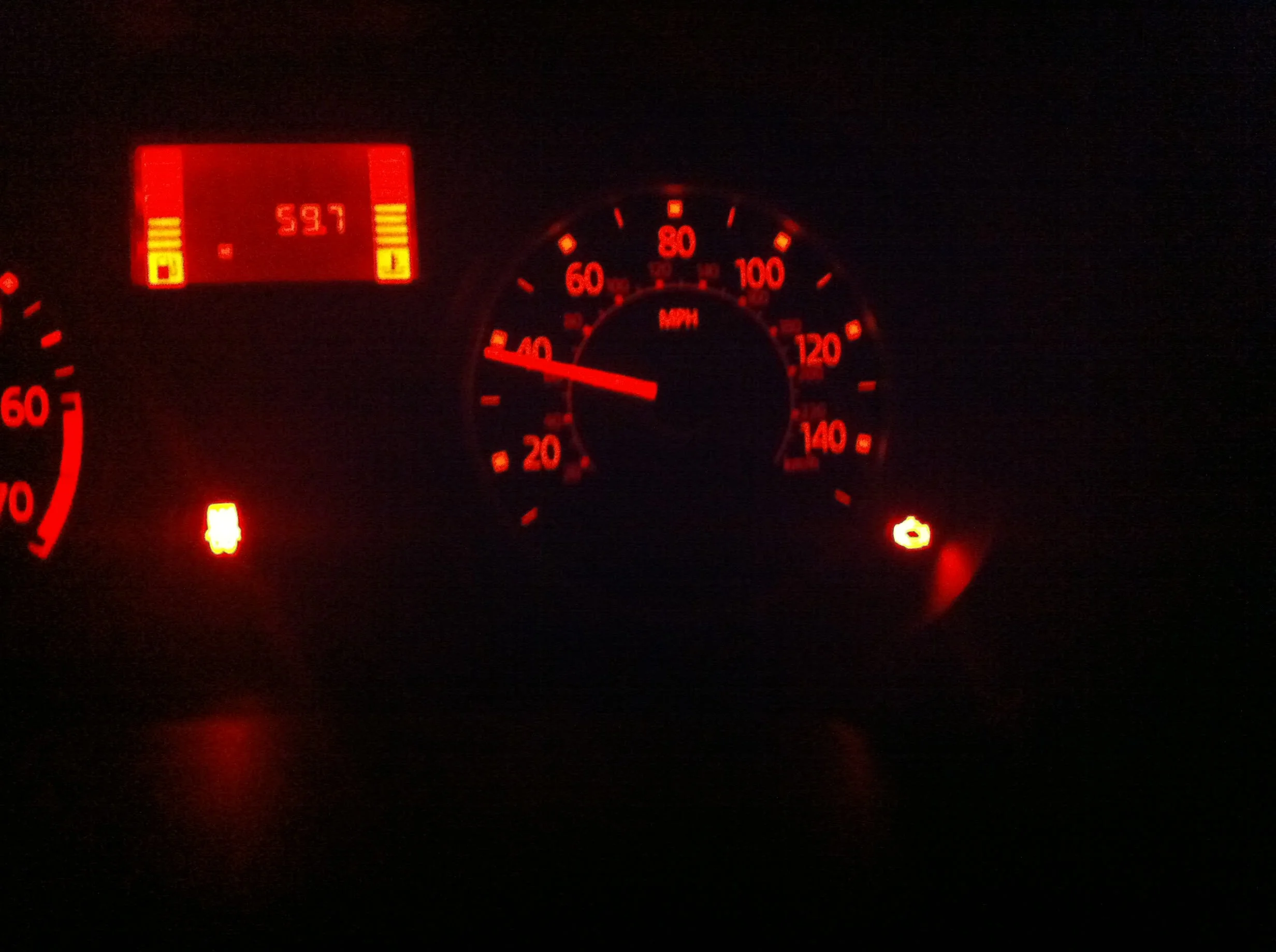

Hi, Got a bit of a problem here. I was driving along when two warning lights illuminated and the car seemed to lose most of it's power, One light is an orange engine shape, and the other is an orange heart monitor (pic attached below)
Rev limiter seems to be at about 3k rpm and it can barely achieve 50mph.
Car is a 2007 Clio Campus Sport 1.2 16v.
Not really sure what the cause is. Any help welcome :)
Thanks in advance!
Crap pic, but I was driving :p
