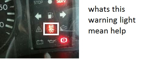

WARNING light on dash board
  2002 clio 1.2dynamic
hey ive got this warning light on my dash board its only ever on for a couple of seconds and at random intervals anyone any idea what it means
service light and airbags also on because drivers side seat wires are torn :(
car has got a slight missfire everynow and again but nothing major and the light isnt nessacarily on when it missfires its just randomly mostly when cruising
guess ill have to try find someone with a diag machine to borrow im skint atm so cant afford 70quid for it
borrowed a machine and the only fault it brought up was for my airbag cause the wires under the drivers seat are fooked so need help
leads are part of the coilpack and the plugs are fairly newish i have read the fitting low quality plugs can cause this i just slapped some nkgs when i got it in feburary
right fitted new coilpack and plugs its not storing a fault for a codereader any other ideas folks ???????
tried plugging it into a full snapon code reader and its not showing any faults at all, the lights intermitternt still but not as much and the missfire is more like massive flat spots with the occasional judder
On what system, just EM? Personally i'd take it to someone armed with CLIP or AutoLogic because my personal experience with SnapOn equipment with Renault vehicles isn't great and they're only as good as the software update version to (Some garages flat out refuse to pay for updates). It sounds like a throttle potentiometer issue to me but you will need some proper help to get it diagnosed properly. You could try changing the pedal but more often than not it's wiring related with these rather than the actual hardware.
Is that a Glowplug warning light on a Petrol?
looks like it i know thats why i was confused by it
this snapon kit is from what i know totally up to date and kept safe as he checked for updates before he pluged it in the only fault it brought up was aircon fault which my car doesnt have
i kinda want to now say its the alternator cause sat at lights yesterday with stereo heaters and lights on as soon as started to open the windows it cut out

Has anyone checked the earth straps are all intact? If not, check them!
cars still being an absolute f**k whit and missfire is getting worse when accelerating it holds back so much its untrue
tomorrow check list
connections on anything i can find
earth straps again
check if cat has colapsed (is this a seperate part or all one peice from manifold)
gonna try get it plugged in again
anything else
finally found out what it was after a smoke tester on the engine theres a crack in the inlet manifold/gasket gone which is causing the car to pull in far to much air and then stall / miss all over cause it cant give the fuel to compensate
