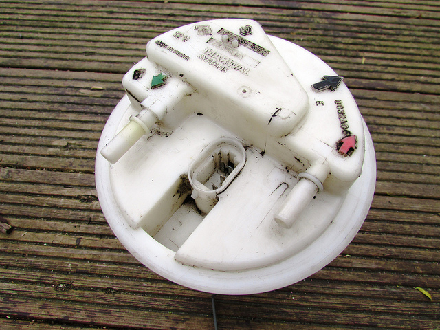

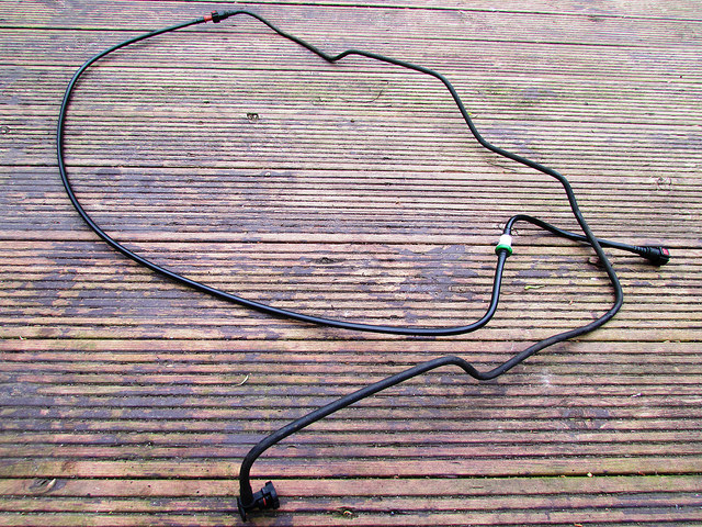

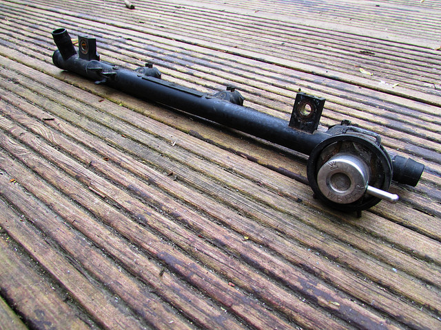

First thing IMO and was advised to is to ditch the 182 fuel setup and use everything from a phase 1 Clio 172.
So that's the sender to which I had a Walbro 255 pump installed
Fuel Out and Return lines
Fuel Rail which has the FPR attached
Apparently the phase 1 fuel system is more stable when running boost.

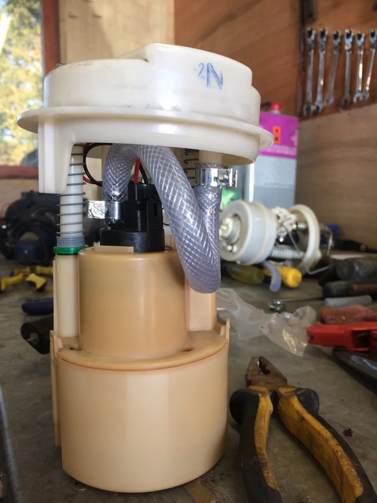

I'm not running a swirl pot setup... yet, so at the moment the fuel return runs from the rail back to the fuel sender unit
  late 2003 172cup

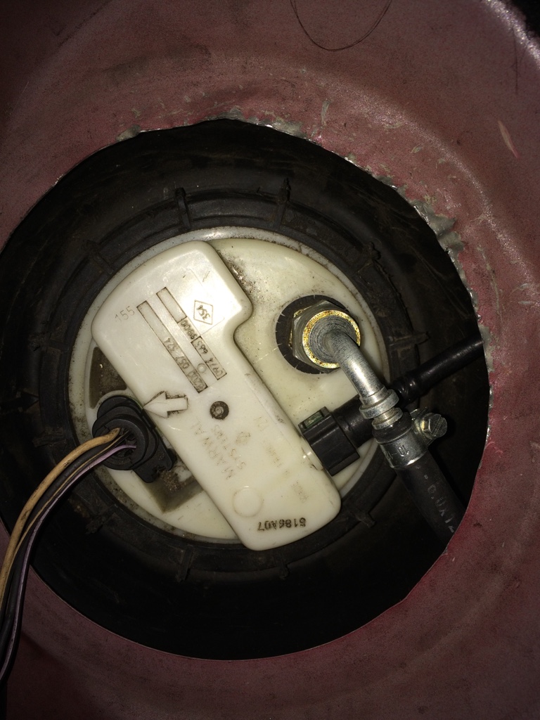

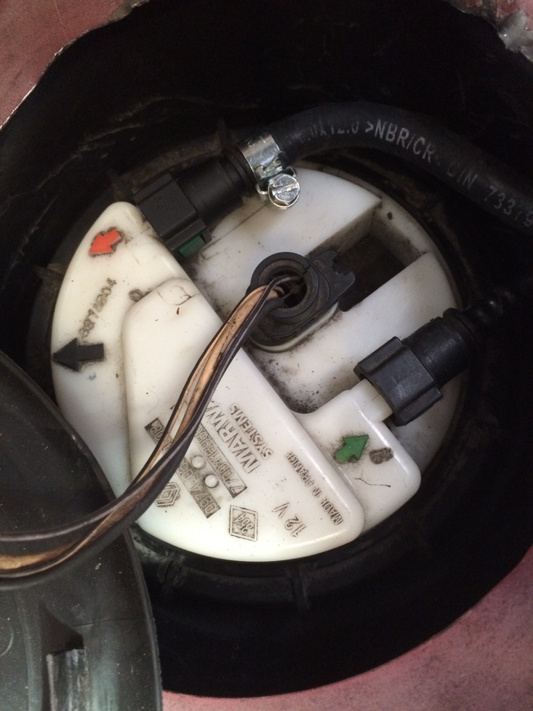

Yeah what I mean is does the return feed back into the standard swirl pot? According to my brother mine was just drilled at top so fuel just drops back in tank.

I use the complete phase 1 fuel setup as fitted to all standard Clio 172s from the factory, so it runs back to the fuel sender if that's what you refer to as the swirl pot. Nothing drilled, if you look at the sender unit in the pic above it has the 2 outlets for fuel out and return. If you look at the 182 sender unit in the tank there's only 1 outlet, fuel OUT. The phase 1 sender and the later 172s and 182s are completely different.

Looks like yours uses same plug as mine too. Some have an inline plug.

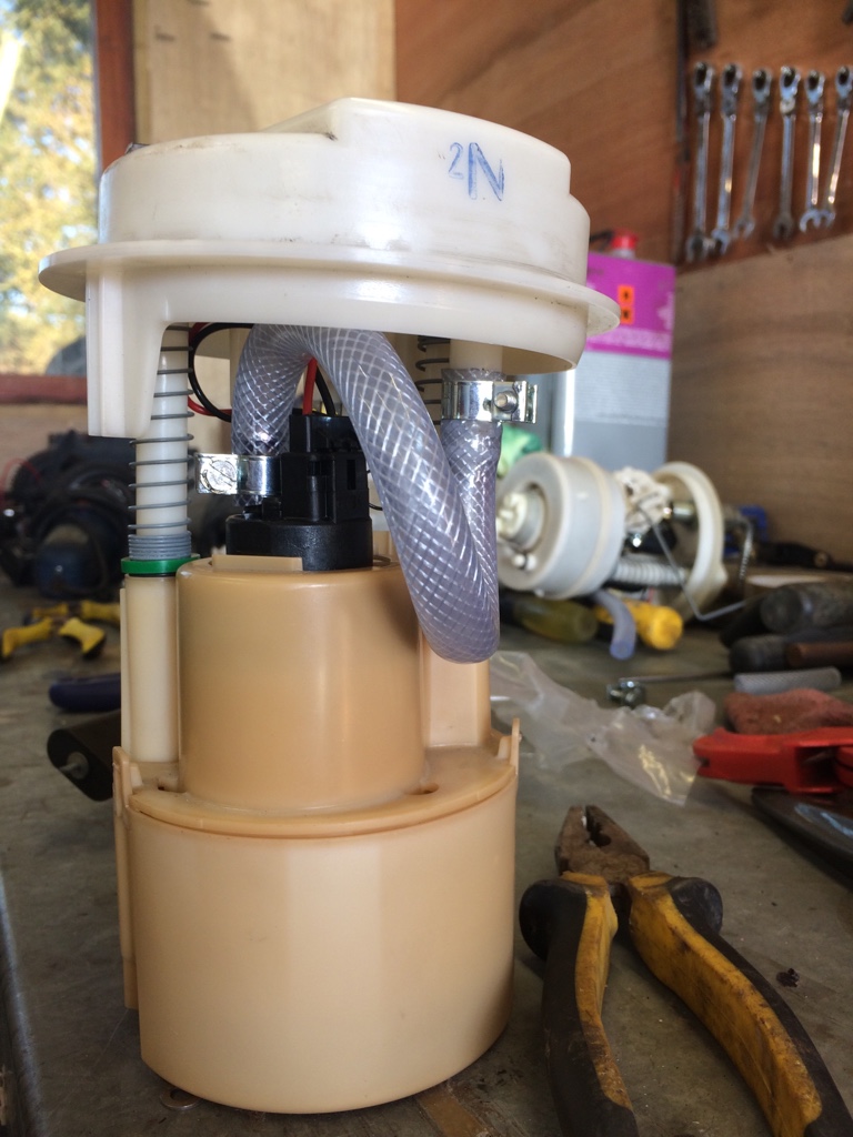

All done, loads better, new walbro, no noise. Old one had so much dirty around the filter, the return is better design.
Need another throttle body now tho, bit rattly.
But pump is better.
