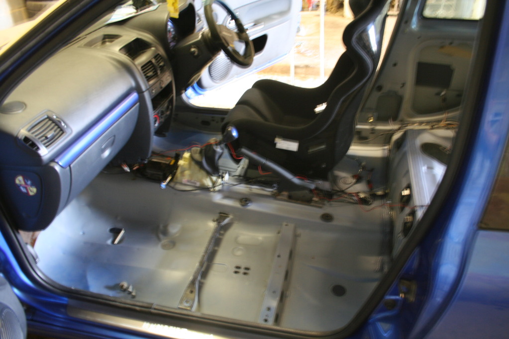

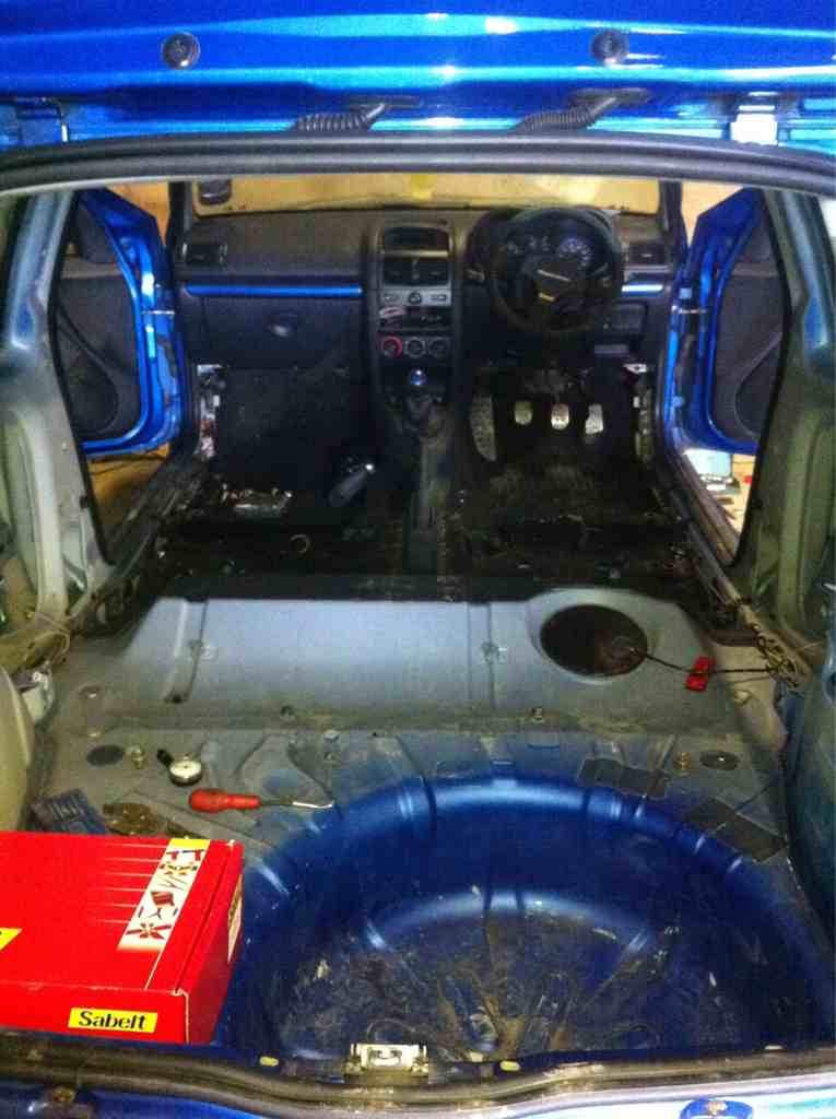

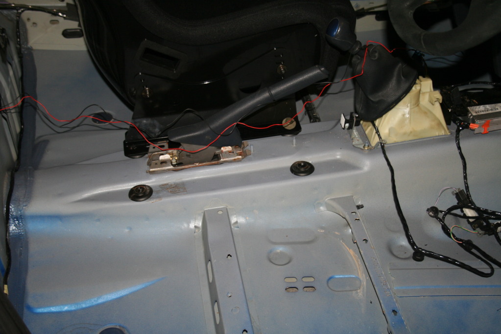

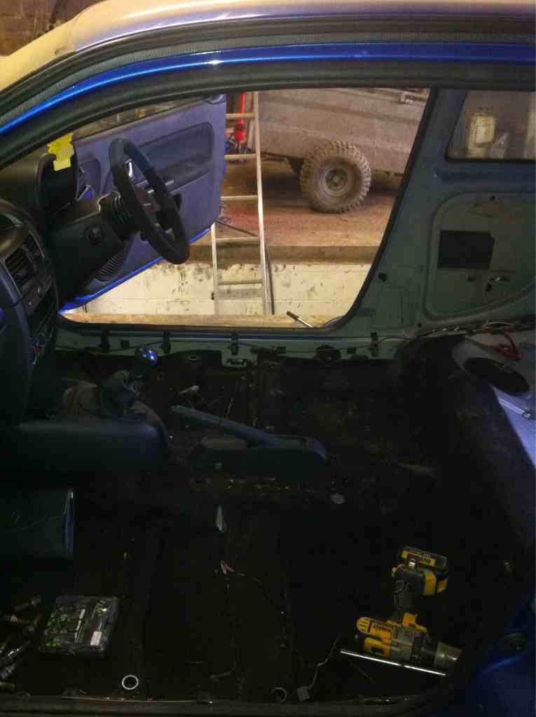

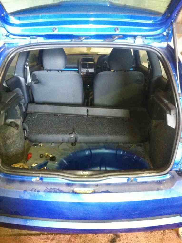

Started stripping the interior today, one bolt that was holding the rear seat on was being a right t***. had to grind it off as it broke my torx!! Lol. Anyway photos of progress -
Before -
After -
A bit to do again!!
  172 cup RS2 - 330ci
The weight of the panels alone are shocking! There all in a dumpy bag now. It felt heavy to move! Not to mention the seats! Lol. I'm looking forward for the difference in acceleration!

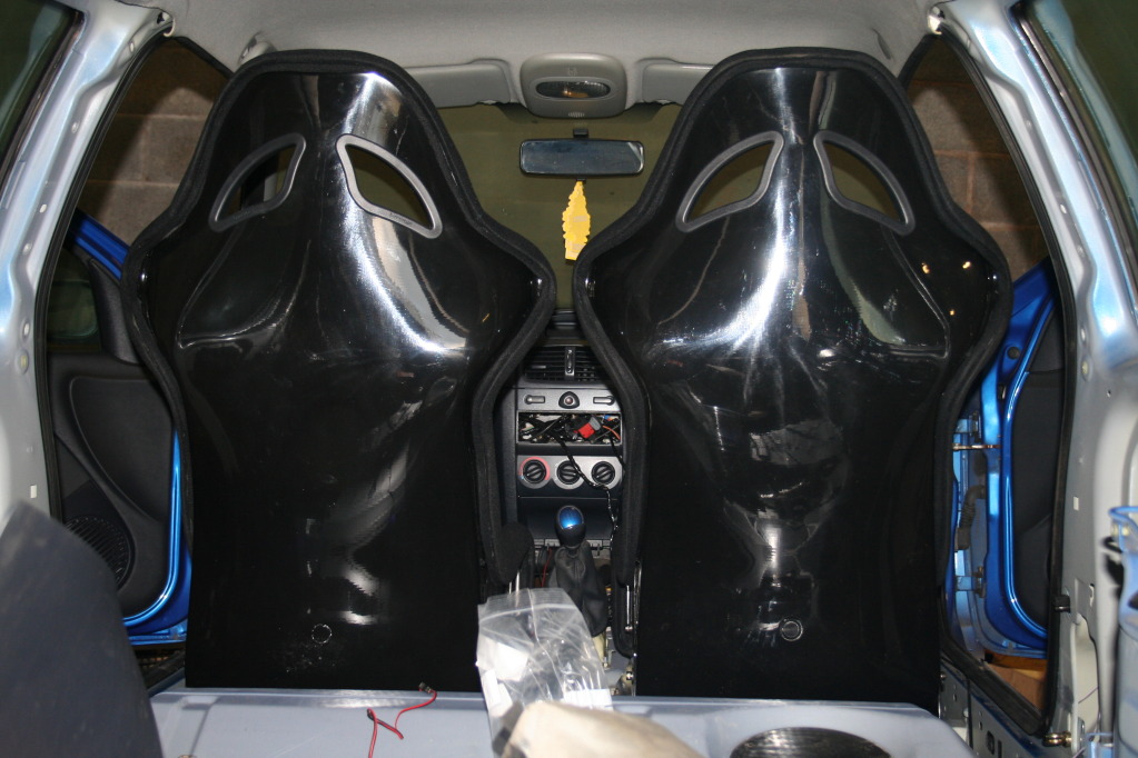

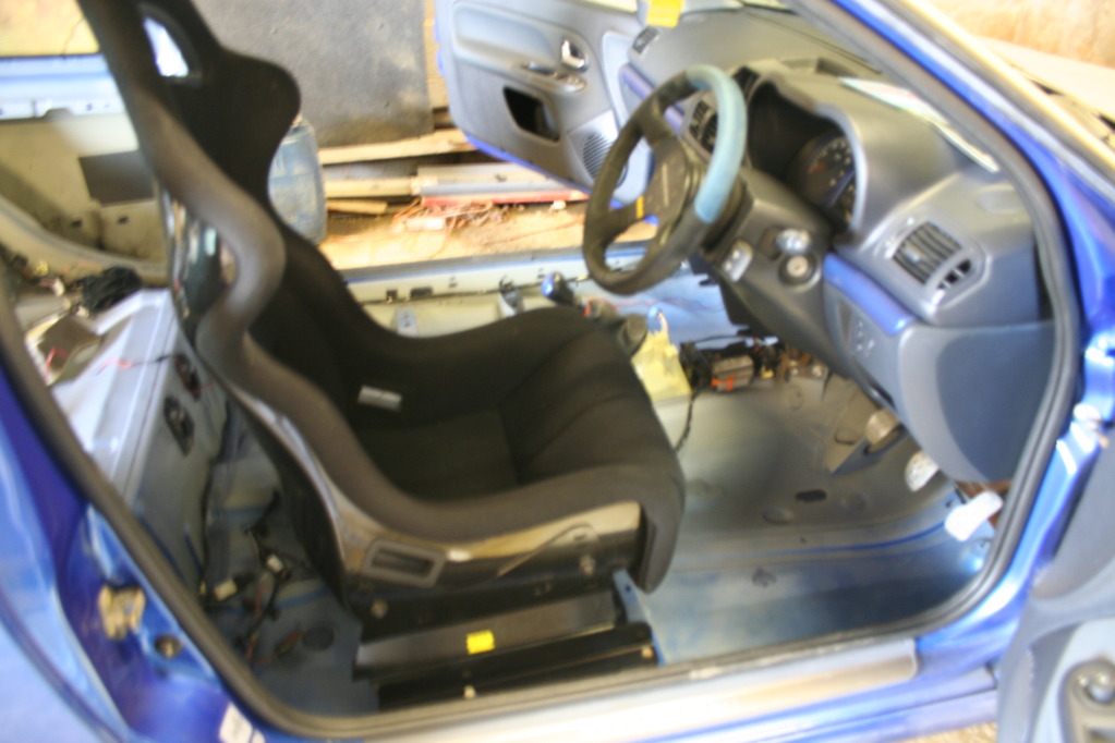

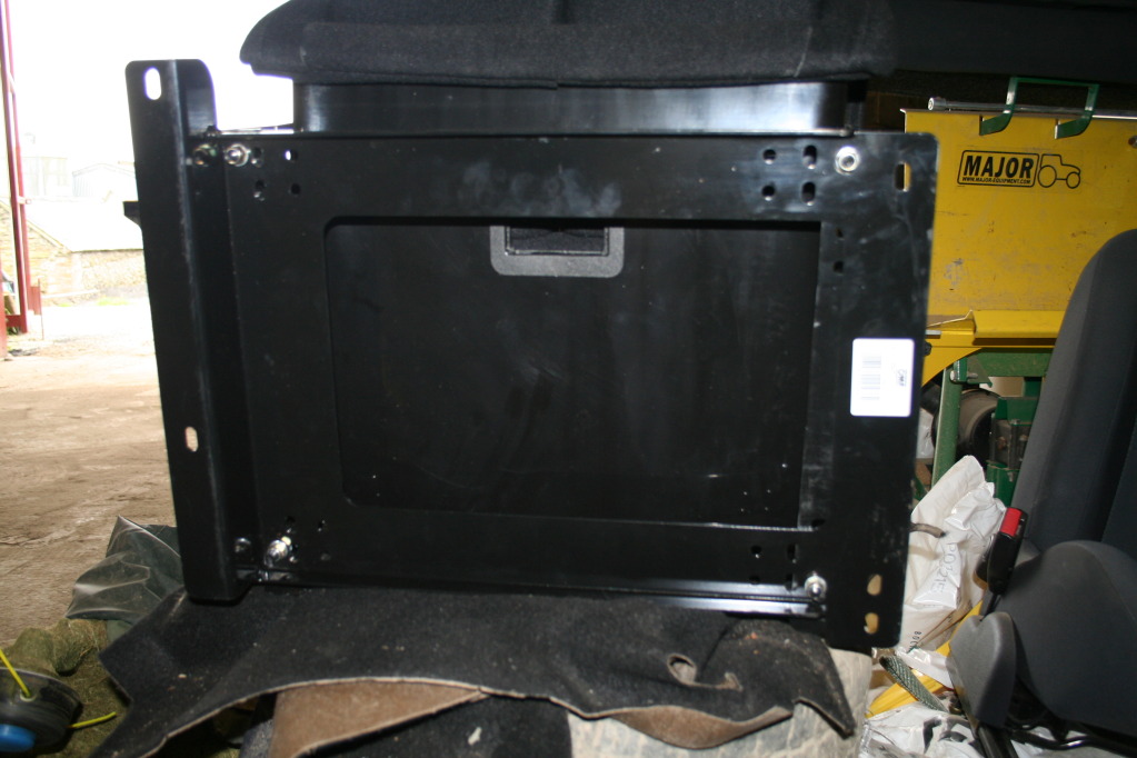

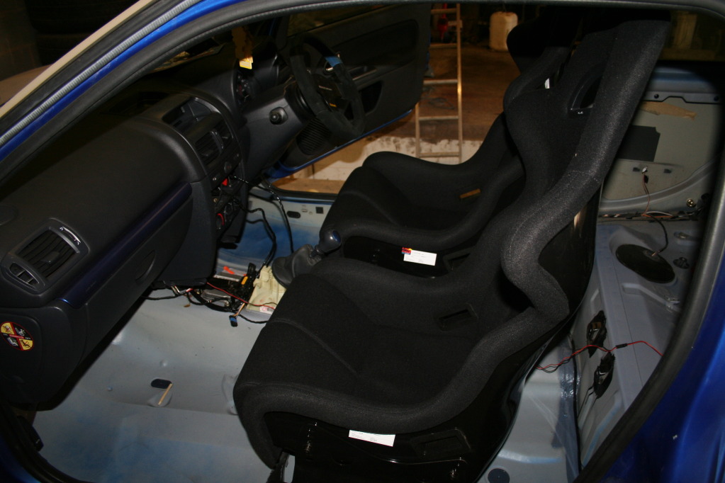

Update time - Popped to Demon Tweeks yesterday to get some OMP subframes and sidemounts.

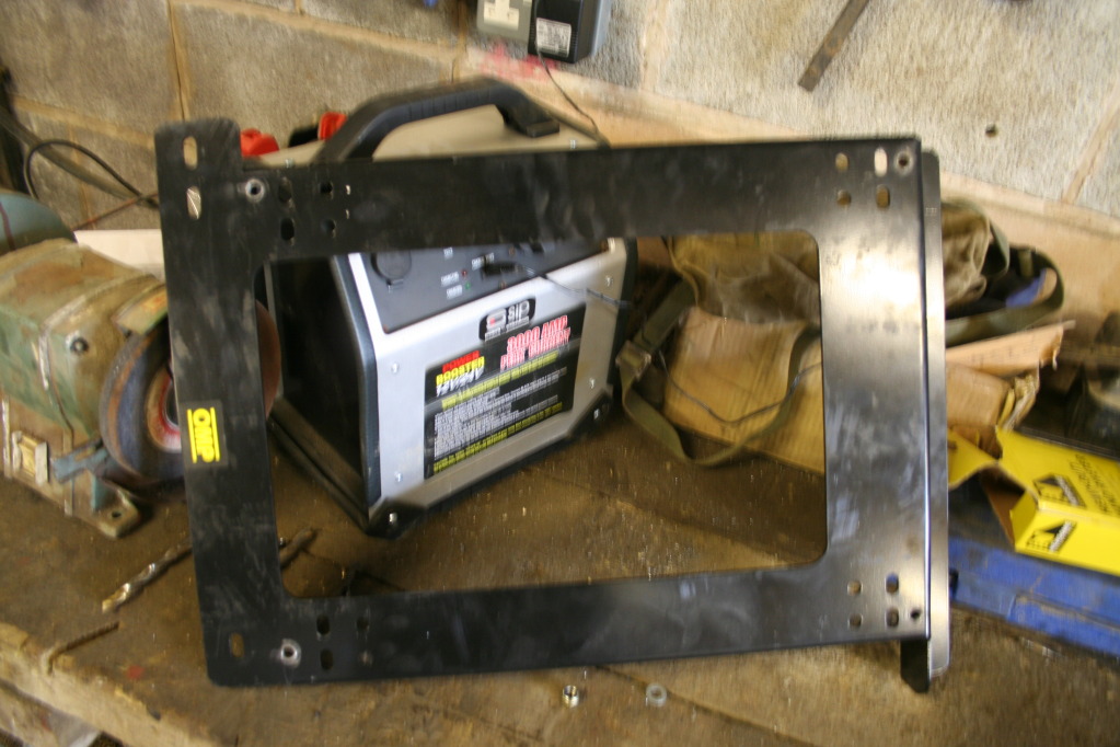

Fitted them today,only to find the sidemounts didnt match up to the holes on the subframes.
So I marked them all up and drilled new ones.
Bolted them on to the seats - Fitted perfectly
To deal with the subfarmes sitting slightly lower on the handbrake side, I used the old rubber covers that were on the old seat frame, seen below -
They now sit perfect .............
I am considering drilling extra holes on the back of the sidemounts so I can get them to sit slightly lower.

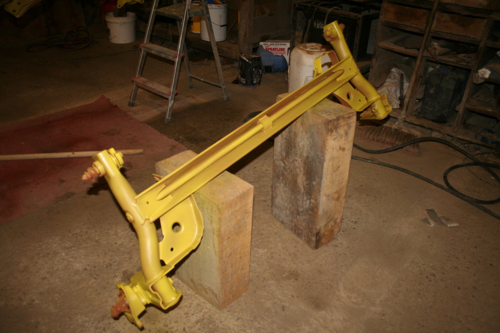

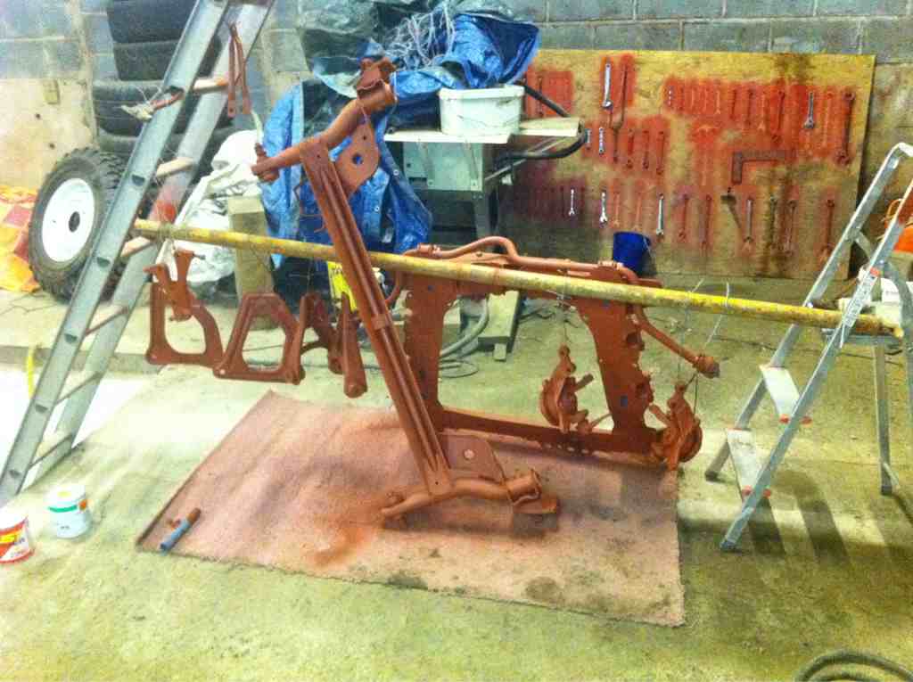

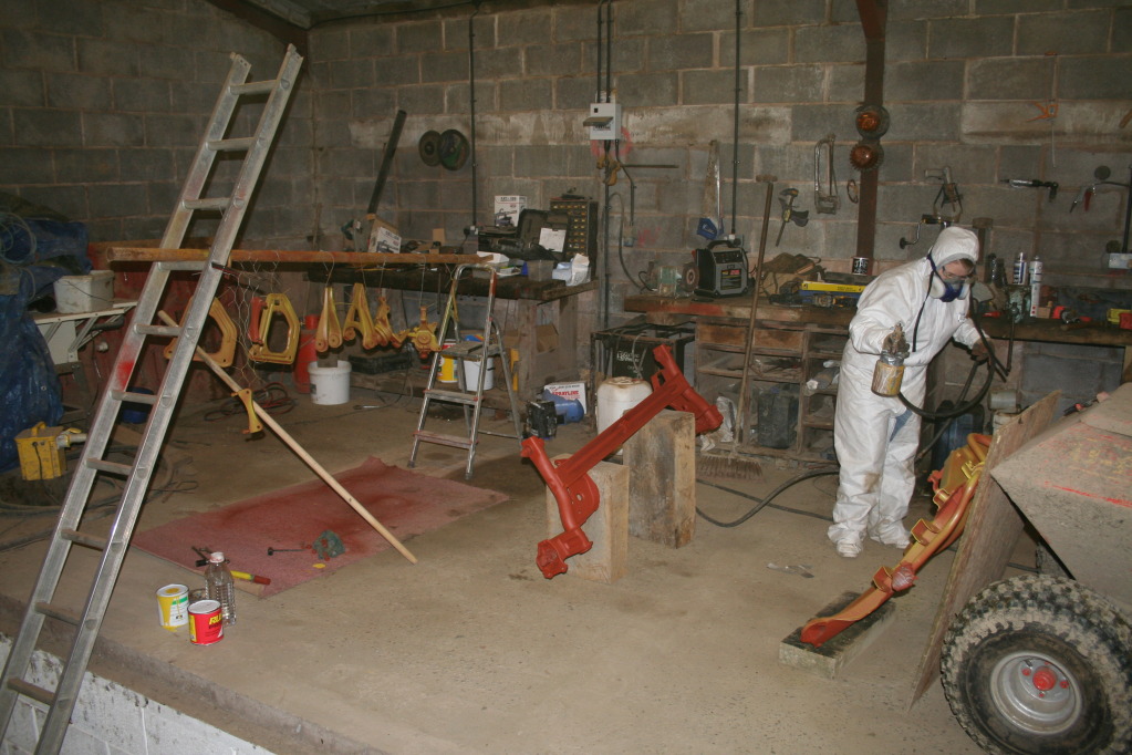

Got the parts back from the sandblaster today.... Gave it another coat of primer before I put the yellow on this week. Well the Mrs did the spraying... She is amazing at it! Lol.
I'll take better photos when I get it all finished :)

I had a right nightmare trying to get a happy medium with my Bimarco seat on omp frames, took hours, good luck
  172 cup RS2 - 330ci
Yeah they are not ideal!!! They could
make them better I'm sure! They feel ok at the moment. But need to sit slightly lower, more drilling I'm afraid! They should really make these more adjustable out of the box!

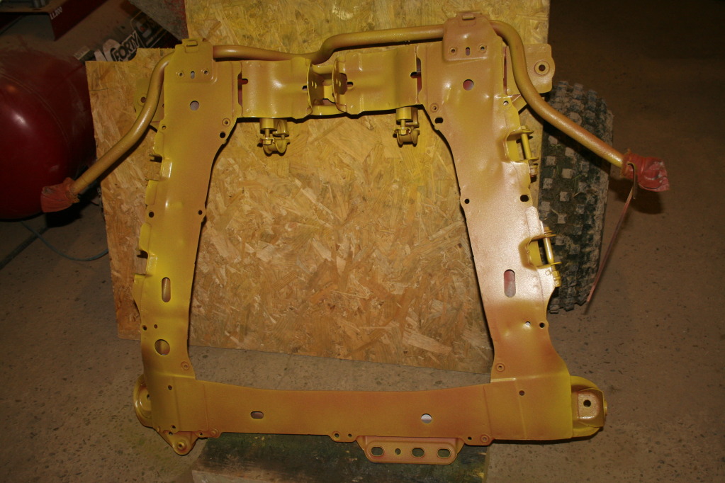

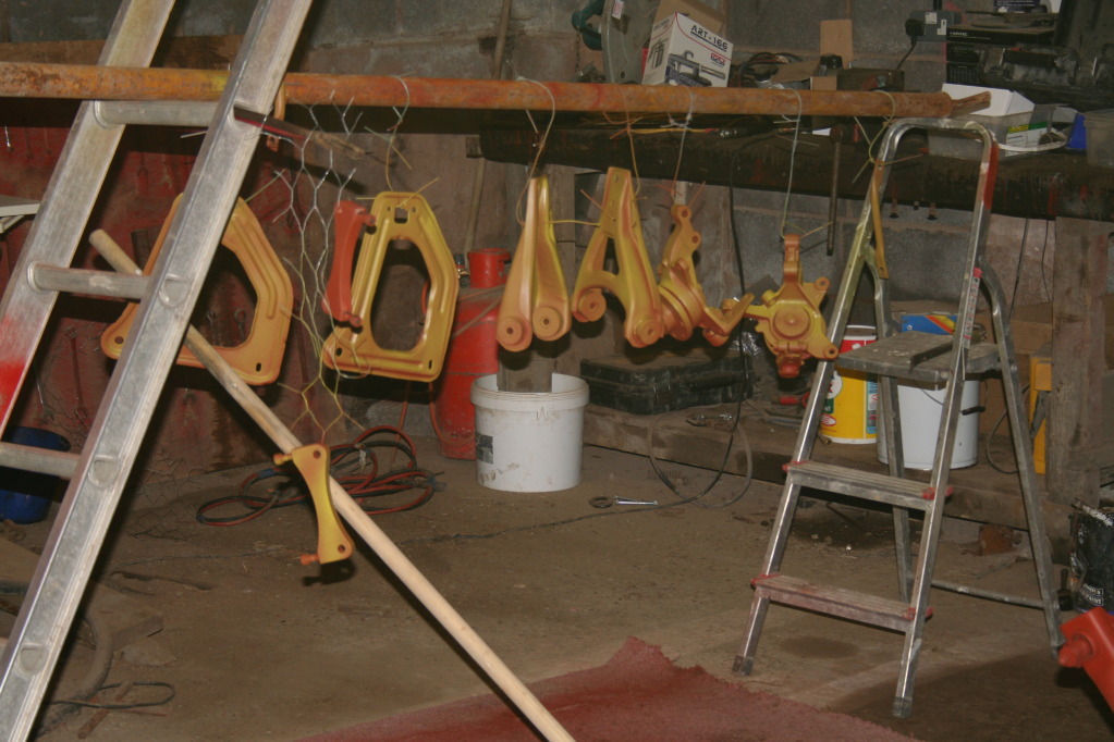

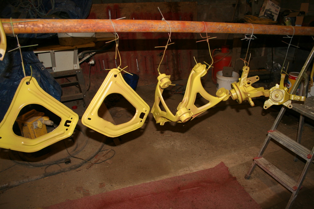

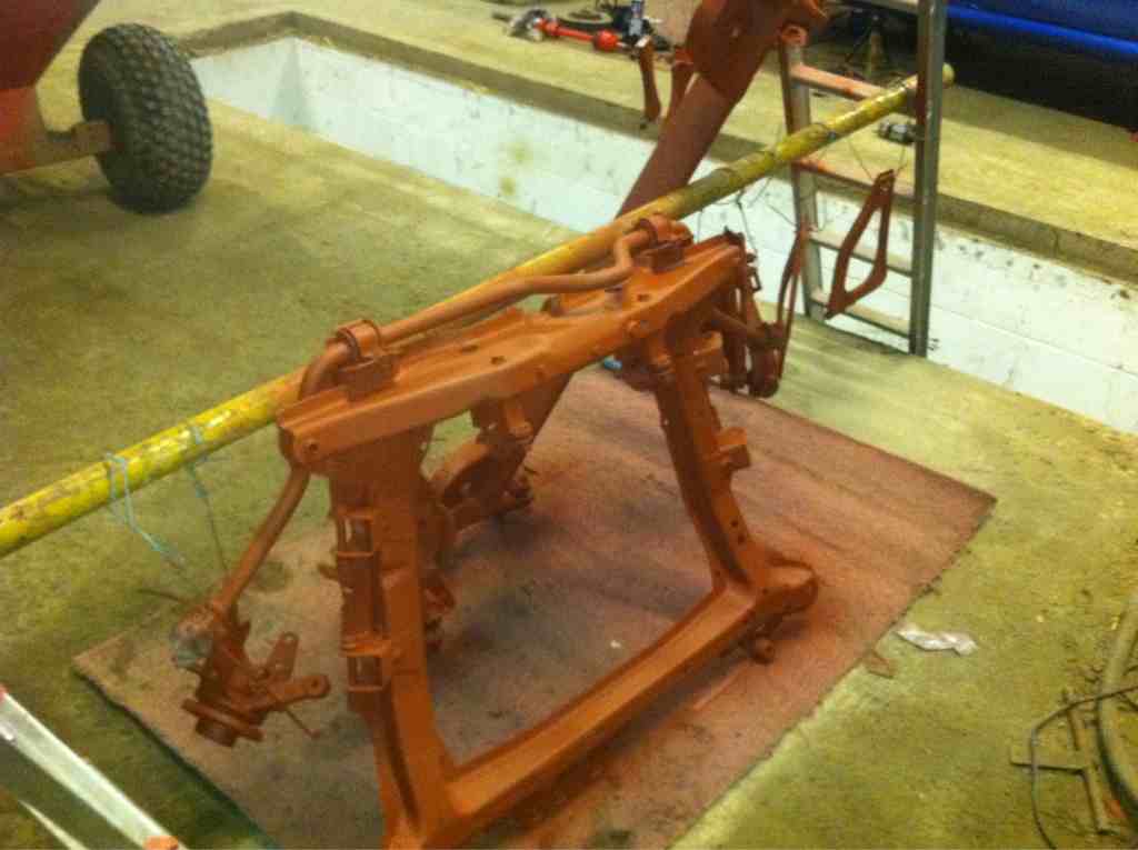

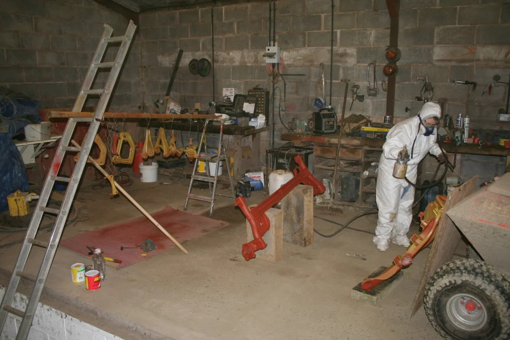

Update on spraying - First Yellow coat applied last night. It will need about 3 - 4 coats to finish off. You can see the proposed finished colour on the bottom picture. They are really starting to take shape now.....................
  172 cup, Impreza P1
Why don't you disconnect the ARB from he sub frame for spraying.
Looking good by the way and how handy is that to have a spray painter for a girlfriend!
  340i
Just what I was thinking!? Strange one that.
Perfect time to replace the bushes too.
  172 cup RS2 - 330ci
Been thinking of pulling it off to be honest. I don't want to put too much spray incase I can't get the powerflex bushes back on! Yeah she is really good at it! I think it will look good when done :)

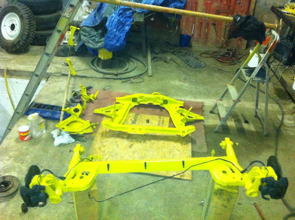

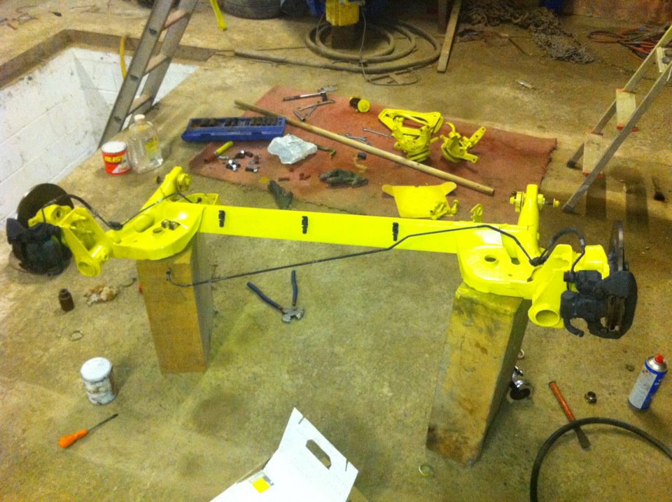

Rear axle built up and ready to be refitted :cool:. Cleaned up the calipers and sprayed them with black VHT. Also put new disks, bearings and pads on at the same time. Thanks to Tom from Wests :D.
I also rebuilt the subframe up ready for fitting.
  172 cup RS2 - 330ci
Subframe fitted last night, wasnt as bad as I thought it would be! It's all coming back together now :approve: plus Bilstein have confirmed that my front shocks are on the way back! At last! lol. Plus I have ordered 20mm H & R hubcentric spacers from larkspeed to widen the front a little. Hopefully everything will be back on by next Wednesday, I will need a geo set up in tweeks to get everything aligned and add some camber up front :evil:

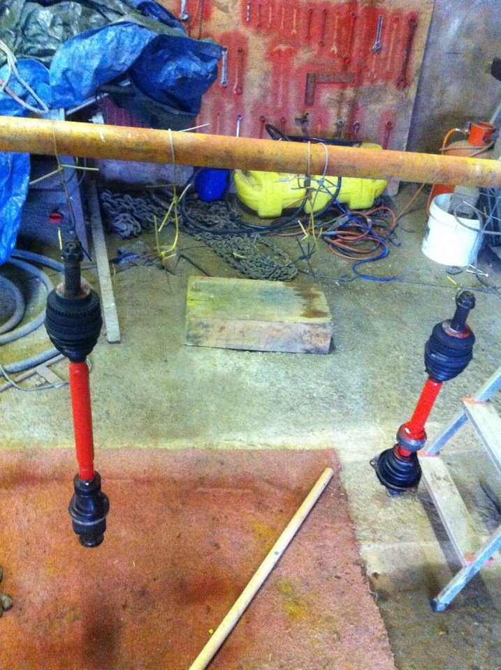

Stripped apart the driveshafts yesteday, cleaned them all up and fitted new cv boots. Also sprayed them red to match the rocker cover.
