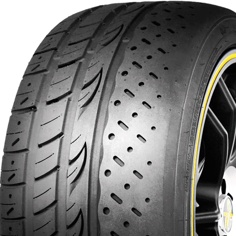

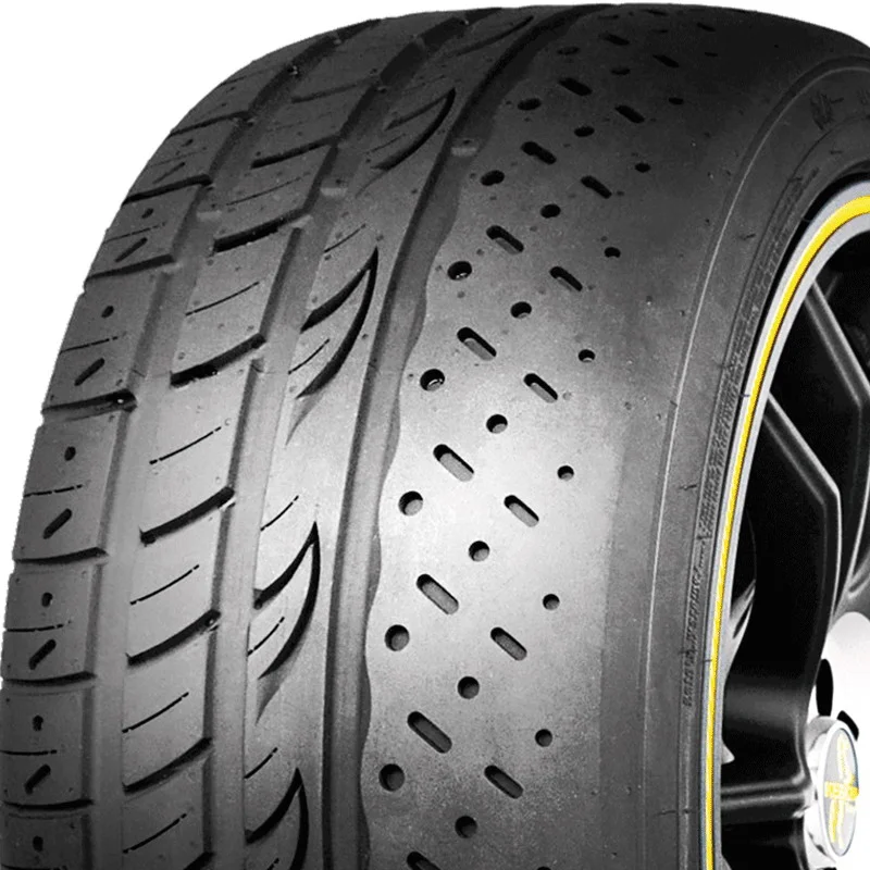

Nah twos :)
I haven't used them yet, on my mates 172 they where awesome

They look exactly like the syron street race tyres. After a quick google there is no new syron street race 2 tyre
imprezaworks
  Mk5 Golf GTI :)
Double check lol. You rate them then. I looked into them a while back but there wasn't much feedback
.Joe
For me the syrons were quite predictable, warm up very quickly, they're a medium soft compound, you could feel when they were coming to their limit so that you don't kill them off too quickly, they were a step gap up to ad08r's for the price on a 16" wheel i couldn't say no. they're very capable in the wet, dealt with standing water fine. iirc they only had 6.5mm of tread new but i got 5 days out of them and still had 3-4mm left. i ordered them from pneus tyres and got them next day, for a track tyre on the cheap i'd definitely recommend them and will be getting some for my next set.
imprezaworks
  Mk5 Golf GTI :)
Cheers. They are the origional ones, was never a 2 iirc. And what size dos you get, couldn't see 205/45 listed.
They only do them in 195.
