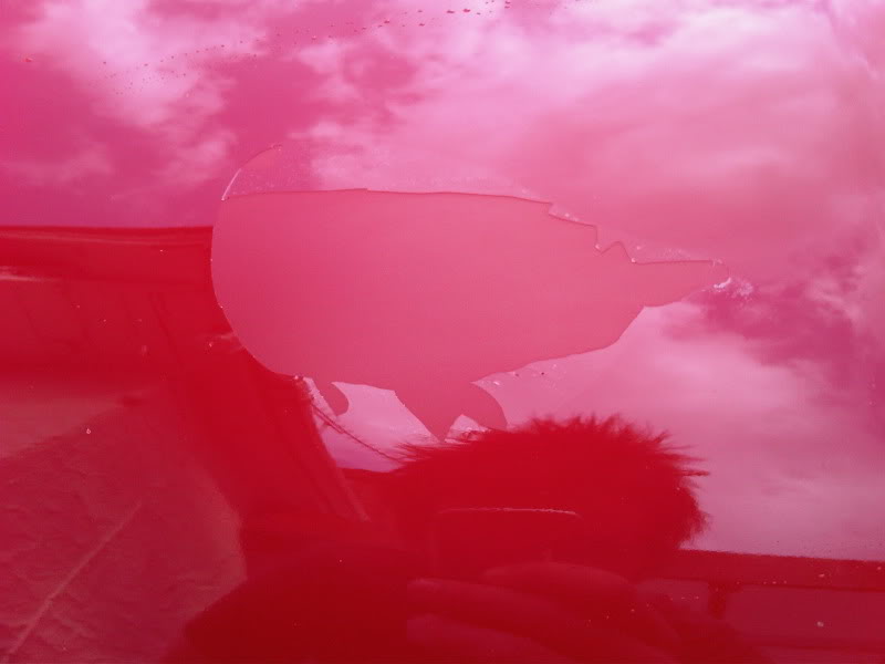

I was just jet washing the bugs off the front of the Trophy.. Sprayed over a stone chip. BANG.
A big peice of (lacquer?) flew off, leaving a matt red finish underneath it.
Wtf has happened and what can I do??
Absolutely gutted. :mad:
Thanks.

bloody hell! it'll need flatting and respraying. heard the warnings, but never seen it - blown a great patch of it away:dead:. was it a particularly powerful washer?

fuuuuck im not going too close with my jet wash ever again!! bad luck dude, looks like its going to need a respray though :(

this happens when the basecoat is left to long before the laquer is sprayed on ... we call it " shelling off " at our place as its like an egg shell coming off a boiled egg lol .... . as above its a respray job unfortunately

Just been down to the body shop. He said when theres been a front end respray in the past (previous owner), the paint on the bonnet has dried quicker than the bumper (metal vs plastic).
So the bumper looks fine but the bonnet is fucked. All needs stripping off because the paint is quite thick, too much to flat down and blend in. Respray.
Tyres will have to wait. Deep joy.

As i said, too thick to blend properly.
Few hundred to strip down completely and respray. I don't trust these quick repair places... theres only one guy i trust with paint.. he does things properly.
